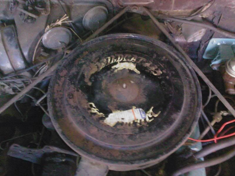

  14. BloodyKnuckles
    Joined: Apr 9, 2005
    Posts: 2,915
    BloodyKnuckles
    Alright gents!
    As requested here are ****ty pics of the donor;
    My good buddy Animal delivered it today. Jeffery James and myself screwed around and looked at everything. It came with a new water pump, NOS tail light lenses, a good marine gas tank (metal), new battery cables, new brakes and master cylinder, power everything including seats.
    It has so much I can use on the Skylark. The engine, the posi rear that's about 60" wide and big as ****, the front finned drums and a ton of other ****.
    I am very happy with my purchase and can't wait to get started. Before I do anything I will get the engine running and drive the car.
