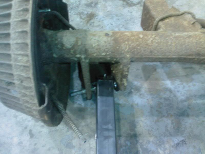

    Well, I got both links built and I have one link sleeved every 6"s. What a *****!
    Here's a pic before I sleeved it;
    I should have more tonight.
    ******Knuckles

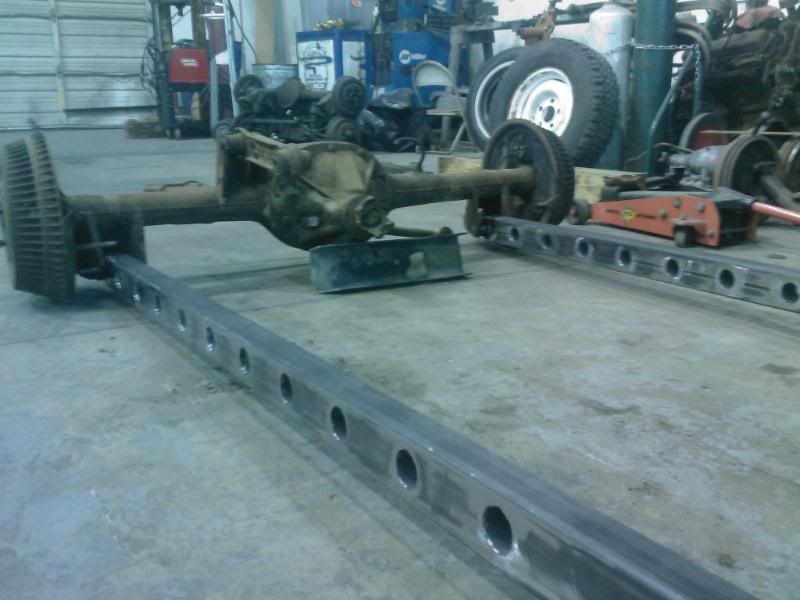

    It's been a productive day. I got both of the links done. Remond me to never sleeve something again, what a *****.
    Here are a few pics;
    More tomorrow! Stay tuned!
    ******Knuckles

    WOW MAN! Good Job Hoss. Hit that rear with a wire cup brush and paint her up! Looks like you cut the holes with plasma - what did you use for a guide?

    holy hell those bars are long..haha but on a serious note..I've used those joints in the past..make sure when you articulate they don't bottom out and bind...You're already at an extreme angle to start. Other than that, I can't wait to see how this comes along...

    Thanks for your concern. I am real familiar with these joints as I used them for years in an OT vehicle. The joints were all the way maxed in that pic but now bolted to the car there is plenty of room to move.
    Thanks again for pointing it out.

    I started with sliding the axle under the car again and bolting up the wheels. Then I hooked the links up to see where they are going to mount to the body. I made brackets for the links and used 4 factory sleeved holes in the unibody and bolted them in place. Then I made the upper link brace and brackets. I used the factory location for the original upper links and bolted my new bracket into 6 sleeved holes. The fullsize Electra axle fits perfect under the Skylark:cool:.
    Here is where I'm at now;
    What my plans are for tomorrow is to finish welding my upper link brace, finnish the lower link holes and finish the frame end, locate the panhard bar and we'll see how much else I could get done.
