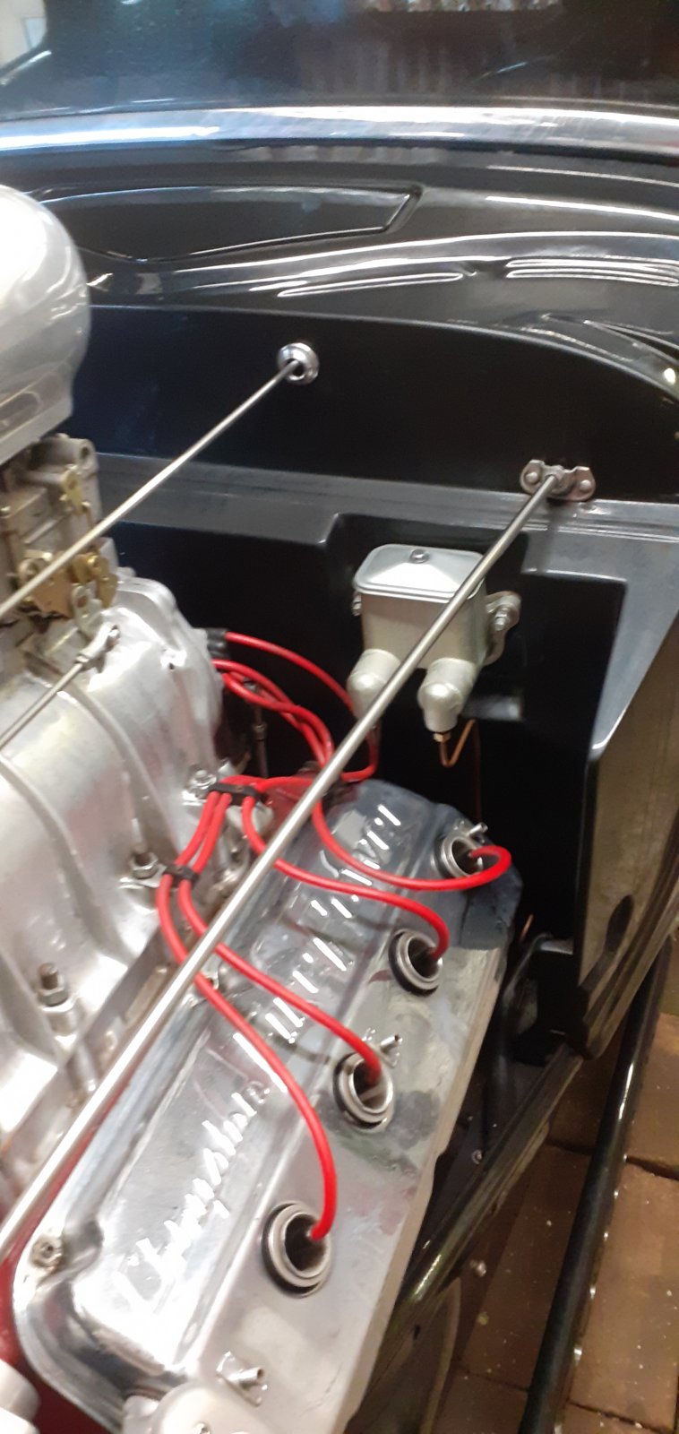

    images.jpeg-1.jpg I have a Chevy pickup master cylinder as pictured firewall mounted it was 1 1/8" on both bores which gave me a very heavy clutch and brake pedal. I have had it sleeved down to 15/16" on the brake side and 7/8"" on the clutch.I now have great clutch control and great brakes (rear drums front discs). When I refitted it I decided to put a 2lb residual valve the front brake line (also have a 10lb one in the rear line) I have noticed a bit of drag on the front brakes, can push the car but not as easy as before. Thinking about removing the 2lb valve?

    Your MC is below the front caliper level? What style front calipers?

    No residuals required as fluid cannot flow back into the reservoirs as would be the case under the floor.
