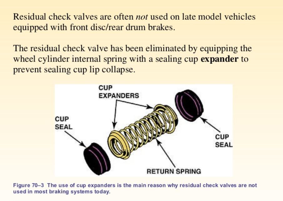

    You learn something new every day! Now, about when did they start upgrading the wheel cylinders to having the expansion cups? I'm ***uming the Early Ford juice brake cylinders don't have these...

    Well, actually... they were advertising them in the fifties - FORD began using them around 1972. I am a FORD FREAK so am not as keen/interested on the rest of the industry. That one (internal RPV in single piston MC) went completely over my head.
    Now that all of this has come to a sudden thud as the OP describing having plumbed FRT DISC and REAR DRUM with an early style single piston MC and will the MC reservoir hold enough fluid to initiate the front calipers properly and will he need to top off the MC every week to keep up with pad wear?
    Like you say, learn something new everyday.
