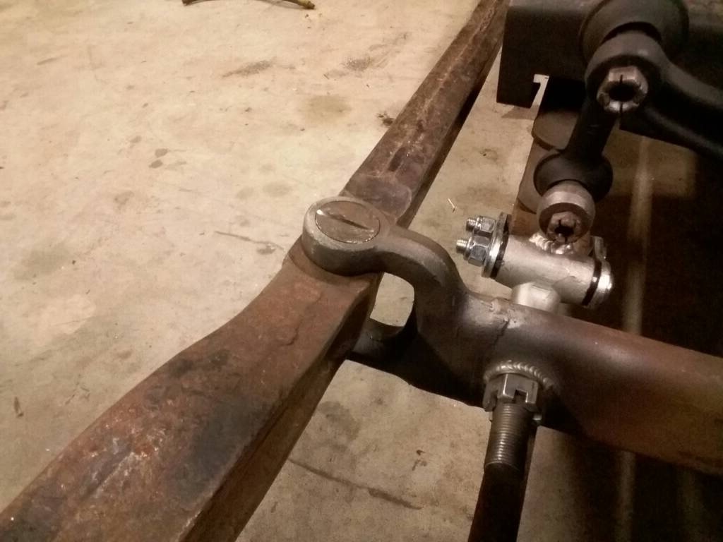

    [​IMG] from facebook. Broken spring perch bolt. Said it had multiple cracks in it
    Stogy and loudbang like this.

    Now I want to know who made that one because it looks awfully similar to the speedway ones I have on my cars..

    Ah youre right. Forgot that it was a suicide front axle setup. All the weight of the front rests on those two bolts..

  11. At least in my head- The load forces are very different from stock. The perch bolts look aftermarket-new and not Henry's stuff.

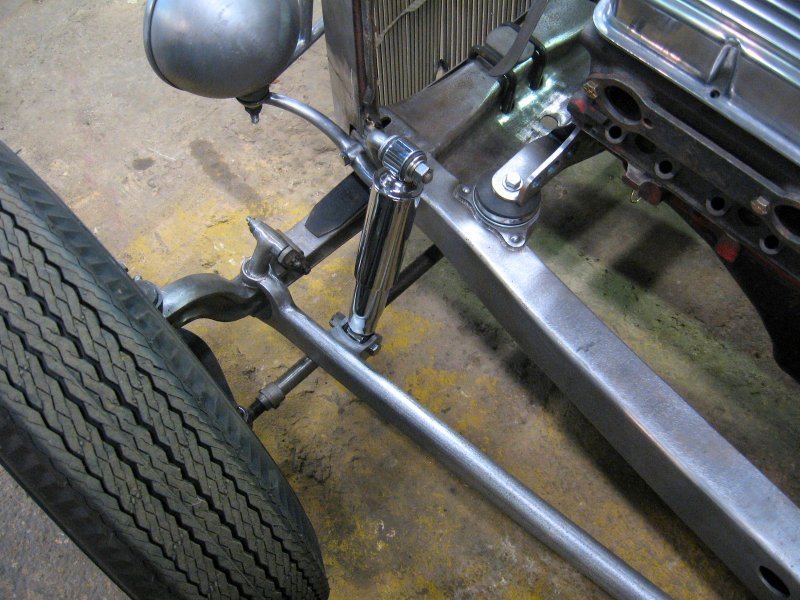

  14. Yep!!

    The stock perch and nut have a taper, we don't know what the wishbone mounted setup had, was there a nice radius or sharp 90% end on the sholder. Bob

  18. Shear load on a Compression load part caused this.

    A bit of extra insurance, however, even with the perch welded to the wishbone, if the perch failed and sheared where this one did, it would have probably torn through the weld and still come crashing down.
    I'm with thirty two, on the shear load perch design looking cool but my gut doesn't trust it like the stock load design.
    I feel the same way about underslung suspensions: they look trick but I don't trust the design where the entire weight of the car is pulling down/hanging on the leaf spring U bolt nuts.

    It is easy to do Monday Morning Quarterbacking - so I'll take a stab at it. First of all, the original Henry design of having the perch pin vertical (well almost), puts a completely different load on the pin than having it horizontally mounted in a shear condition. The shear load on the pin is completely different . . . the whole weight of the front of the car wants to bend/break it off. So - even with forged parts - I'd be very suspect of this design. Does it make the car very low . . . and look cool . . . sure . . . but is it also a potentially dangerous application of components that are not designed to take the loads they are now under? I think the failure gives us a very good example of how changing a design (using the same parts) - can create a situation that we did not account for. In this case, a quite dangerous one.
    Secondly, the particular perch bolt that I see . . . sure looks cast to me??? Maybe I'm just seeing things . . . but it does have that "look". So -- now you take a potentially inferior part (from a materials and strength perspective) - and put extreme shear loads on it - then it breaks. Also, consider that this car has very few miles on it - imagine how over time . . . that the potential for the perch bolt failure could have increased (even with a forged component). Thank God he was not clipping down an interstate at 90 mph . . . he may not have made it out of that one.
    I'd love to do a finite element ****ysis (3D CAD engineering ****ysis software) of the original Henry design . . . versus this "in shear" mode . . . I bet the FEA model would show one Hell of a lot of RED on the horizontal perch bolt.
