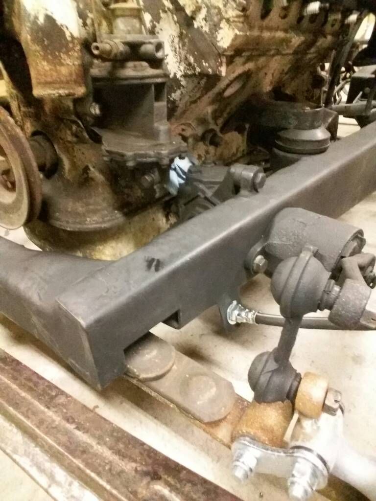

You make some really valid points and I've been looking at some pics. I can't help but wondering what is up with what I'm about to point out and if this played a part in the failure. First this is from 3w Larry's build frame by the RB with The well pounded history ,,, Take a look specificaly at the distance from the spring to the frame within the notch. It's close and pretty tight but it looks like it's about 2-1/2". The notch seems to be well into the upper 1/2 of the rail. Looks like a slight dip 32 front crossmember as well. Now there's been talk of just plain rough and rough as **** and washboard roads and salt. So look at the next pics of bens car in that same area. The space is greatly reduced compared to that above, the notch isn't as deep and looks like a flat model A crossmember and could have easily been bottoming the spring. A few good pounds could easily have broken that part. Blow them up, zoom in.
Not much room true but the proof would be if there are marks on the spring and frame from repeated contact. I'm sure Ben is going over every inch of the whole car and already has a list started of what he plans to change or improve.
Well now...thats interesting for sure! Hadn't noticed that. I'd be all over those springs looking for witness marks, and even if I found none, I would definately be opening up the slot to allow more suspension movement. Everyone writes the Bones cars off as using the same front suspension design as Doane Spencers car but its really a completely different layout, just that the spring is about the same place and a stock axle is used. Interestingly, Doanes car had a Zee'd frame modification but all the cars sit about the same height. That would SEEM to suggest a spring with more arch on Doanes car and potentially more spring clearance at the frame. The RB layout looks fine to me, but I think you spotted the particular little glitch that started the whole thing off on this version. Even if it turns out not to be...it's something that needs critical attention on any build. Good eye!
Most of the "Bones" style cars use their perches in a upswept fashion. Coupled with a model A or flat crossmember, these cars are very low in front for a non-dropped axle. I used the stock 32 crossmember(narrowed for the pinch, like Doane) with my 32 perches sweeping or drooping downward to get low while still keeping the spring closer to stock frame clearance. This way I didn't have to notch my frame for spring clearance since I don't care for the look. I did a minimum notch for where the axle rises with some boxed frame portion that I feel will catch the axle in a spring failure that also more cleanly blends to the grill shell This post is for comparison use not to condemn others approaches. Sent from my iPhone using The H.A.M.B. mobile app

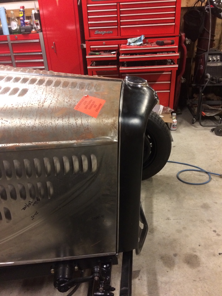

Guys Ben's car had this piece of flat stock above the axle to support the radiator as all "bones" style ch***is or most any way do. Yes it is hidden by the grill shell. Wyatt Sent from my iPhone using H.A.M.B.
Well if it was there I guess Torana 68 was right about it working after all. I guess I am wondering why something like this wouldn't work?
Probably did one thing but not the other and under those cir***stances it did not keep it on the road as evidenced.
