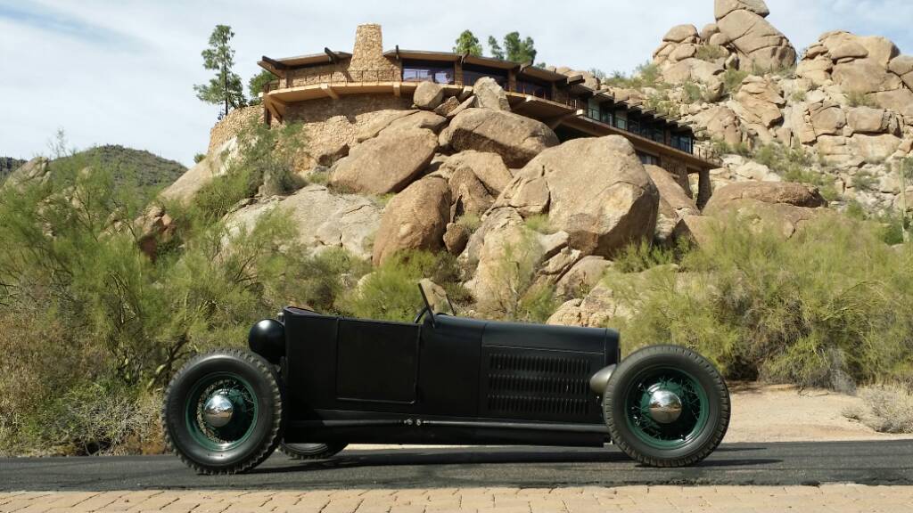

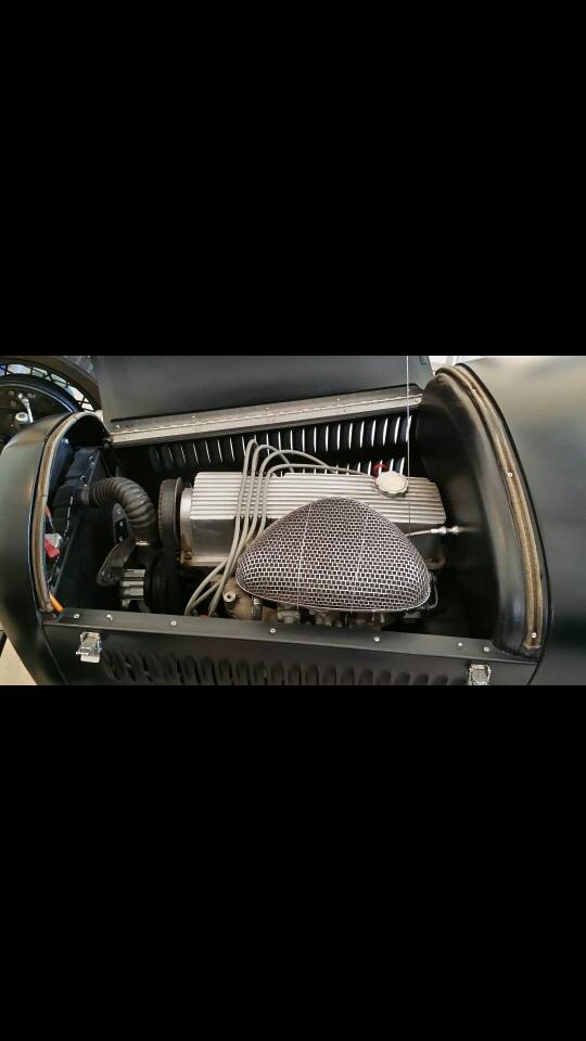

  21. no55mad

    Hey on a side note, is that motor stock, what trans are you running and how does it perform with the weight of the car.....also hows the gas mileage.
    I'm building a '28 Ford Tudor with a 2.0, T-5, header, Esslinger big valve head and a modified stock intake with a Holley 350 2bbl. I was wondering what to expect from it power, driving and mpg wise.
    Thanks
    modified likes this.

  26. modified
    Joined: Sep 21, 2006
    Posts: 326
    modified
    Yes, my engine is stock and has plenty of power for such a light car. It certainly is not a tire burner but chirps the tires when the C4 grabs 2nd. It gets 25 mpg.
    Sent from my SM-N900V using The H.A.M.B. mobile app
