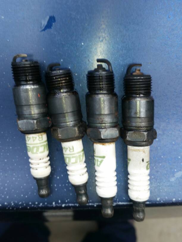

    Not sure why so many people think a fuel pump is the only reason for gas dilution in the crankcase? It could also be caused more often by too rich carburetion scenario. I'd be pulling the plugs to see if they are burning black and sooty. Or if the heavy rich smell is out the tailpipe also. May be your carburetion is having issues, or need a rebuild if they are pouring excess fuel down the cylinder walls.

    Pulled the plugs and this is what I have.

    ...aftering looking at the plugs the set on the left looks like there is 3 different heat range plugs,...this may not be your problem but it may cause other problems...miller

    Have you had a look at the plugs yet?

    I posted a pic of the plugs a few posts up.

    I was curious if you had looked at your new plugs to see how the mixture was.

    Ill try lighting it on fire and ill pull the plugs and look at them tomorrow morning. Ill post pics of the plugs after i pull them
