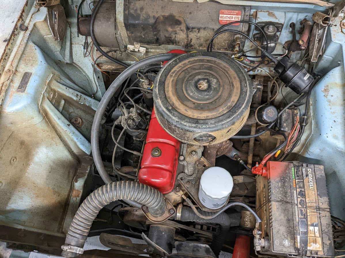

    I fill up the canister with oil, it doesn't seem to leak out around the bolt head. I've gone back to canisters on the two 60s engines I have, it's just so fun to relive the old days!
    But it's really a trick on the Rambler. That's a byp*** filter! not full flow. The holes in it are tiny. Easy to change without much spill.
