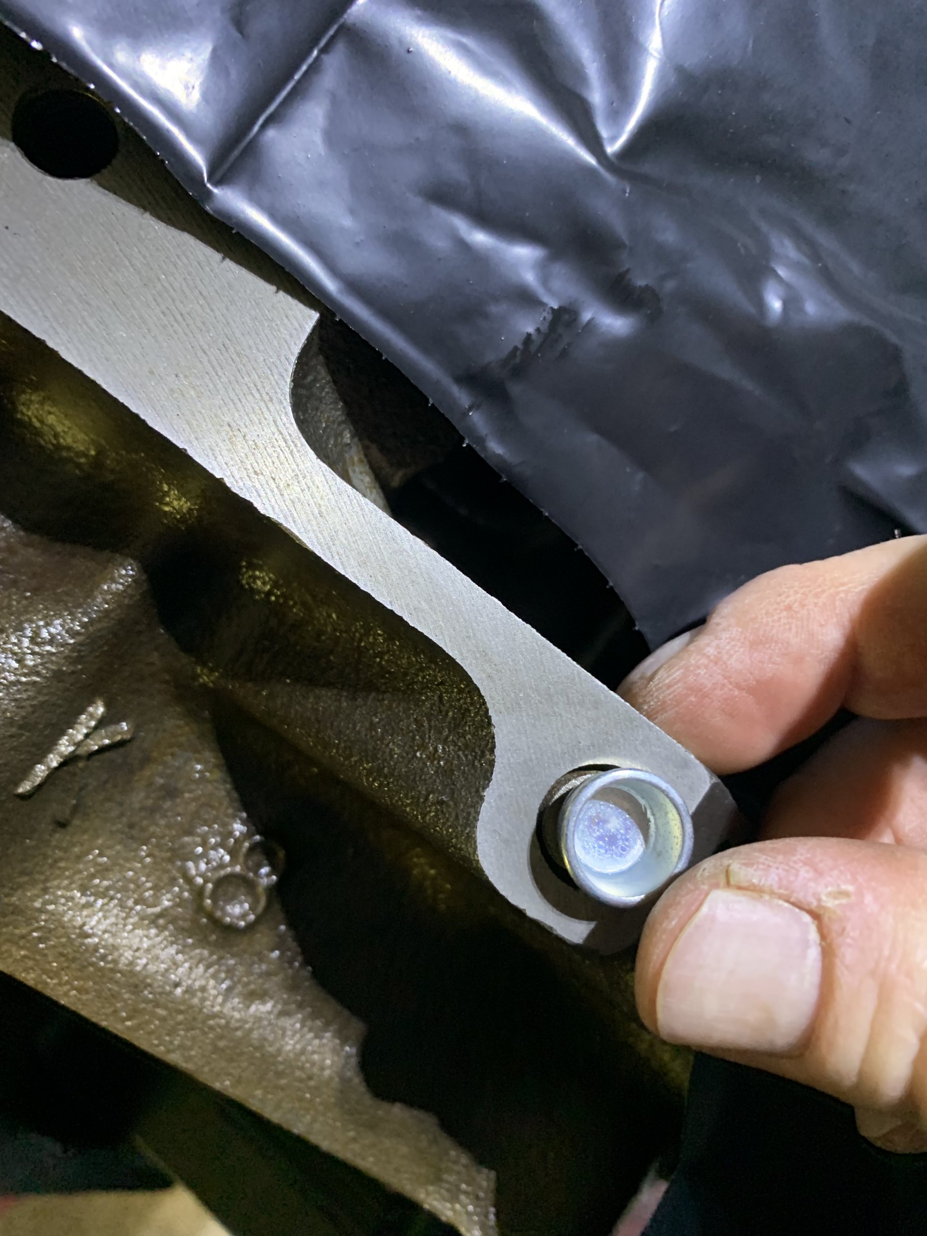

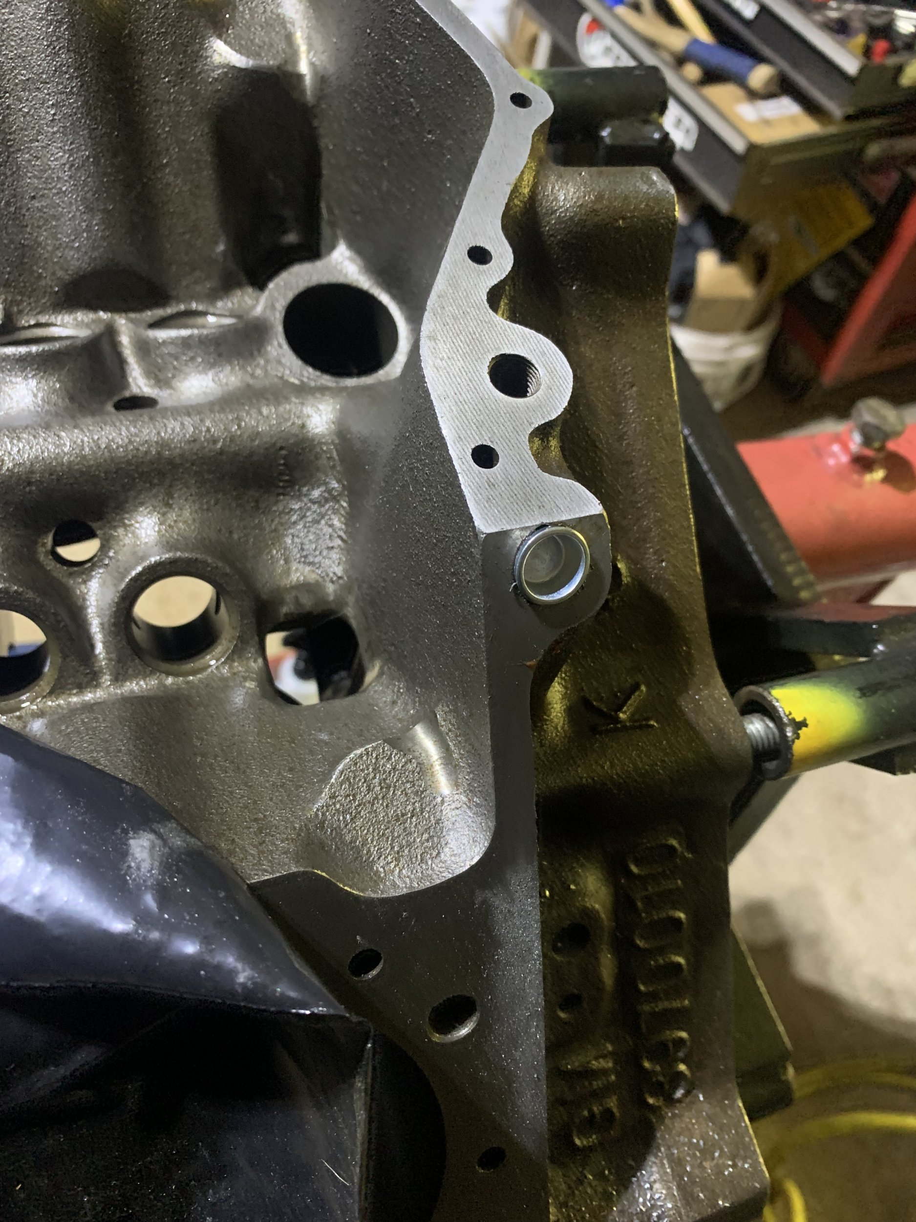

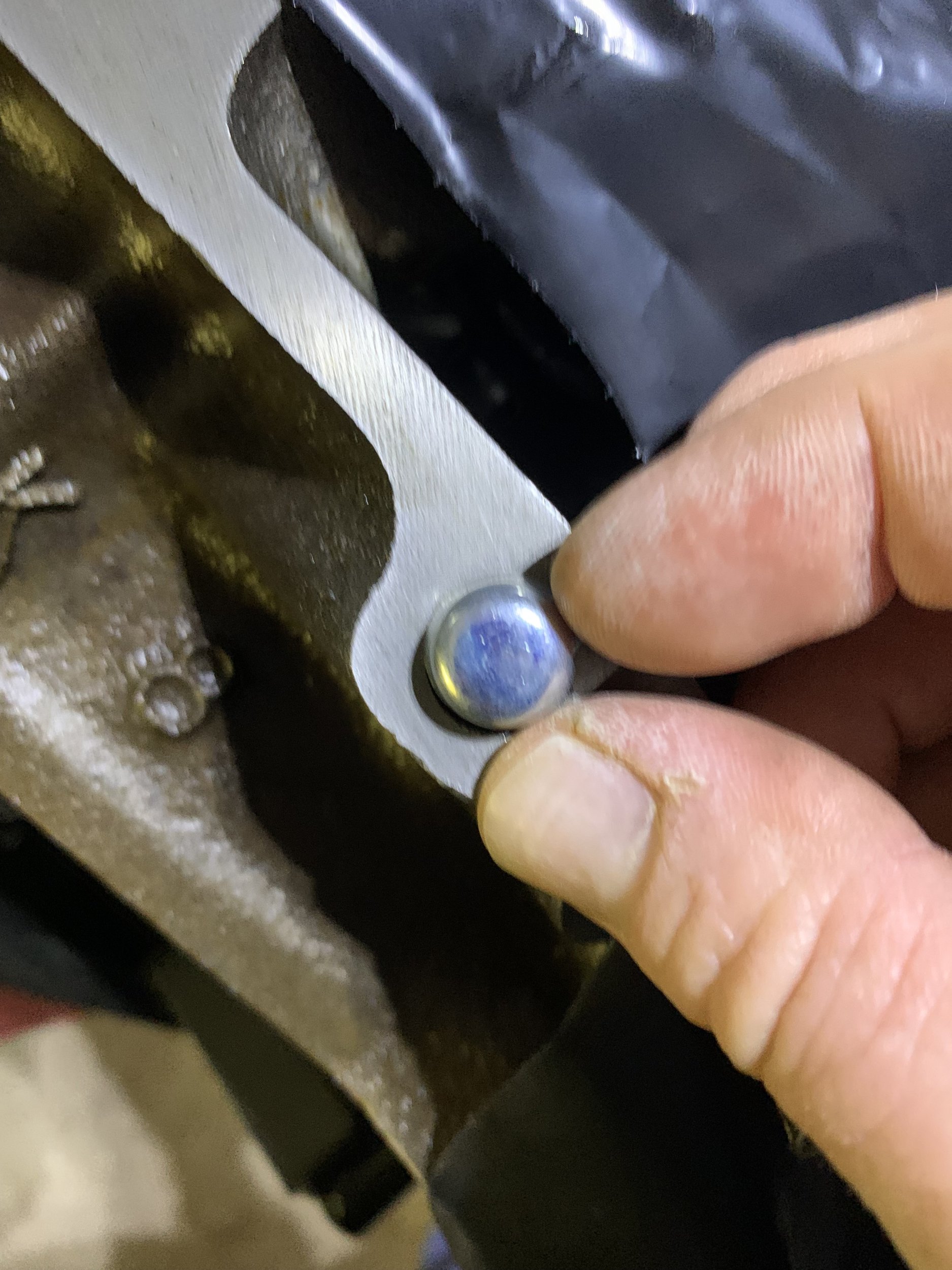

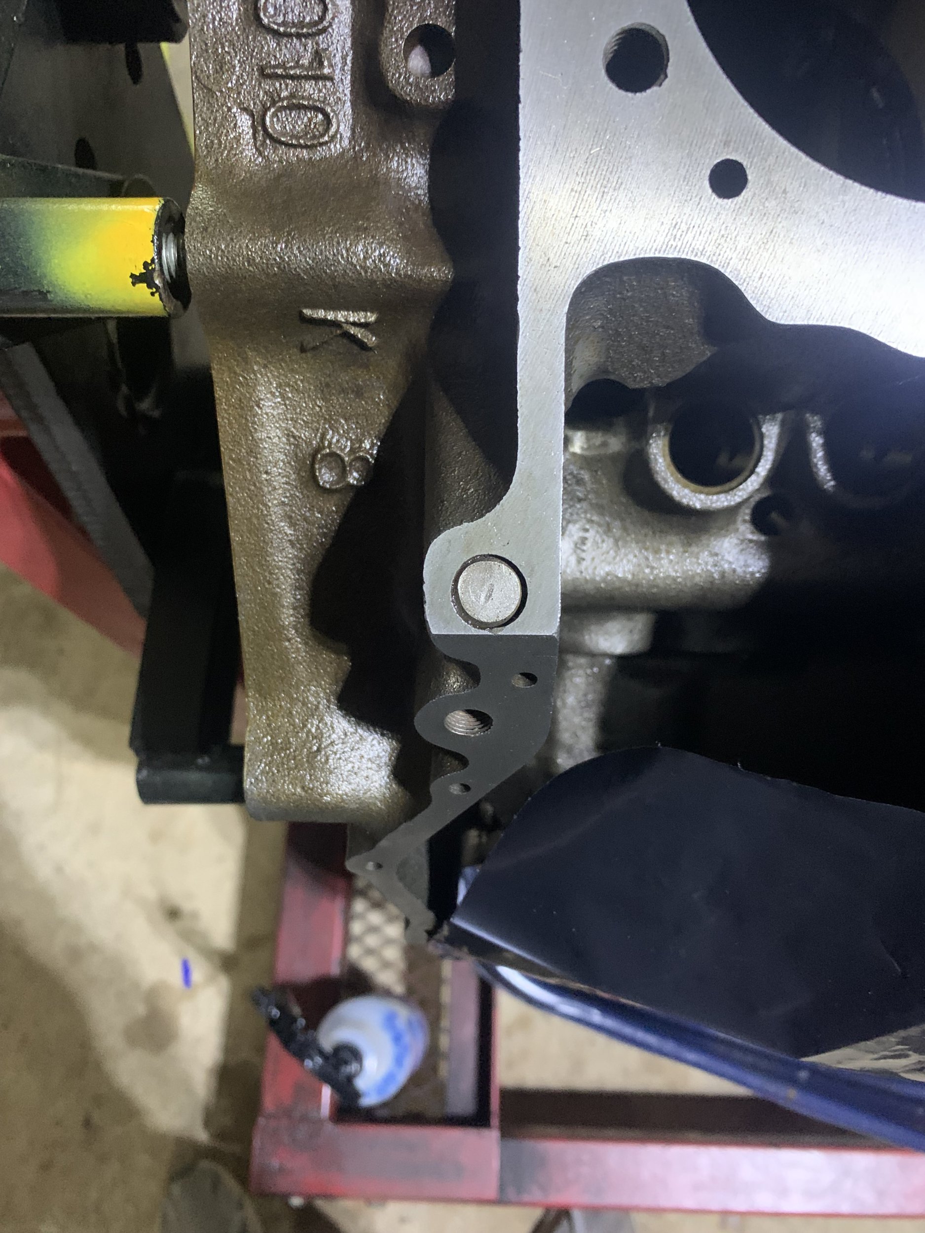

    Morning fellas,
    I got my SBC back from the machinist and did my first round of cleaning last night. The only plug that didn’t get removed from the block is the one that is on the odd (driver) side bank under the cylinder head. I have an earlier block so it is the solid slug that has to be removed by drilling, tapping, and a slide hammer. In what I have been researching, there really is not a direct replacement sold for this slug and the hole is an odd size that is to big for a 1/4” NPT plug and can’t be made bigger for a 3/8” NPT plug and there aren’t really any soft plugs that are the correct size. So….do I just leave the thing in there and take a chance (my feeble brain says not a good idea)? Does anyone have a viable solution for the replacement of this plug? Is my research wrong and I can tap this to 3/8”? Just looking for a little guidance, thanks! IMG_5546.jpeg IMG_5545.jpeg

    Lookup how much of a over size is required for press fit , it will be a few thousand bigger ,
    Or can fine thread tap ,sae or mec ,
    use hight temp
    Pipe Sealant ( loctie ) on threads
    Its just a hole drilled for oil galley p***age,, Press fit Plug or threaded
    About .010 below deck after installed
    Br*** or aluminum for press fit slug ,
    Also maybe race retainer Green

    Thanks Eddy. So you’re in agreement that I should remove it. I’ll keep looking to see what I can find to fit the diameter. It measured out at .515” inch. Just a complete oddball size, nearest expansion plug I can find is .540”. I’m going to measure up some bolts to see if I can’t make my own plug.

    .540 way to big , off top of head
    .517 .518 , There are charts for press fit,
    Another Ideal , maybe where plug
    ( Not sure off top head)
    if goes to main
    Maybe small rubber hose & vac

  7. pila38
    Joined: Mar 25, 2009
    Posts: 1,097
    pila38
    Thank you for the help gentlemen. Looks like regular old steel expansion plugs like you would use in the cam galley should fit. Just got some from the local parts store and it think they will do just fine. Sometimes reading about stuff and not working on it gets you in too much trouble. Hopefully, this will help someone like me in the future? IMG_5548.jpeg IMG_5547.jpeg

    that should/ would work ,
    Looks to be 1/4 deep wall/ pocket
    & Green loctie , install flush thoe,
    @ Deck height ,
    I wonder why not used originally,
    mad mikey and pila38 like this.

  10. pila38
    Posts: 1,097
    pila38

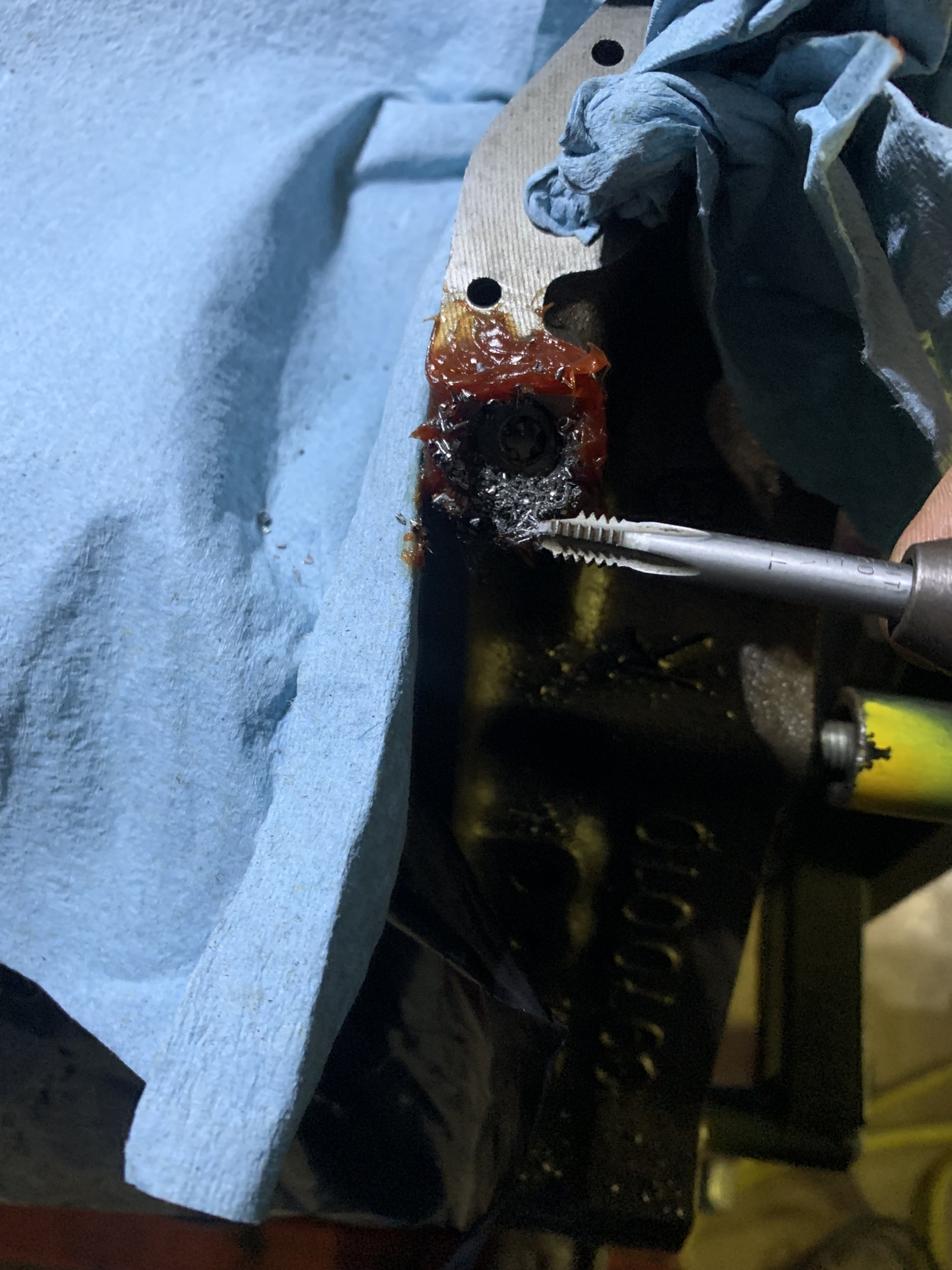

    Well…that was a miserable experience and I’m an idiot. But I’m going to share so that it has been do***ented that I am a *****.
    First: Put grease around the hole and on the drill bit so the chips stay somewhat contained

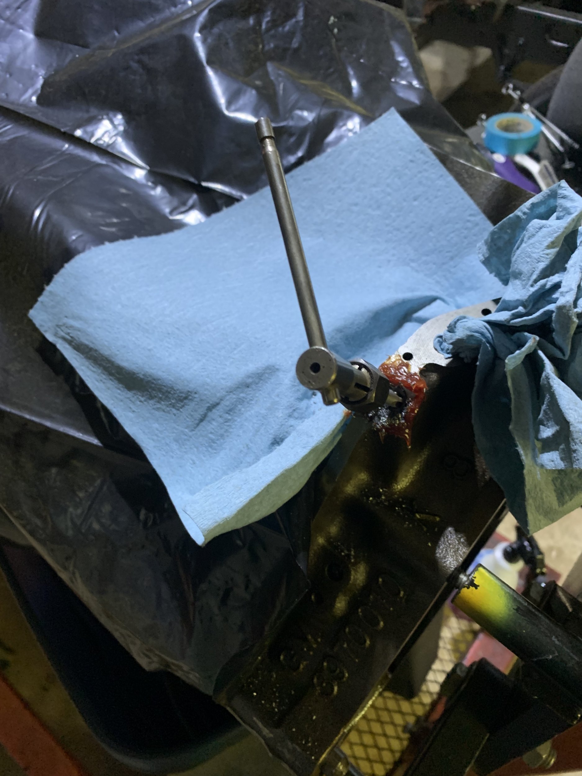

    Second: Tried to drill a 3/32” hole for a 1/4”-20 tap so I can rig up some kind of slide hammer to get this plug out. Learned quickly for the 764th time that my drill bits are the dullest in all the land. Proceed to grab Christmas tree bit. Success! (Kind of)
    Third: Begin to tap bottom of hole (since I used a step bit). Break tap off in hole. F@#$.
    Fourth: We are beyond trying to tap. Screw it…drill the ******* out. Spend lots of time because, again, drill bits are dull.

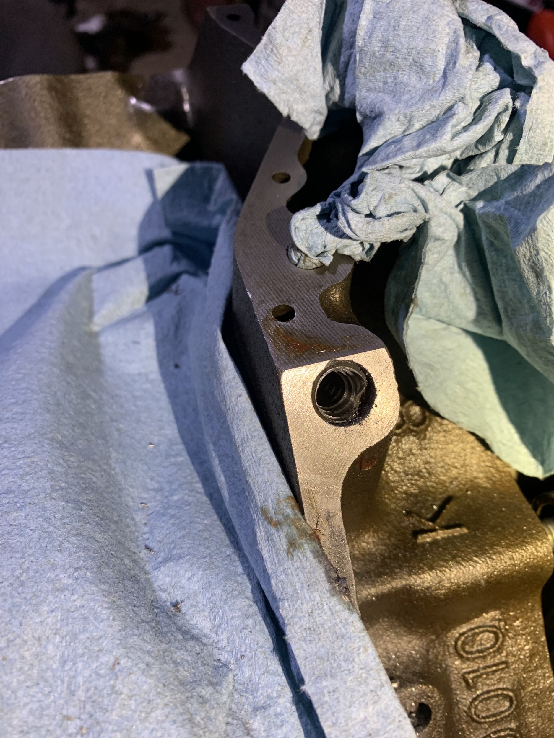

    Fifth: Got the walls of the plug thin enough to bend with a small flathead screwdriver. Now I can slide it out.

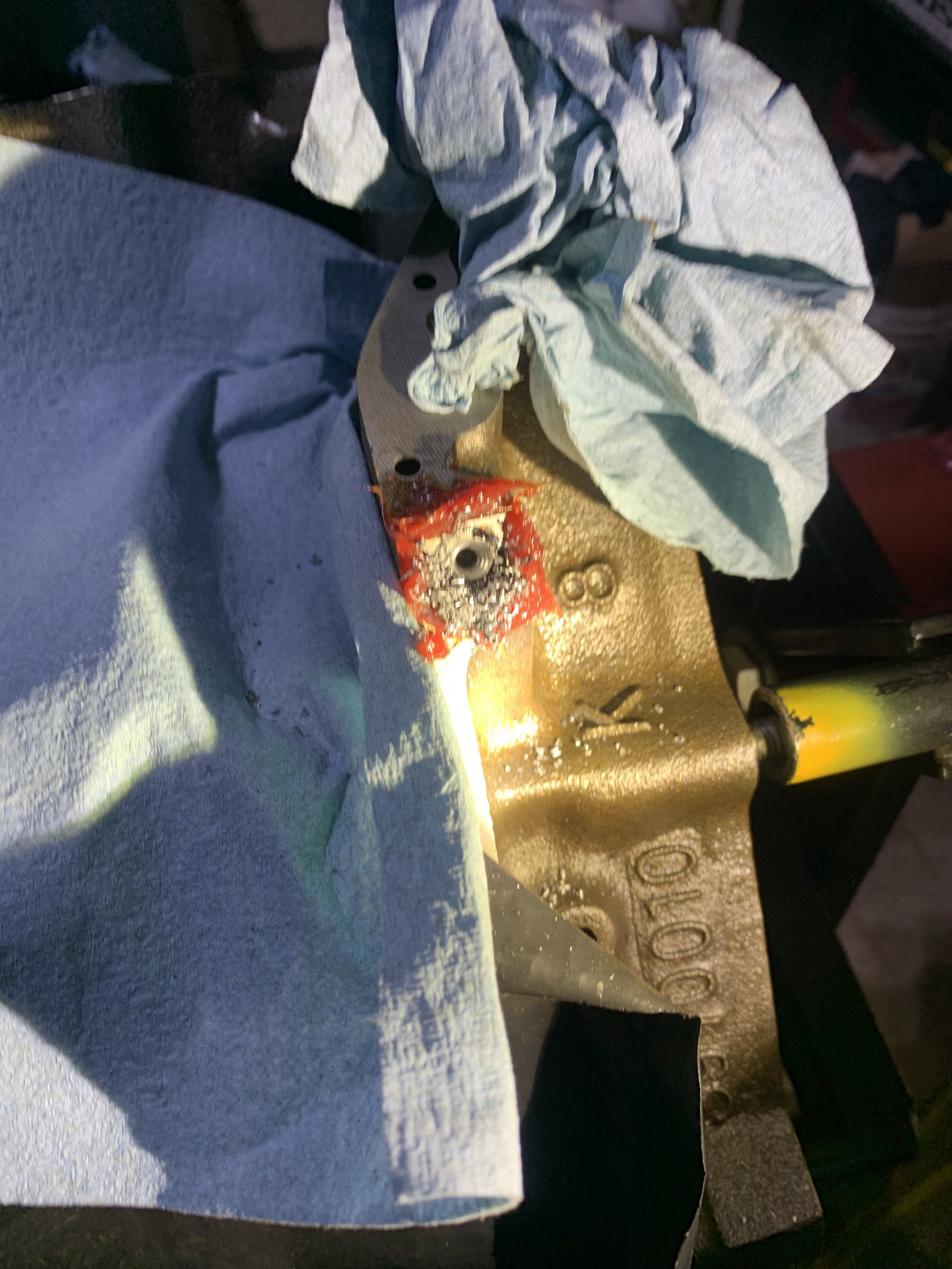

    I put the pics in order below so that anyone doing this in the future reminds their machinist to do this. By the way. The 1 inch of gallery I was able to access was spotless…but…piece of mind.
    Didn’t put the new plug in yet because I’m going to clean the block all over again. Can’t hurt. I’m going to use red loc***e because that is what I have. It’s that or Ultra Gray. IMG_5550.jpeg IMG_5552.jpeg IMG_5553.jpeg IMG_5554.jpeg IMG_5555.jpeg IMG_5556.jpeg IMG_5557.jpeg IMG_5558.jpeg IMG_5560.jpeg
    tb33anda3rd, loudbang and vtx1800 like this.

    Might want to tighten up your stand bolts before you swing heavy parts into that block.
  13. pila38
    Posts: 1,097
    pila38
    Agreed. Some idiot forgot to put washers on the bolt heads and they crept into the sleeve. There is plenty of thread in the block, I just have to put the washers on the other end.
    PS-I’m the idiot that forgot the washers

    Because with my luck, there would be a BB from the shot cleaning process lodged up behind that would come out on initial start and wipe out the engine that I invested ungodly amounts of money in. I complain….but the piece of mind is worth it to make sure that gallery was clean.

    This has been a learning experience for you, and the more frustration involved, the more you learn. Not trying to be a smarta**, I mean that in a good way. Although it's too late now, here are some suggestions/opinion.
    I would have rotated the block upside down to do any drilling and maybe hooked up some air that would blow thru from the inside as you drill. That way chips would tend to go away from the hole instead of into the hole. If not completely upside down, at least on a downward angle . I wouldn't have used grease to catch chips, because any that did fall into the hole would want to stick inside the hole, whereas just plain chips should blow out more easily. Now that you have done the deed, I would flush the oil p***ages with diesel fuel (kerosene costs too much). Remove the engine from the stand and try not to turn it sideways or nose down.....that way any possible chips should stay at the rear of the motor, then sit it in the diesel fuel rear face down. Flush fluid thru from bottom of that p***age if possible. Then raise out of fluid and blow air while rear of engine is still downward. The diesel fuel should dissolve any grease and the flow and air should wash it out well.
    When tapping a hole, cast iron usually taps easily. Just use a little oil. Also, tap a thread or two and then back the tap up to clear the chip and make tapping easier. Clearing a chip is a touchey/feeley kinda thing. Don't force the tap backwards. Turn it back and a little force should clear the chip. If it doesn't, turn forward slightly and back it up again. Sometimes you have to do it a couple times to clear the chip out. Then continue tapping deeper and backing the tap to clear the chip every couple of turns or so. If a tap feels like its taking too much force to make a thread, back it out and start again. If that doesn't help, get another tap. Something people don't consider is that taps do get dull, and hard to tap holes are often caused by slightly dulled taps. I find that using a drill that is slightly larger than the one specified on the tap chart often alleviates hard tapping. Maybe up to .010 on a medium size tap or larger. Try it on a test piece of steel by drilling 2 holes and tapping them with the same tap.

    And when tapping a hole, always keep the T-handle bar centered over the tap. That keeps you from pushing or pulling sideways on the tap... a sure fire way to break one. Tap sockets that allow you to turn them with a ratchet are really handy but you need to be careful with them for the same reason.
