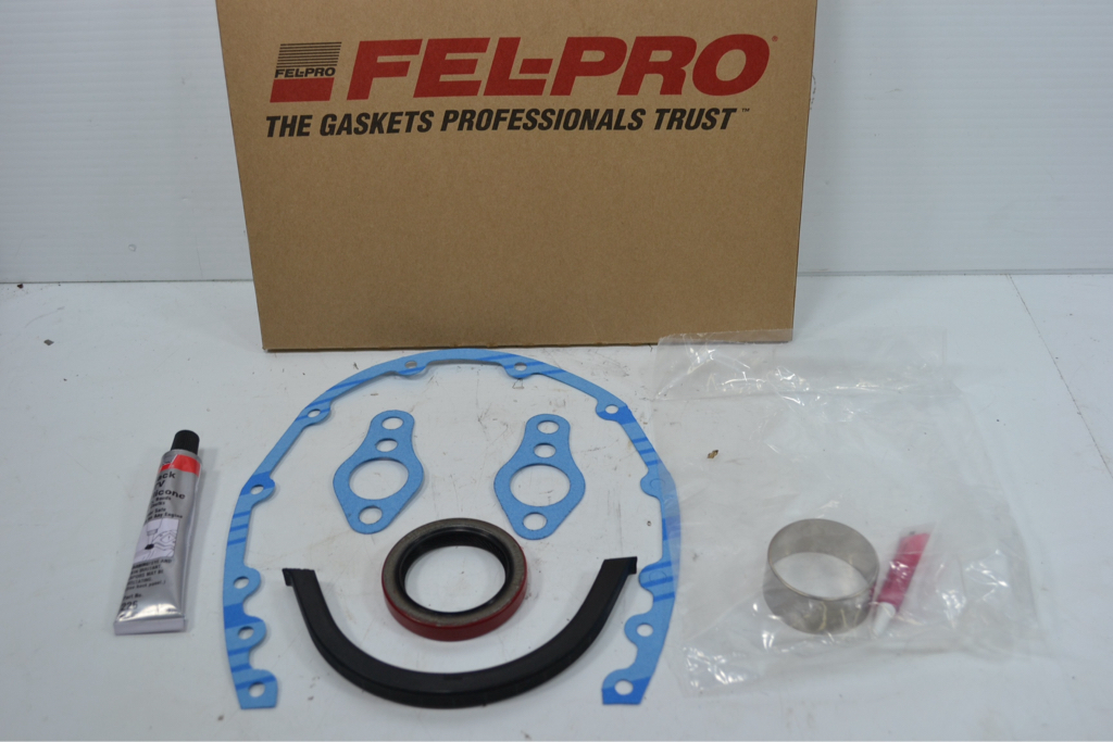

    Well just sat down after a long day. Installed new timing cover gasket, balancer seal, water pump gaskets and one piece pan gasket.
    Went for a test drive, few burnouts up to 4500rpm and no leaks. A big relief. My pan gasket came with those snap locks I think those ****!! Lol
    Thank you everyone for input and help. Some stuff was mentioned that I didn't think about. Atleast now I know I'm good at replace the front gaskets 3 times in 3 days.
