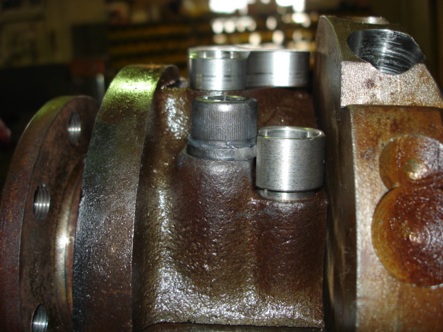

    Heres a couple photos of the problem, theres an adapter fitting that goes into thew block but it conflicts with the AllenHead Main Bolt, this is difficult to detect if you are working over the engine on an engine stand.
    This photo shows the full ***embly after machining some clearances on the adapter & pump.
