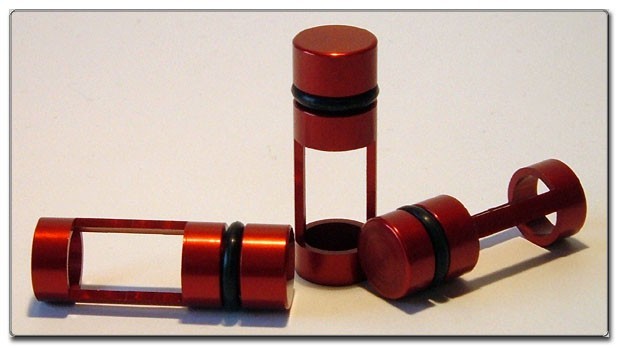

    This is pretty much impossible on an early hemi unless you've converted from the stock canister type filter.
    The early hemi has an oil filter byp*** built into the block. Some folks block this safety feature with a plug (see image). If you do this, BE SURE that you use an aftermarket filter adapter and a filter with a byp*** in it. The original canister style DOES NOT have a byp***, so if you intend to retain the original canister filter DO NOT block the original byp*** system in the block.
