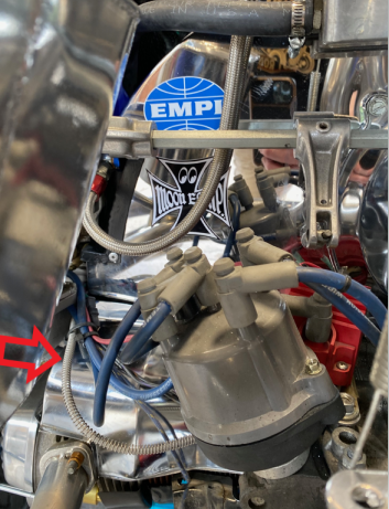

  9. Bandit Billy
    Joined: Sep 16, 2014
    Posts: 15,103
    Bandit Billy
    In my OT dune buggy I added an oil gauge to the dash and for ease of running the line used the plastic stuff. Since this is an off roader I covered the oil line with SS brake line gravel guard all the way from the engine to the gauge to protect it. It also doesn't look so cheap. Just an idea.
