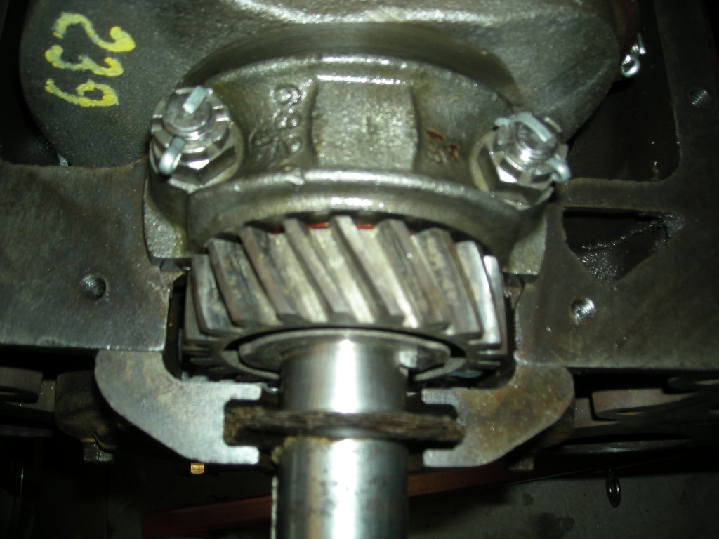

    I got my engine(1947 59 A-B ) back from the machine shop (1,000 miles away) & they didn't have the front oil slinger so they didn't install one. The crank & rods are all connected so I have to install the oil slinger somehow. How much do I have to disconnect? If I remove the main caps will I be able to lift the crank & rods enough to install the slinger?

    Take the timing gear cover off and install slinger and crankshaft seal.

    I just did what flatheadmurree told me to do. I opened my fukin eyes. The damn engine is a fresh build & on the engine stand. This dumb ass old fart couldn't see that the timing cover just needed removed. I'm soooo embarrassed. 5 bolts & it was done . I am going with rope seals. These have some kind of a white coating on them,never seen that before & don't know what it is. lugnuts.jpg
