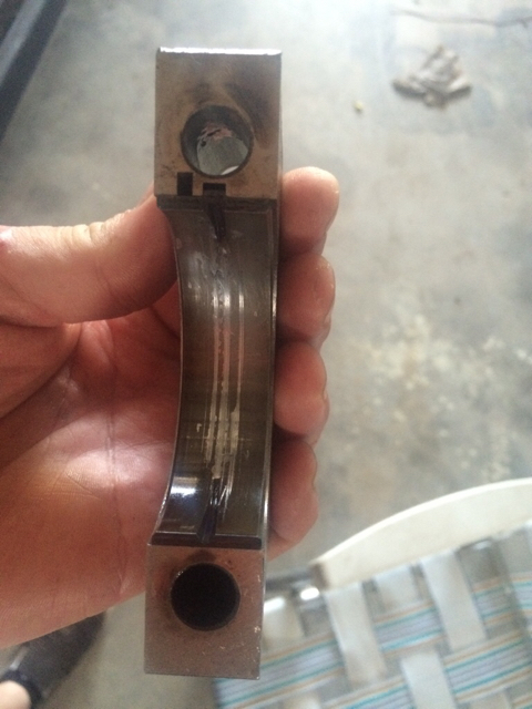

    So, this is the #1 main bearing. The shiny marks are just barely detectable with a fingernail. They are symmetrical and in line with the chamfered oil holes in the crank. The discoloration you see was a coating that came on the bearings.

    What do you guys think about the bearing pic?

    that shiny spot on the left upper, you will probably find a piece of dirt on the back side on the bearing , the other marks are also dirt, are those a decent brand???? dirt behind bearing, not clean enough on re ***embly, other dirt, probably same reason unless something up stream has failed.

    This thing was ran through the jet washer twice. Scrubbed by hand with rifle brushes etc. Dunno where it came from.
    The bearings were almost $100 set. HD Federal Mogul.
    So, I am ready to either put the oil pan back on and use the primer on it or hold off and inspect other things. I don't want to put it back together if there are other suspect areas. Any other things I need to inspect?

    Do all the bearings look like that? Do the chamfer oil holes in the crank look polished after grinding? High spots or trash maybe?. Those marks don't look good.

    I polished the crank with 2000 grit using oil as a lube after the last inspection, just to make sure the edges were smooth. They look a lot worse than they feel.

    What's the part number for those bearings? I can't see the chamfer on the bearing that well in the pic but this could also be an issue. Another thing to check is the lifter bores. H series bearing have a larger chamfer for large filet cranks.

    You sure got some dirt in there hiding on you, as you should never see bearings looking like that

    those shells should live in a bin somewhere, Id be getting the crank ground OR ask a machine shop for their thoughts on its condition, looking like that I don't see them living for long, it nearly looks like they are starting to fail (bit near your thumb) cant say much without the crank and shells in my hand. Did you run something like a rifle cleaner brush through the oil galleries? (followed by rifle cloth or similar till clean)

    My same thoughts, almost like the chamfering on the journals was done after polishing them, even the finest metal displacement could scar a soft bearing.

    Oh and only that bearing has that marking.

    .022" on side movement of the rods is ok but it will show lower pressure at idle for sure. It means more flow and throws a lot more oil at the Pistons, walls, and cam. You may consider a pan to block side s****er. We use one with flat tappet cam because of our rod side clearance. The bearing looks like something on the oil hole did make the marks. If you have a bearing s****er you could save it but many would make sure there was nothing on the crank and just change the bearing. I would remove the crank and reclean all of the p***ages in it paying close attention to the holes and chamfering. Good luck.
