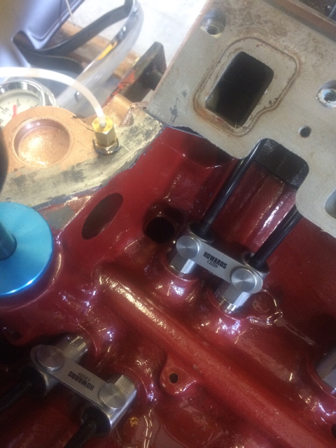

    I don't know why you would see a stream below the drain. Can you tell the direction it's coming from? Maybe remove the rear set of lifters and try to cover the oil hole with your finger while pumping oil.

    If you look at the pic I posted, it is in the rear corner. It comes from the back of the block shooting forward. After talking with some other folks, it may be the p***age to the oil filter. I'm looking at schematics to help discern what's what.

  6. the rear cam bearing and its webbing direct the oil....this may be where the oil is leaking from........ .
    Your housing for the primer must be shaped like a lower distributer housing or there will be leak as well.

    Difficult to see an oil stream clearly in your pic, but I am wondering about proper positioning of rearmost cam bearing with a heavy stream of oil in the area you describe.

    What it appears to be, is the return oil from the lifter galley.
    Here's where I am . Pulled the lifters and the front timing cover, dropped the pan down loose to get the the timing cover out. Removed all lifters so I can get a better look.
    In the first set of lifter holes from the back, there is a solid stream, if I cover that hole with my finger, the stream starts in the hole I posted pics of. The excess must just return to the pan when the lifters are installed. So I am thinking the cam bearings must be right.

    I hope that's all it is and not a crack in the oil galley just adjacent to it. Crossed fingers. [​IMG]

    It does it on both sides, so I am thinking it is by design. I think the pump may have been the original issue, but I am making very sure that every works as advertised. I don't have another removal/install in me this month.

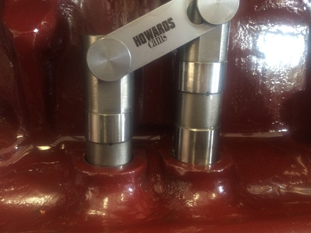

    So, I did more more troubleshooting.
    I pulled the lifters all out and ran the pump. I watched for oil flow and added a set of lifters in each set of holes, if it oiled, I moved to the next one until I was all the way at the front. Then it started oiling the timing chain. Both sides were the same. The lifters are also filling the cups where the push rods meet now.
    I am thinking that this may all be ok now.

    Do you think the roller lifters flow more oil (at less pressure) than flat tappets? Just wondering, I never had rollers yet.

  19. tomcat11
    Joined: Mar 31, 2010
    Posts: 1,148
    tomcat11
    So I'm curious. Some race/performance engine builders will install oil restrictors in place of the rear plugs when roller rockers are used. I wonder if the hydraulic roller lifters are designed to do the same thing and are supposed to be used only with roller rockers. This could account for the reduced oil flow to the rockers that you see.

    Retrofit roller lifters on early blocks can cause oiling issues if the lifters come out of the bore too far, uncovering the oil ring on the lifter and a large loss of oil pressure. Kinda like what you have going on. Just thinking out loud.

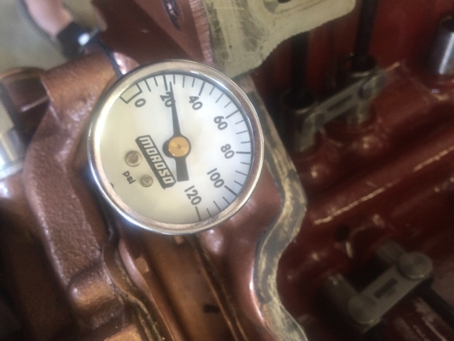

    I can't remember exactly MrHP, but I wanna say they were right in the middle on the tolerances when I plastigauged it all.
    On the last round I used a new battery on my cordless drill and we had 35-40 lbs on both gauges.

    I have my doubts that's good enough. Your pressure is with cold oil, engine, and pump. Once things are at temp, the pressure will drop.
