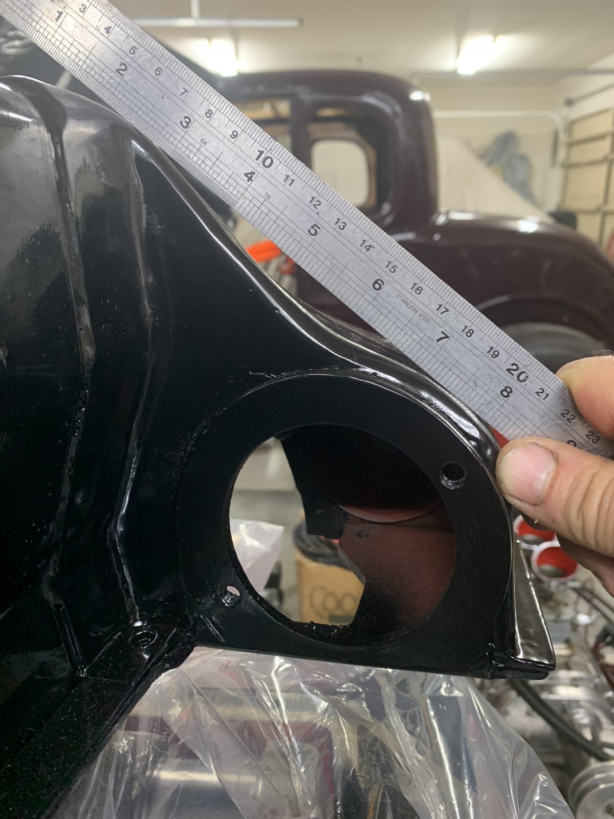

    Here is a 59a pan I just changed to fit stock 32 bones
    hfh likes this.

    Hank, you can compare the steel pan with the relief to an aluminum "59" style pan, which I think will give you more clearance. The aluminum pan was manufactured by Ford and used on military vehicles in Europe, to the best of my knowledge.
    Tom IMG_20221003_090955192.jpg IMG_20221003_090955192.jpg IMG_20221003_091055706_HDR.jpg IMG_20221003_091119841_HDR.jpg
    Jeff34 and tr_rodder like this.

    Ok I see the clearance, but this pan look different than another I try bid on, it was almost flat ( not a sump as this.
    This is the dream pan !
