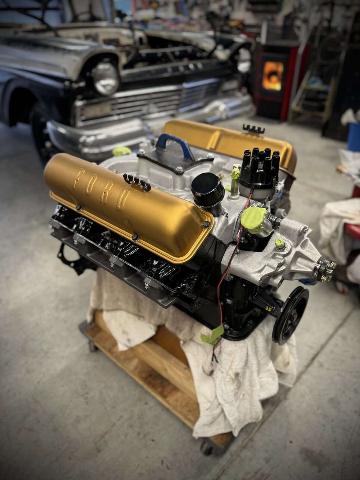

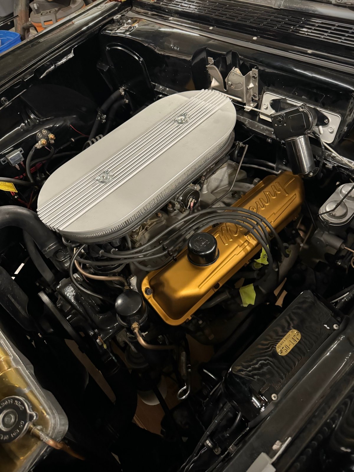

    I completely agree what is being said here by the members and what @Crazy Steve Mentioned on the truck bells.. pretty cheap these days as compared to a car bell due to the restoration crazies.
    They still can be had for under a $100 bucks.... I run them on both my FE's.
    Look around at some big bodied Mercs(66-67).. they had 410 FE's.. they were Grandpa's stump pullers.
    You may find one cheap.......a friend just bought an entire car for a Grand and it has a 410-C6.... Great basis to start.
    Yes,.. Brent Lykins... does some amazing stuff.
    I am a Torque guy.. and they Pull like a freight train when the right applications are made.
    I love my FE's.
