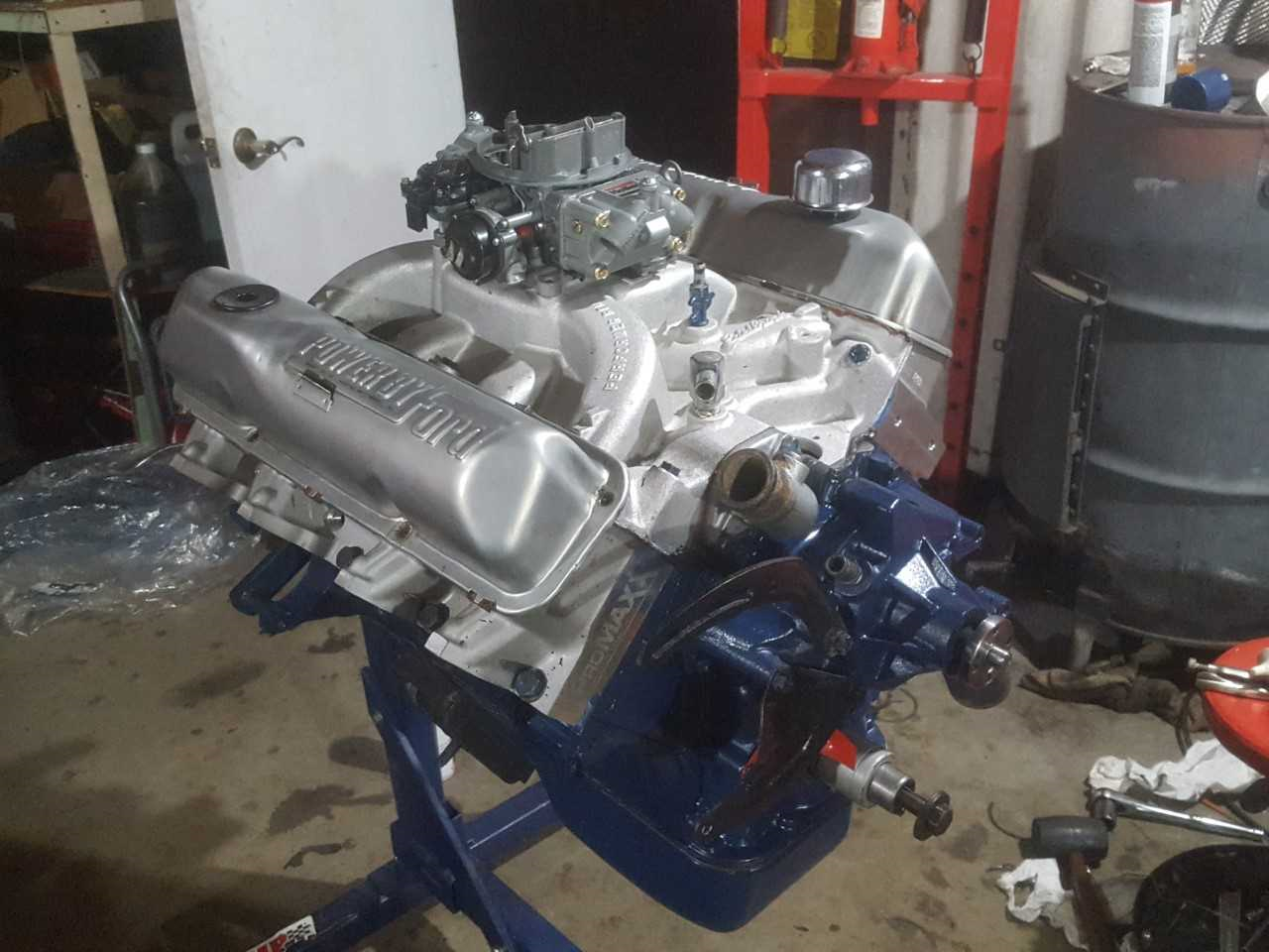

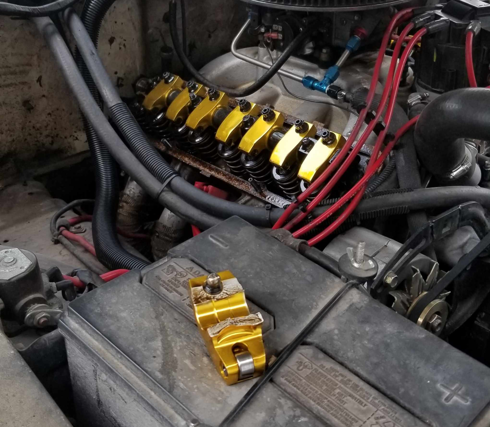

    Didn't read all the way through, but just chucking out my 2 pennies worth after building quite a few FEs......For an intake, don't bother with a regular Performer as they are a quarter step better than a stock 4 barrel, all you're really gaining is the weight loss. A Performer RPM is where it's at, even for torque, and they're dang near the same price as a Performer. A 445 cube stroker is going to want at least a 750 cfm carb.
    Oil system mods: You want to restrict oil to the top end (you can actually use Holley carb jets to do this), as the oil doesn't drain back out of the top end/heads quickly enough and you can starve the pump. A windage tray helps tremendously, especially if you're going to do a stroker. Clean and chamfer all the drain back holes in the heads and block. Use a one piece rear main, the split seals almost always leak.
    If you're going to use the stock rocker shafts, especially with stronger spring pressure, you NEED to get a set of rocker shaft supports, otherwise you'll break off the end rockers when the shaft snaps, losing all pressure, which happens when you least expect it. (also when torqueing the shafts down, be very careful to do it in steps, as you can snap the shafts at that time also). You can get complete rocker shaft ***emblies in the aftermarket, do not get Speedmaster, I've broken quite a few rockers when trying to cheap out on the budget when I was just learning these engines (snapped Speedmaster pictured). For affordable ***emblies, PRW stainless set ups are good. I got sponsored by ProMa** for autocrossing my daily pile F100, so I'm running their cylinder heads on that engine, but they are basically a copy of the Edelbrocks. Pretty much any Ford engine likes split duration/lift, with around 6-10 degrees more on the exhaust side and .010-.020 on the lift....you can get decent performance out of most common stock heads with a simple port and bowl clean. If you run stock irons, and they're so equipped, ditch the valve "rotators" as they're heavy and lead to valve float. I've run irons and aluminums, the aluminum heads are almost always worth it....best place to get an engine and trans is just to find a rusted out '70s Ford truck and buy the whole thing. I'd post more pics, but most my FEs are in OT vehicles.
    ffr1222k, bchctybob, Deuces and 7 others like this.

  12. 2devilles
    Joined: Jul 16, 2021
    Posts: 765
    2devilles
    Right on, I drive my F100 nearly every day here in Montana no matter the weather, from -30 to 110 above. They're great engines. Definitely clean and chamfer the oil drain backs while you've got it apart and if you stroke it run a windage tray. If you're running the stock rockers and shafts, definitely get some shaft supports like these eBay jobs I'm linking. There was a company named Precision Oil Pumps, and the guy was super, super into FEs and a great fella to deal with and his parts were all American made (Dennis was his name, I believe). I just tried looking him up again and his website is defunct, so probably went out of business. But you'll want to run some brand of supports, the stock rocker shafts fail all the time unless you find a fairly rare set of factory hardened shafts out of a 406/427/428. I have had the run of the mill shafts snap with even just a little higher spring pressure on a .533 lift hydraulic cam just putzing around town. Big block Buicks have the same issue.
    https://www.ebay.com/itm/115891938953
    bchctybob likes this.
