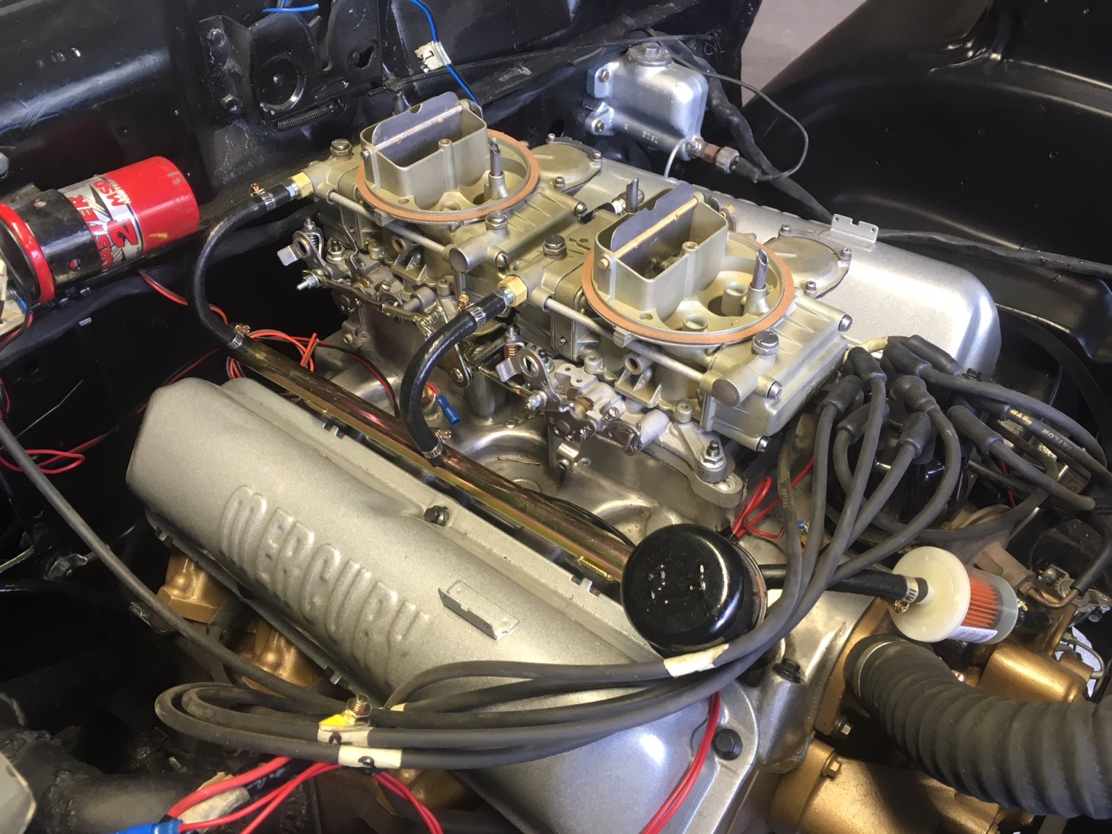

    Love those Mercury valve covers!! ^^^

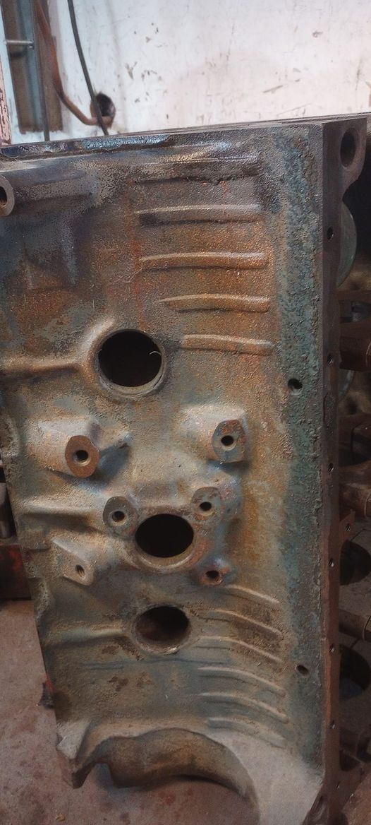

    IMG_9995.jpeg IMG_9861.jpeg IMG_9857.jpeg IMG_9992.jpeg IMG_9993.jpeg IMG_9861.jpeg IMG_9857.jpeg
    Yes, look for a block that has the “ mirror 105” cast in the front! They are known for just a little less core shift and have the “ web” in the mains area, that James was talking about. These are the latest FEs cast, in the seventies.
    Also 1964 and back FEs only have one set of engine mounts. 1965 and up have two sets of engine mounts…might make installation easier.
    Also, while looking , look for a 428 block! Some non 428 blocks can be bored to 428 bore ( 4.130) but most can’t!

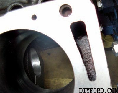

    If it is just a block, look down the front water passage and if you see “428” , it can be bored to 4.130+ , but a Sonic check would be in order! Also sometimes you can see the 428 in the freeze plug holes. This is o important if you want a 428+, but also makes for a good 390 based engine.
    But don’t spend a lot of time looking for these engines, they are some what rare.
    You can use a 391 truck block, they are usually thick walled engines , you have to buy a bushing to reduce the size of the disturbtor hole. And for all practical purposes the block is all you can use on a 391.
    These are some of the things to look for! But any 360/390 block will work just fine. Do not use a 352 block.
    If you can score a 428 block, you can build a 462, instead of a 445, for about the same money!

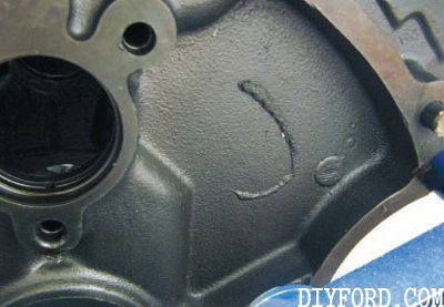

    Also, most all 428s have a “A” or a “C” sand scratched in the bell housing area.
    The ribbed block is usually a good one to build, not because of the ribs, but it is usually one of the later blocks. It also shows the two sets of engine mounts.
    The other picture shows the triangle lower water ports that extend below the head bolts holes , that can indicate a 428 early block or a later 390 block!

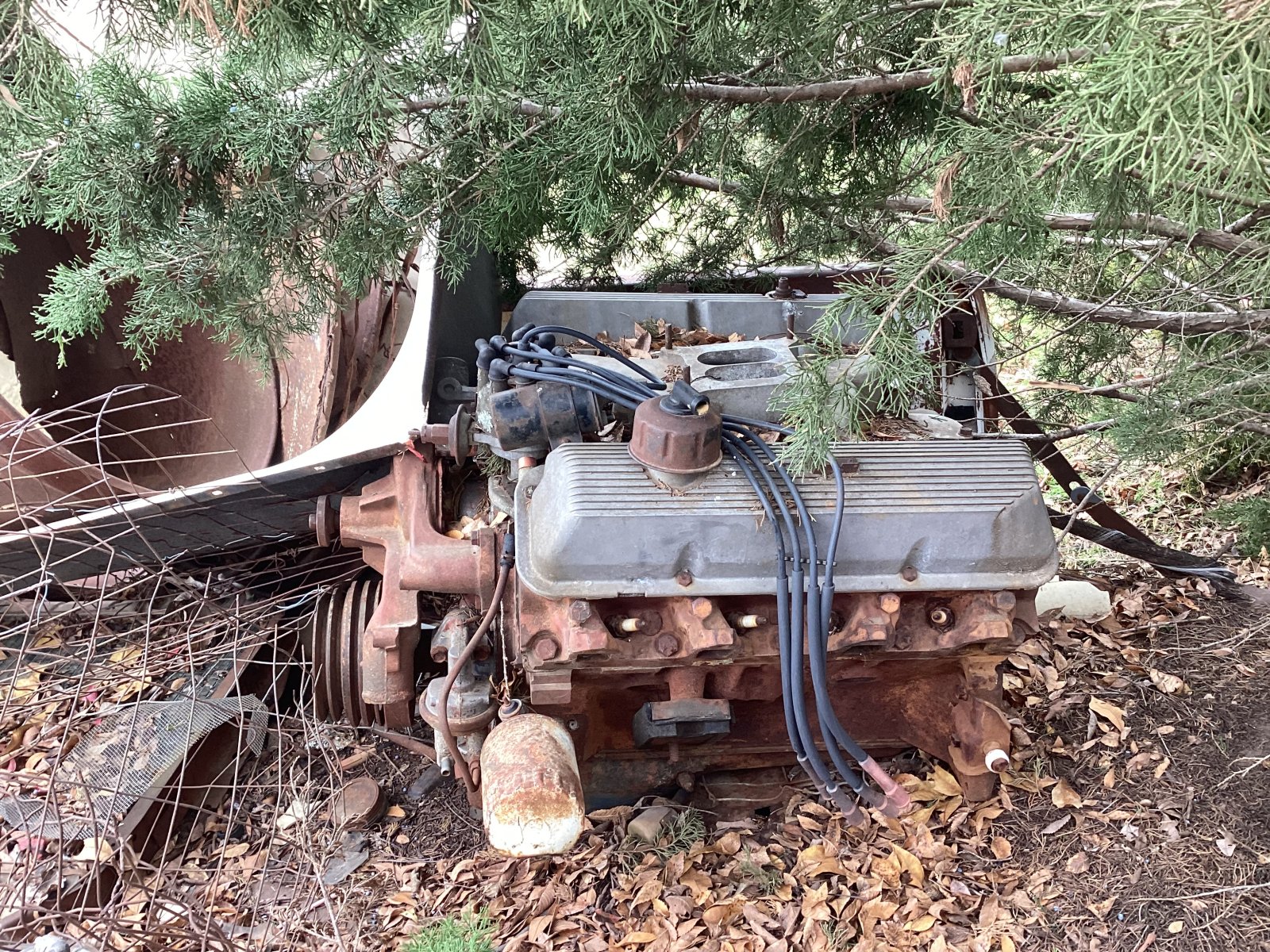

    Yep! They are getting scarce. Just showing you what to look for! Most of the time folks don’t know what they have! The 105 blocks are still plentiful. That’s the one I would go after! But while looking , keep your eyes peeled for 428s, you never know where they will pop up! I bought two junk trucks the other day and this engine was in the back of one!
