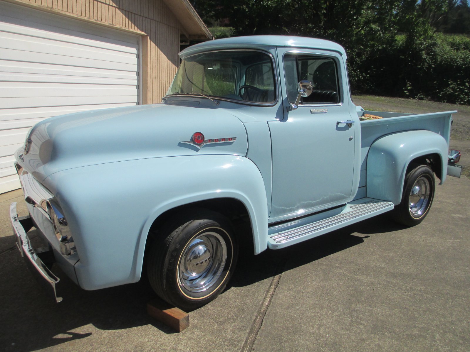

    IMG_9249.JPG IMG_9245.JPG A late buddy bought this 56 in 58, and put a 427 with a tri-power in 1970. Drove it very little, as it has 34 thousand original miles. Sure looks and sounds good !
