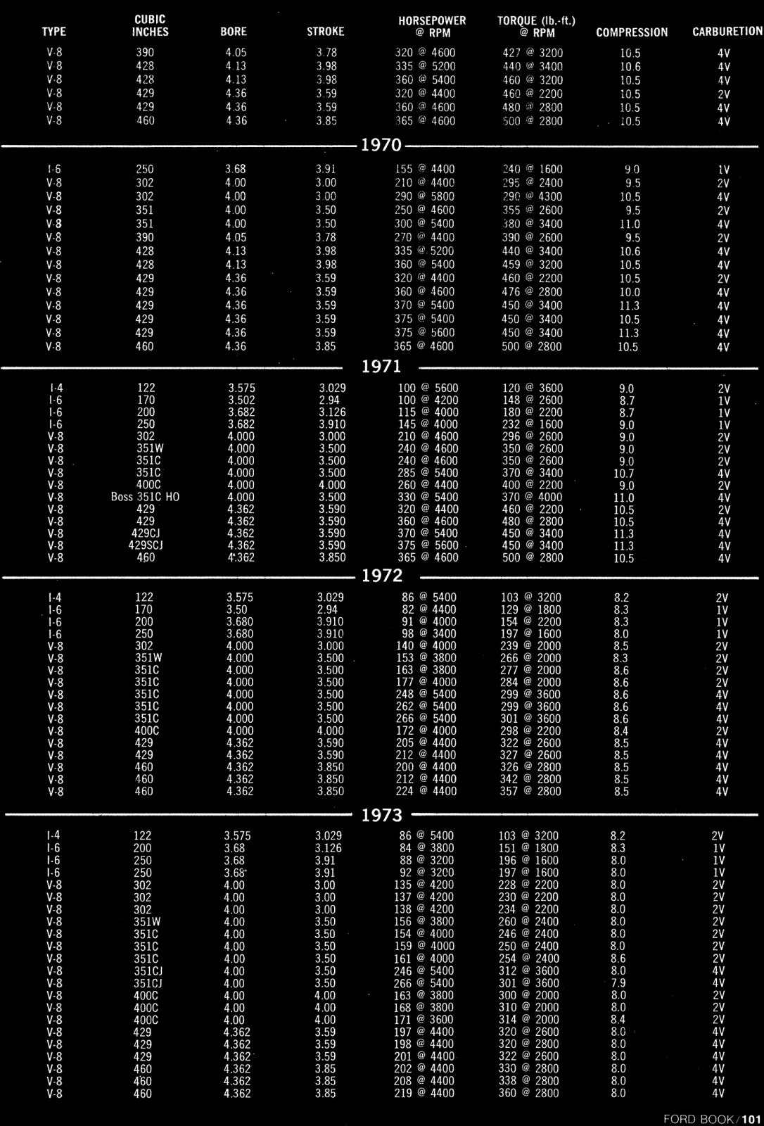

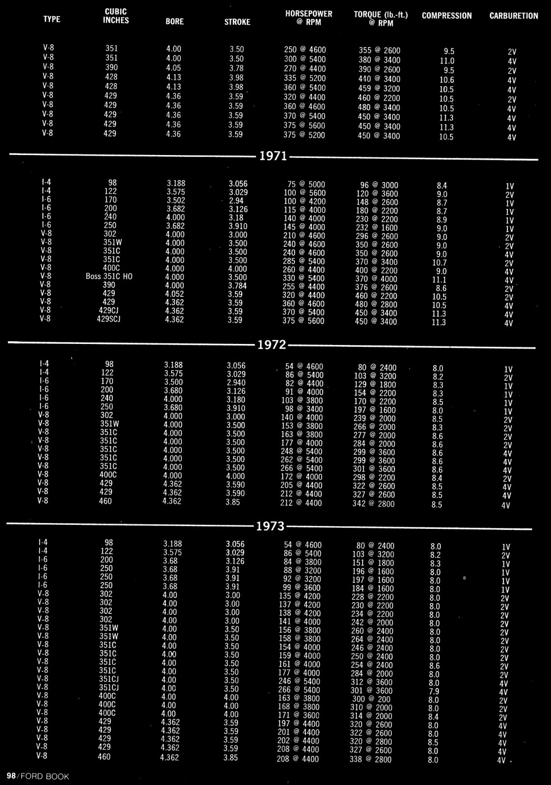

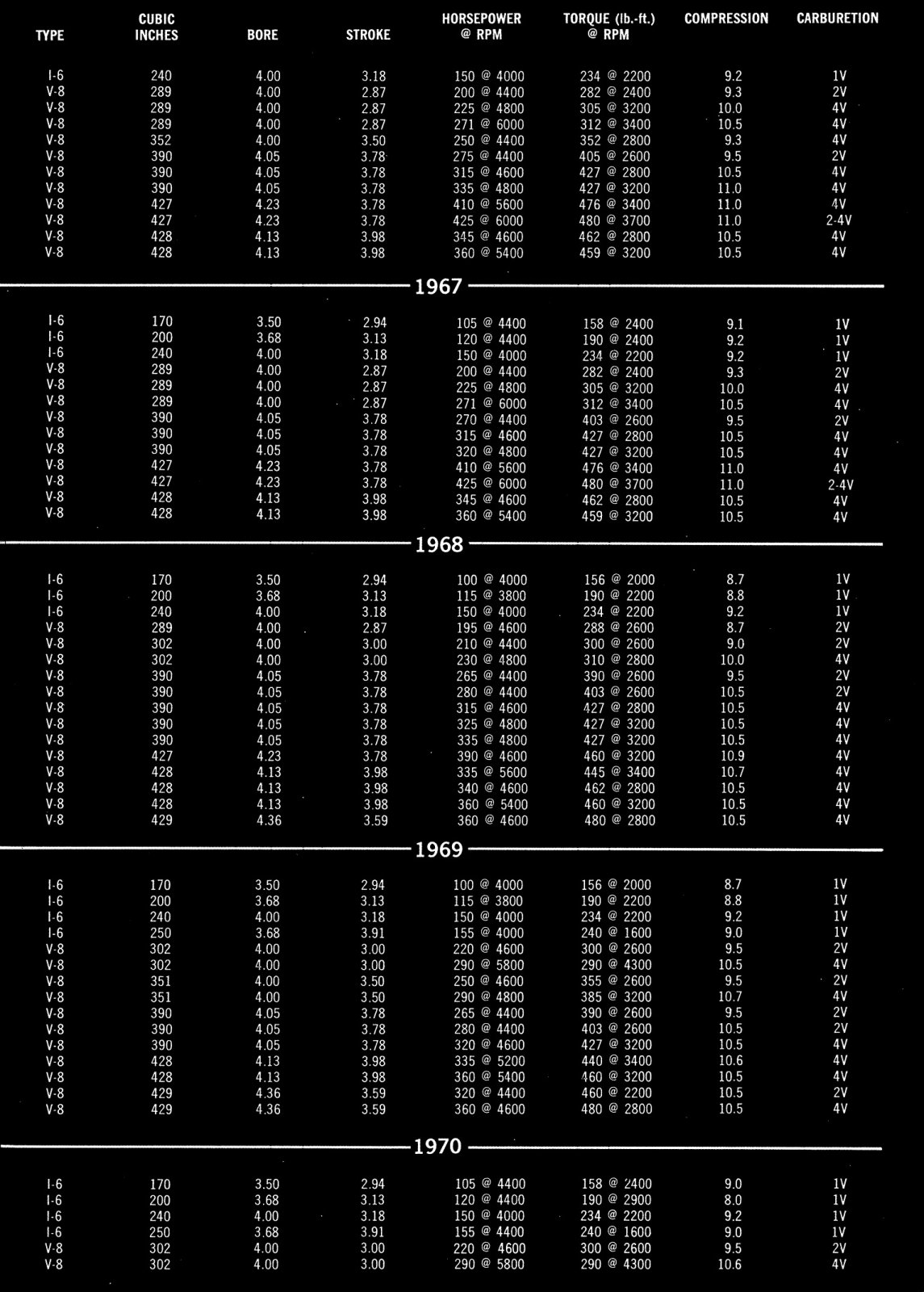

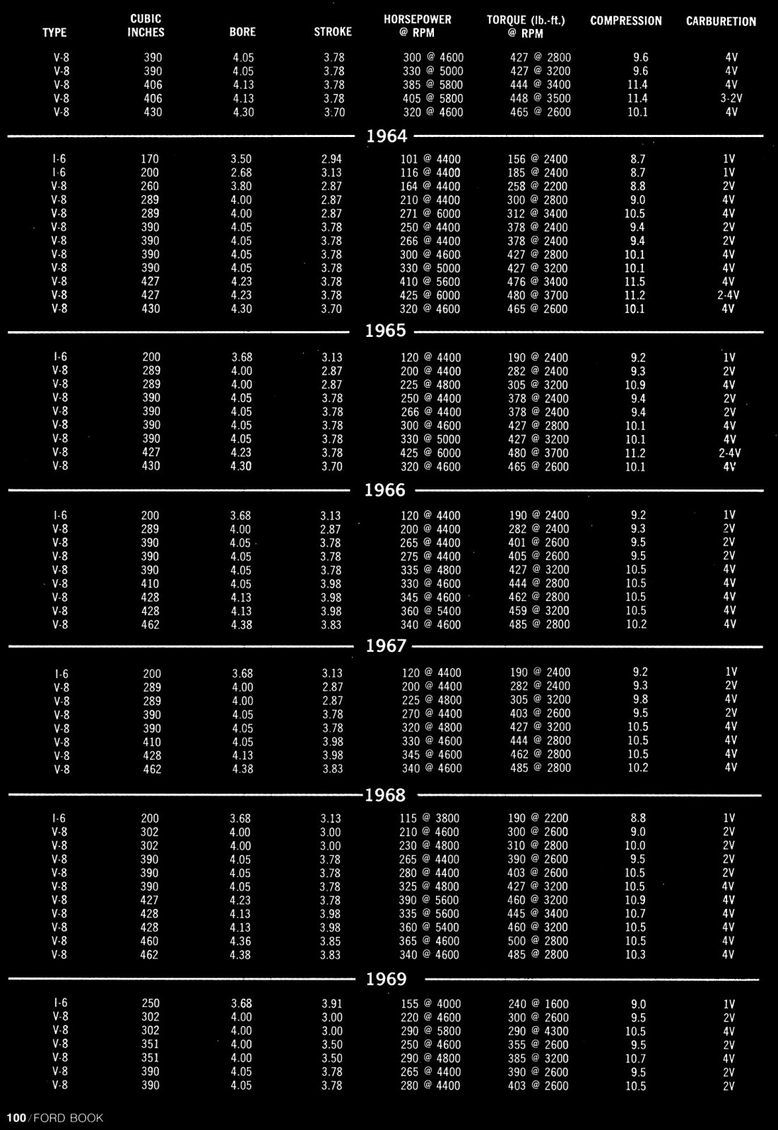

    I scanned some factory hp/torque ratings from a '73 Peterson book;
    Click the thumbnails to read
    Ford;
    Lincoln-Mercury had some different engine options;
    Deuces and RmK57 like this.
