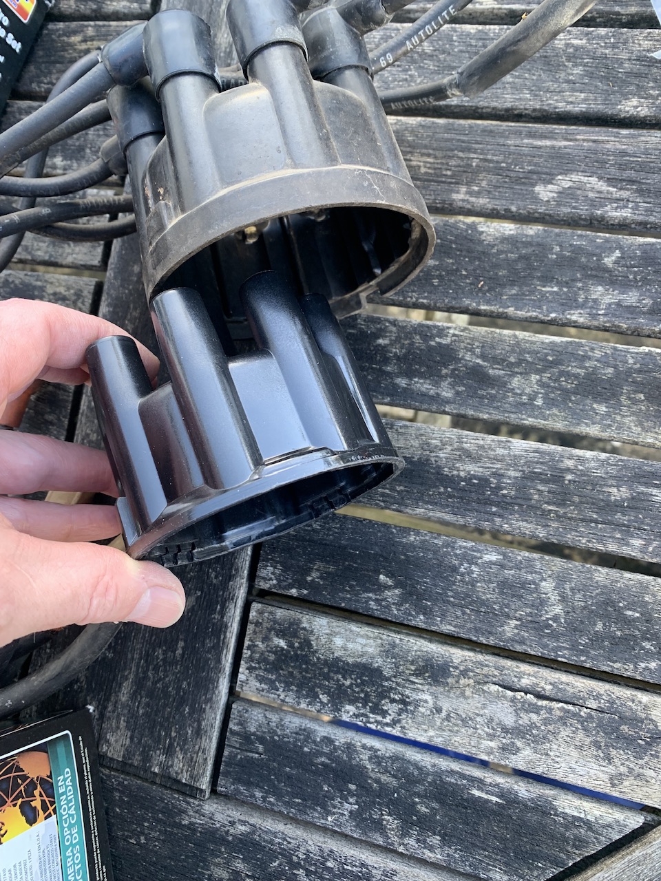

    While we’re on ignition. I order a new distributor cap for my 62 FE and what arrived doesn’t fit. Is there a simple part number for the right type?
  6. That's not a Ford cap.... As to part #s, every aftermarket manufacturer uses a different number. RockAuto has six different part #s from three manufacturers and there's more than three companies that make them, they only show three. Keep in mind that Ford used the same cap design on the V8s from 1957 all the way to 1973. The only variations that I'm aware of are cap color and whether the contacts in the cap are aluminum or br***.

    Thanks, that’s what I thought, when I googled the part number on the box of the new one it came back as just about every Ford made from 1964. I guess it has to be the wrong cap in the wrong box. I just wanted to check that there was just the one sort.

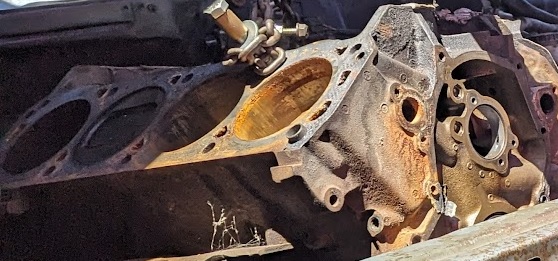

    FEs don’t like too much over bore, as a general rule. There are some that have thicker cylinder walls than others. The later mirror 105 blocks are thought to have less core shift, therefore allowing a little more over bore. There were some blocks cast as 428 engine but were only bored to 4.050 . There are ways of determining which blocks these are. These can take a lot of overbore. Some FT blocks can take lager overbores. I would recommend Sonic testing on any overbore.

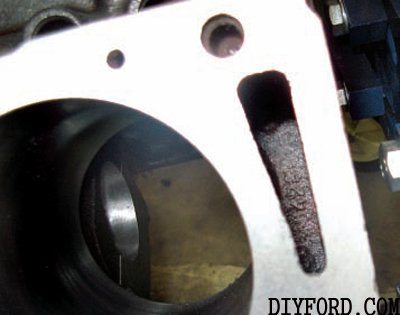

    Looking for a block, there are some indicators for the 428 cast blocks. The “ 428” in the water jacket. This is almost 100% indicator of an 428 cast block. And another quick indicator is the low triangle water jacket holes, extending below the head bolt hole, but this isn’t 100% , it just helps with looking. Almost all 428s have this, but not all engines that have this are 428s! There is a drill test between the cylinders through the freeze plugs also. Her are some pics. IMG_9992.jpeg IMG_9861.jpeg IMG_9995.jpeg

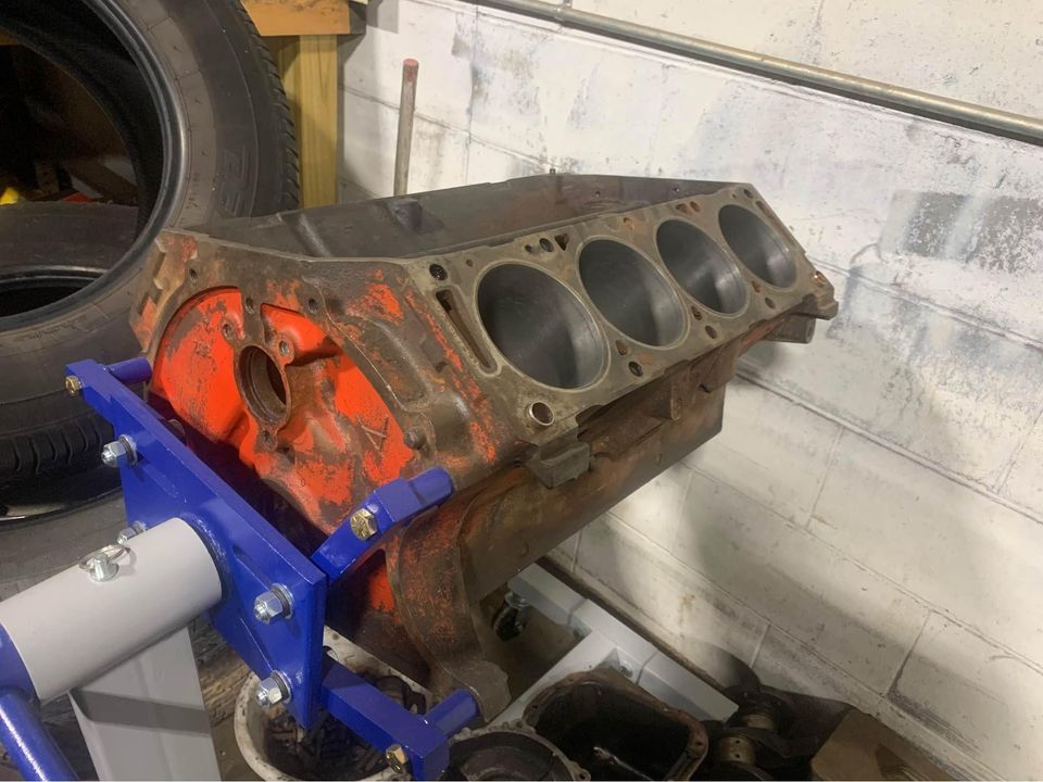

    Don't write off the .030" blocks until you have to. My son had a fatal overheat issue in his Bronco. It was wounded and had low compression in several holes. Bore scoped it and a couple bores were clearly scored and I could see on the piston tops that the 351 was already .030" over. Combine that with a few months sitting with coolant in the bores and I ***umed it was trash.
    I had a 302 block I was thinking of re ringing and the probably trash 351 block so I threw them in the truck and went to the machine shop. Carlos at AMS put his mic on both and said the 302 was a stock bore block with a lot of wear, needed bored and the .030" over 351 block might just might clean up at .040". Crusty 351.jpg
    Seemed impossible because it looked terrible. Damned if it didn't clean up perfectly at .010" over the already .030" overbore despite the overheat and scoring. I have a forged steel **** 4" crank for it and that trash is going to be a 410.
    Nothing ventured, nothing gained.
