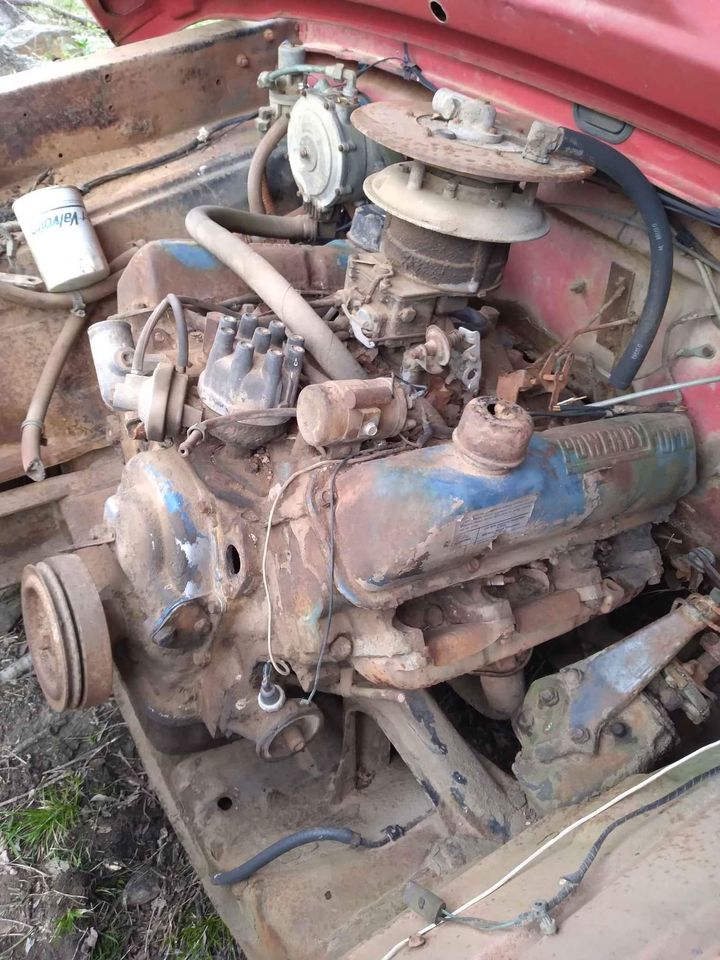

    So, I have found a 352 in a 69 F100 I can get for $150, up by @Boneyard51. My questions are "Can I go to a 390 Standard bore? Are there any differences in external parts, like oil pans, timing covers etcx?
    I didn't even think the 352 was still being produced in 69. I thought by then, it was a 360? Another plus, looks like it was converted to run on propane, so it might be clean inside. Fingers crossed....
    The only bad thing, is they want you to pull it. It's outside with no real provisions. Not sure if they have a tractor handy. I wonder why parts are missing? Getting ready to pull it? I don't care as long as it isn't cratered.

    I'll bet that's a 360. But...It'll make a 390 with crank and piston swap. Having been on propane the heads may need a lot of work. Still a good core though.

    If you buy it take the throttle linkage in case you want it for the kickdown mechanism.

    Apart from the LPG kit that looks pretty unmessed with, can’t even see any exhaust gaskets and the fuel lines are still there.
  15. Never forget there is a reason that something was parked. :) All of those old engines were wore out with high mileage but I agree with your statement that if it has already been rebuilt, you may be in trouble. About 5 years ago, I sold a running 360 for $50 to a friend for his winch truck. A year ago he said it was still sitting in the shop. I can't imagine he would sell it, though. Anytime we look for something 50 years old, it can be tough. :)

    I have run many engines on propane, and I can tell you , you will probably fine that the engine has very little ring wear. Propane is a complete dry fuel , with less power than gasoline. So you never get cylinder wall wash down. Like folks have mentioned, I bet it’s a 360! Let’s hope so, then you can have a 445! Where is this engine?Just wondering! I thought I knew of all FEs for sale around here! lol :eek:
    Edit: Yes all the outside component's will inter change.

    Sapulpa

    Somebody really wanted the oil filter.
    Locating the accessory brackets and pullies may be a major pain.

    It's on the inner fender. I think they were getting ready to pull it and lost interest. I agree the brackets may be an issue, but I probably won't use most of them anyway. They never seem to work out for me anyway.

    There are accessory drive parts and kits available, that engine does turn over, right?
