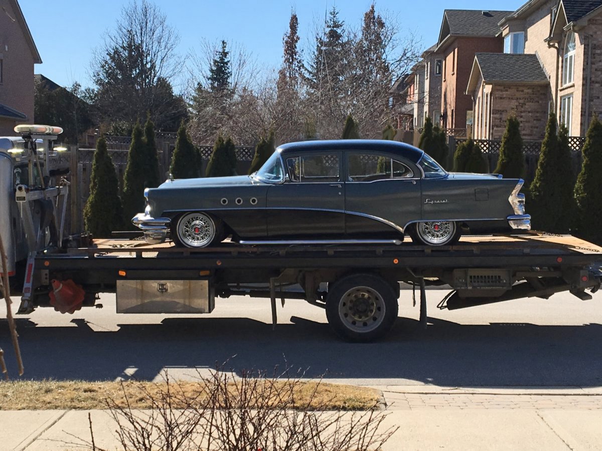

  1. Ok I’ve made a decision regarding my leaky Dynaflow in my 55 Buick special.
    I collected jaguar ifs and irs set ups a bumdstens adapter and a th350 trans. All set to make a big job out of a leaky trans.
    Had the house up for sale so the project was put on hold. And as such I was doing research. And it seems these old Buick’s are with more original then all hacked up.
    So I’ve sold off the trans, the irs and the ifs is gone today. The tranny adapter is getting put on a shelf ... as you never know what might happen in the future! Lol.
    Anyways I’m going ahead and resealing the Dynaflow and getting a new torque ball kit etc.
    My question is any tips or tricks to getting it out of the car and apart ?
    Anything to look out for when resealing it?
    Also where should I get parts?
    Seems everyone and there uncle sells kits on eBay and all over the net.
    For what’s involved in getting it apart and back together I want to use the best possible parts I can find.
    Thanks.
    Daniel
    A little photoshop by moose on the wheels !

    I can't help you but I can say your a hell of a man to keep the old Buick original with all its' short comings.. Oh, and that is a very cool looking Buick...

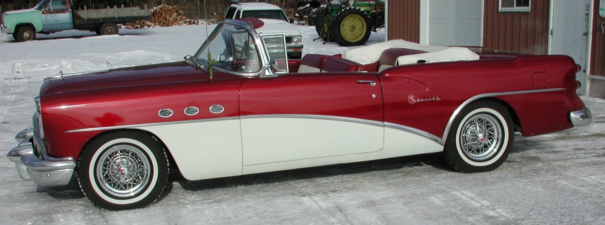

    BJR
    Here is a picture of a 54 Special convert I had. Stock 264 nailhead, with a 4bbl from a Century on it with dual exhausts. Oh and a Dynaflow trans. It would lay rubber in low with a brake start, and cruise down the hi way. Nailhead sounded great with the 4bbl and duals, nice rumble. I had no problems with the Dynaflow. It just took some getting used to the fact that it didn't shift, and was slower on the take off, then most other transmissions. Skylark wire wheels make 50's Buicks in my opinion. 54 Buick vert.jpg

    And @BJR that is one pretty Buick ya got there !
