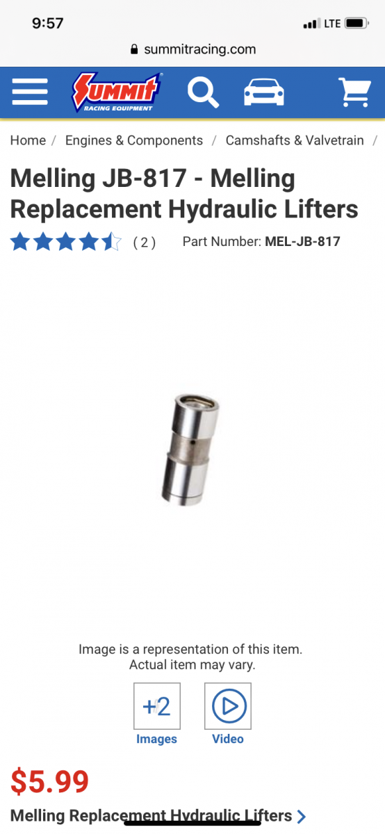

  17. A little nugget of info-
    Take note of Melling reps answer to the question. Then there’s a second answer,,
    Deuces and dirty old man like this.
  18. Truck64
    Joined: Oct 18, 2015
    Posts: 5,325
    Truck64
    from Ioway
    How much is typical for a "good" lifter? If those pictured retail for six bucks, I'd be skeptical on price alone.

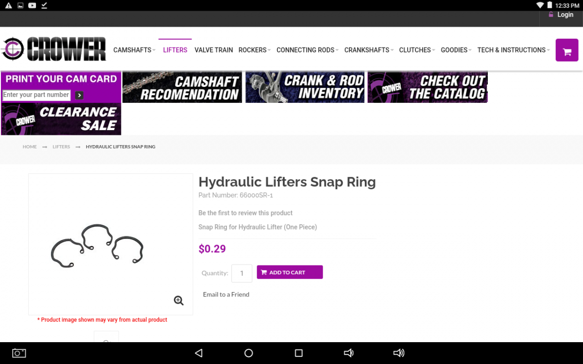

  24. Have not experienced it myself, but have seen enough pics of broken wire clips in today's lifters (don't know brands.) I have a new set of lifters waiting to be used and they have wire clips. On looking at older used lifters (I keep things :rolleyes:) I've noted that not all lifters use the same thickness -and I kind of assume - or material wire. Maybe some are better than others? I know 'metal' is a fairly loose term in some parts of the world.
    In any case I thought I would swap out the wire for some circlips off older lifters. I quickly discovered that the fit was too sloppy with the old circlips in the new lifters, so that plan died. Oh well. It's not a race engine.
    Tman and Truck64 like this.
  25. SEAAIRE354
    Joined: Sep 7, 2015
    Posts: 552
    SEAAIRE354
    One thing I would look at if changing from the wire clips is the shape of the groove. It’s possible that it is round to match the wire clips and putting a square cut snap ring would only be engaging on the corners. It sounds like @1971BB427 has had good luck with doing this but I would check the lifters you intend to use.
    Tman likes this.
  26. 2OLD2FAST
    Joined: Feb 3, 2010
    Posts: 6,003
    2OLD2FAST
    from illinois
    Standard retainer clip ..

    ps, my lifters do not have a parting line, and look like a solid body with the recessed middle section like the pic of the Summit ones above. Even the numbers are similar, indicating the most likely other companies are also buying left over stock assembly parts to rebrand, and sell. ‘there’s a bunch of guessing going on these days, so when you get the info straight from the (reputable) company, you have to hope for the best going forward!
