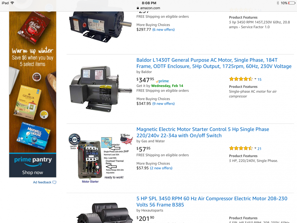

  23. Roothawg
    Joined: Mar 14, 2001
    Posts: 26,098
    Roothawg
    Kinda what I was thinking. Now to convince Mama Root....
