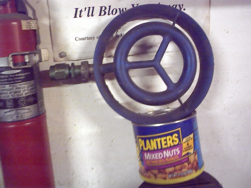

    Actually I have a Venturi Air horn off a over water 747 life raft. It used high velocity g***es from a black powder explosion to draw in outside air and inflate the raft. If you get out here you can look at it and see what you think. If nothing else it looks cool. Sure to cause much hate and discontent.

    RichFox
    Fuzzy pictures of 747 part
