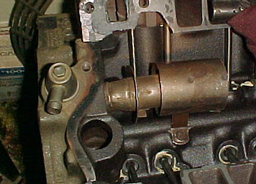

  8. burndup....Is this what you're looking for ? That's a '68 327.

    AHA! its on top.... ok, I got a freeze plug where that should be... whats the best way to re-establish that?
    Get another freeze plug, drill and tap it? does it vent to the ground, does it need anything put on the end?

  11. What BigCheese said. Just a hose to the ground. I'm wondering if a guy could use a PCV valve in a line to the carb instead ?

    A road tube engine will have a metal tube pointing to the ground. That engine has a nipple for a rubber line back up to a PCV valve. I think 68 was the first year for a pcv valve. A rubber hose will work for venting.

    A "road draft breather" works on the same principle as a carburetor. It's a metal tube that extends down below the motor into the "draft" of air as the car is MOVING down the "road". It's usually cut off on an angle. As the air passes over the end of the tube it forms a negative pressure(vacuum). The vacuum pulls the blowby gasses and moisture out of the crankcase <font color="red">IF </font> there is another breather (usually the oil fill cap) to let freash air into the crank case.
    This is a Chevy V8 road draft tube. 58-62 it goes in the same hole in the block behind the dist.
    Pre-PCV valve cars idleing will sometimes have oil vapors coming out of the breather when they aren't moving. (no vacuum) PCV valves work when parked and when moving.
    Pulling a vacuum on a motor without another breather wont pull any air through the motor. Put your finger over the end of a drinking straw and suck. [​IMG]. It's the same principle for either a PCV or a road draft system. Bad air out good air in.
    A hose running from the fitting in SJFAST's block picture above to a PCV valve continuing on to the intake will pull the vapors out through the "can" under the intake. The oil fill tube breather will let freash air into the front of the valley. Bad air out ...good air in [​IMG]
