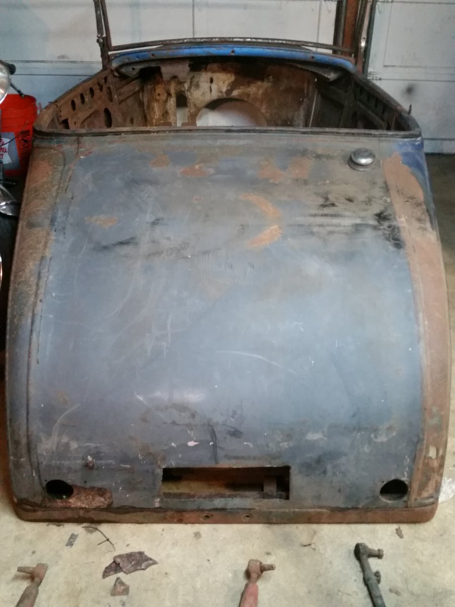

  4. I'm not opposed to a flathead, It will probably come down to what I find first.
    Have you had a stock 32 frame and a stock A frame side by side? The differences are substantial. One is a flimsy noodle and the other is pretty stout comparatively. I do get where you are coming from about the reveal.
    thanks, I feel the same.
    thanks!
    The top of the windshield is right in my eye line. I also want a top...
    He thought that a door would make it more desirable to sell. He originally snagged the body from his dad who parted it out in the early 70's. It was rust free when it when in the shed on its side. He had the intent to build a hot rod....but 40 years later and there it sat and the mice had made a good start on the rust. He actually said he thought about scraping it a few weeks earlier, but decided to wait to see if he could find a door at the swap and then sell it.
    thanks Beaner. The car was parted out around 72-73., so I would guess that the bondo was a mid to late 60's addition.
    I wouldn't kick a cad out of bed either....

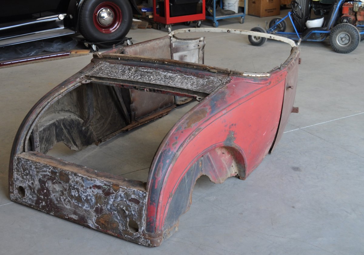

    I have the kissing cousin to your roadster. Mine also is an old channeled body that had the panel above and below the deck lid filled smooth. I scraped thick bondo off the tulip panel, but the tail has a sheet welded over it. I don’t know how I’m going to build mine. But chances are good it will be on a 32 frame with an Olds mill. I bought mine at an auction in 2012 in Eastern Nebraska. Roadster body.jpg

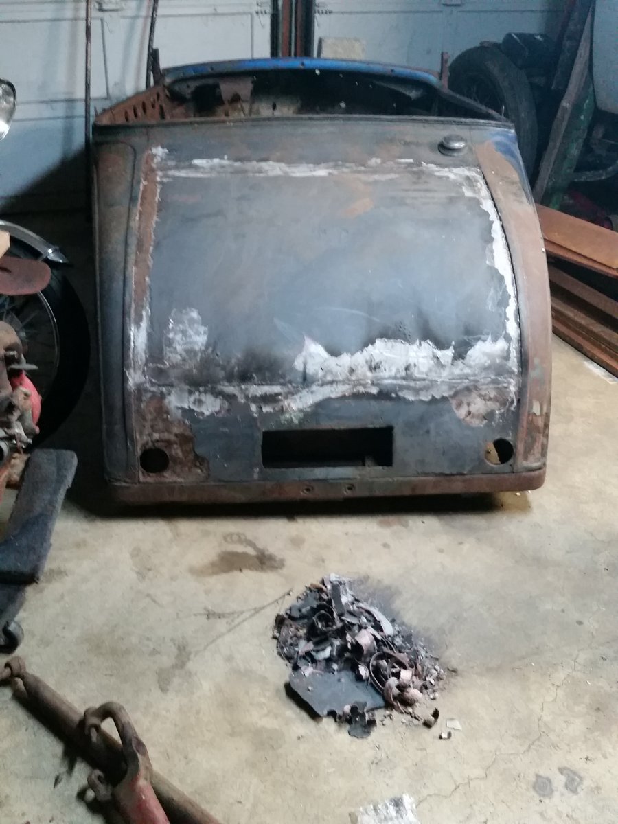

  14. So last night after an adult beverage or two I grabbed the frame I have out back and set the body on it. FYI not that easy to do by yourself...
    I think it may have actually been on an A frame judging by how the body fits it. Unfortunately I can't fully get the body on the frame without chopping off the stock front cowl body mounts and I just sold it last week.
    I'm seriously considering ordering up a brookville subfloor and building the body back on that. I am wondering if I can get away with 30-31 rpu subrails and something like the steadfast model A to 32 frame kit for the rear half. No need to buy metal I will just cut out again for a 32 frame. Also does anyone know if there are upper quarter patches available? Like right where mine is rusted or am I looking for an original quarter with a wasted bottom? Also I need a clean firewall if anyone reading this has one. I'm almost certain that I am going to unchannel this thing. I just don't think long term I will enjoy a channeled roadster. I'm thinking I should build it exactly how I want my ultimate model A roadster to be, since I have been saving a lot of the parts for it for almost a decade. If it was a complete car I would have other thoughts. But so much is missing and it will need a floor and mounts and everything anyways. I think I can safely make it my own with no guilt.
    Anyways here is it on the frame with no clutter. the stock forward, after the center crossmember and rear mount holes on the frame line up with the "body mounts" on the body. I think its safe to say this was on a A frame. I called and asked gary about it and he said he honestly didn't know. just that he thought that a 32 was under it.
    Also here is a some of the stuff for it.
