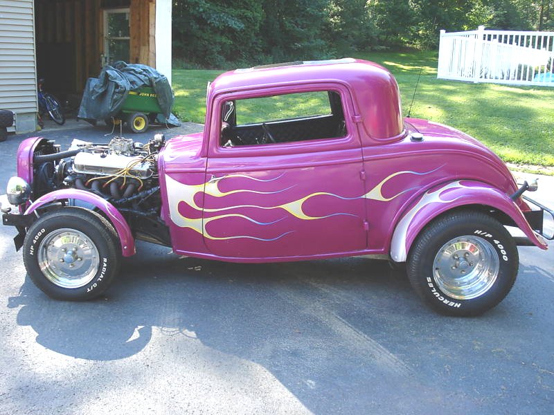

    Here is the evil twin that I owned. Lost a lot of money on it in the end.
    the body was rusted all along the lower body. It was built using a narrowed and shortened 63 impala chassis. Ugly but probably made o good street racer with 454 and Muncie 4 speed.

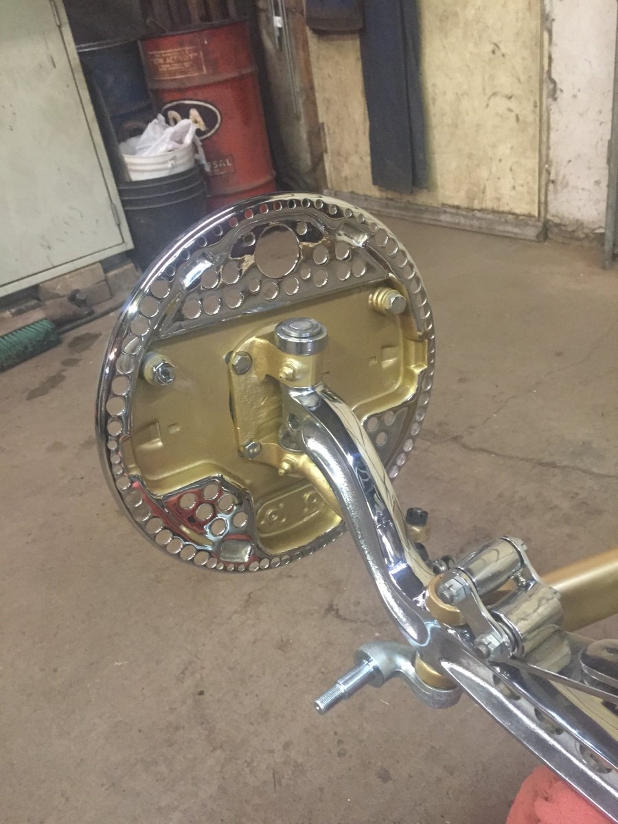

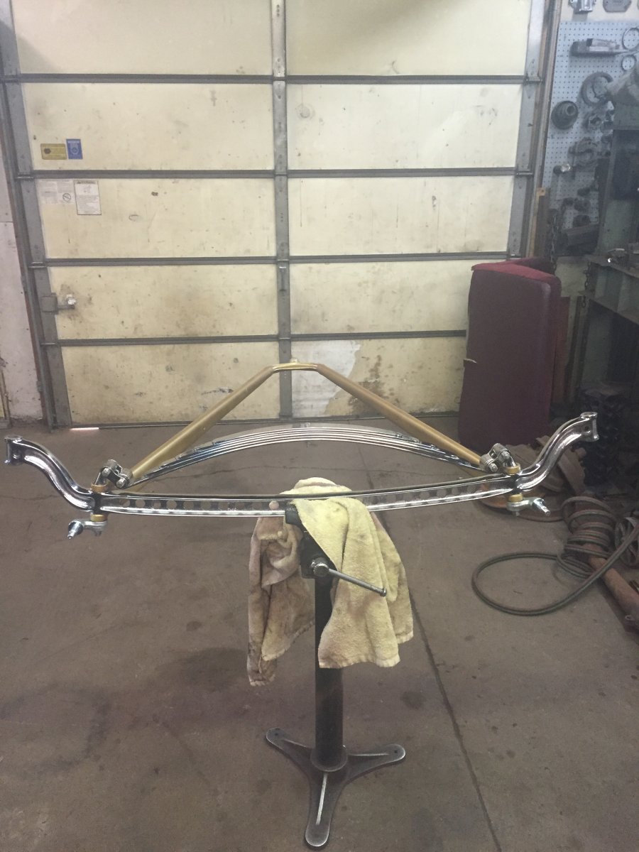

    made a little more progress on the 3 window today, put another front end togethor for it, using some chrome parts ive had around for a while. its not the perminant front end for the car but will be used for now till i can get the other stuff i want to use in it plated. also got the f1 steering box modified and mounted.

  22. Sonofabitch! That front end is perfect!

    Those backing plates are a work of art!

    Hi, ..nice job. ! Chromes cool! Backin plates cool,! Axels way cool!! ..3 cool points[emoji851]!!!
    So that's a 32 "thick beam "??,.. Dropped how much? Thanks

    thanks, thats actually a model A axle that has been milled to 2" perch width to fit in the 33/4 bones. its roughly dropped 3-1/2
