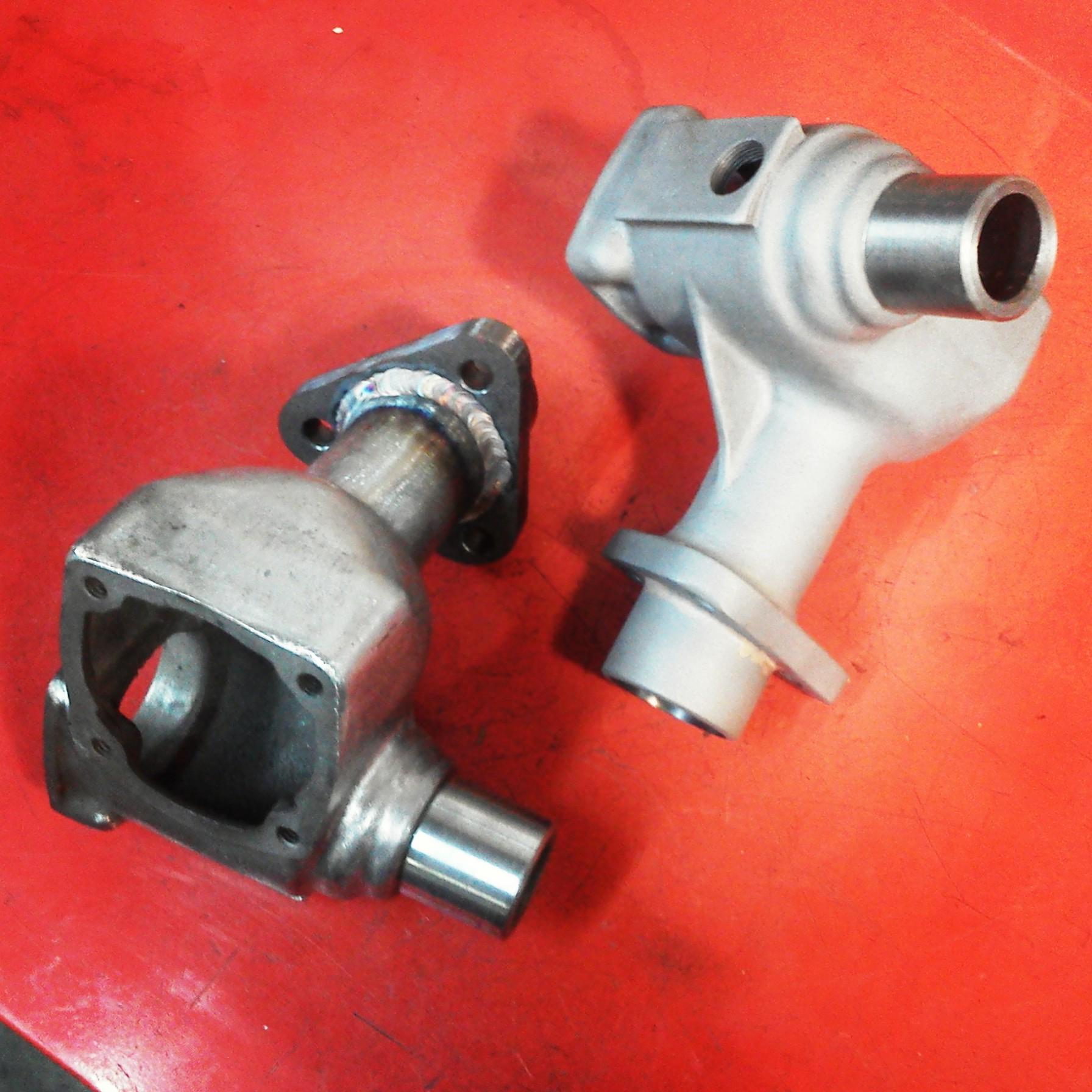

    The project is on hold for a bit. Between a full time job, kids involved in sports and 4-H projects, and me building steering boxes for others, it's hard to carve out time for my own stuff. I hope to get a batch of steering boxes done in the next couple of weeks, and then get back on this one. I will post updates when I do.
    Neal
    BTW, Jimmy White hooked me up on using 312 SS TIG rod to weld the flanges on. It works great. I also had some 2-bolt weld-on steering boxes made up for putting an F-1 box in a Model A...
