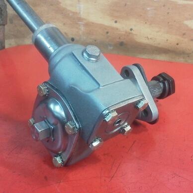

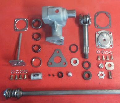

    I was able to get a steering box built for the car...it's a converted 37 Nash...
    kidcampbell71 and Runnin shine like this.

    Your Nash boxes are so dang cool.
    I really like the direction of the build.

    Beautiful job on the Nash box, Neil. On Old Rusty I have a similar setup with the lower hoses, and was aware of a potential rubbing of the hose from the v-belt at high revs due to the belt "whipping".
    I protected against failure by firstly wrapping some cable ties round the hose, but when I saw those getting ate into by the belt, I put a hose clip round the hose at just the right place so if the belt whips out, it will just run harmlessly against the smooth part of the hose clip.
    Your setup might be ok, but I mention it so you can look closely in that area and look at the hoses for signs of contact.
    Mart.

    Nash books looks good. Is it recirculating ball?
    Ago
  22. Mart
    Posts: 4,990
    Mart
    It's a worm and roller like a 37-up Ford box.
