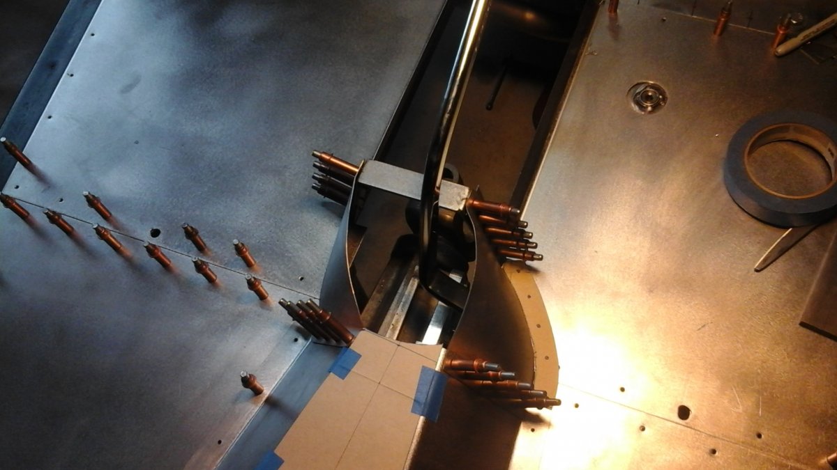

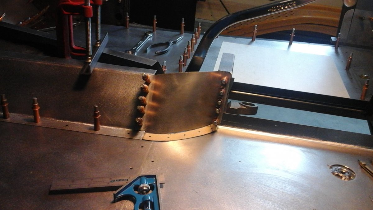

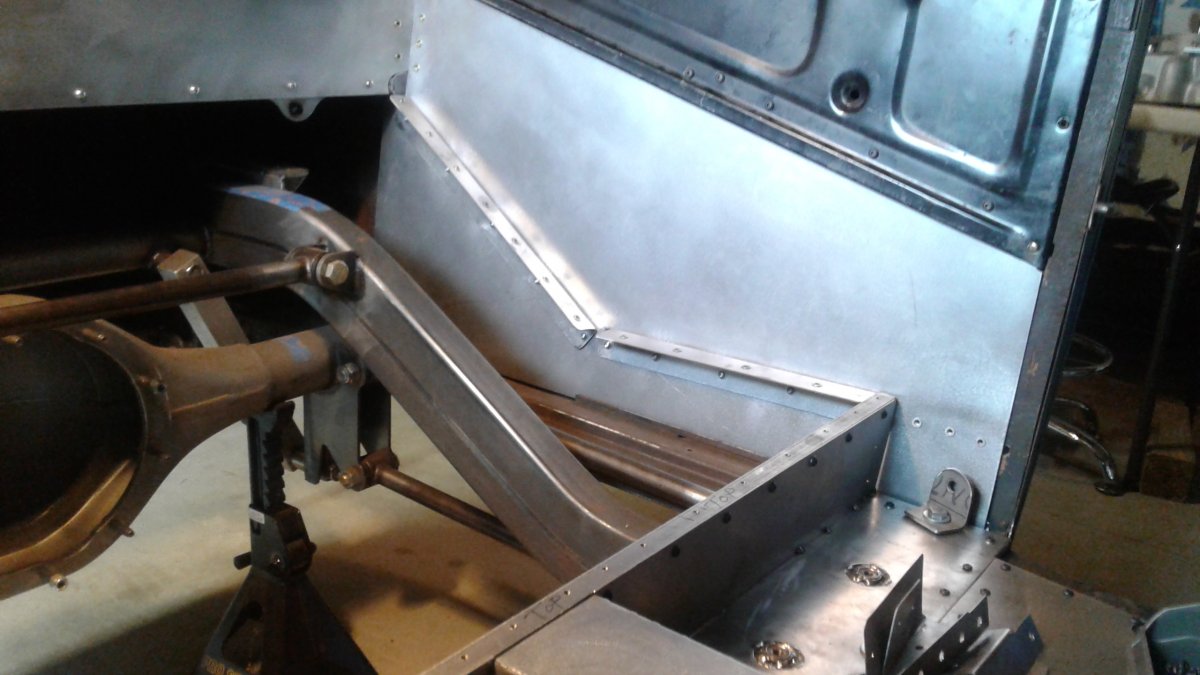

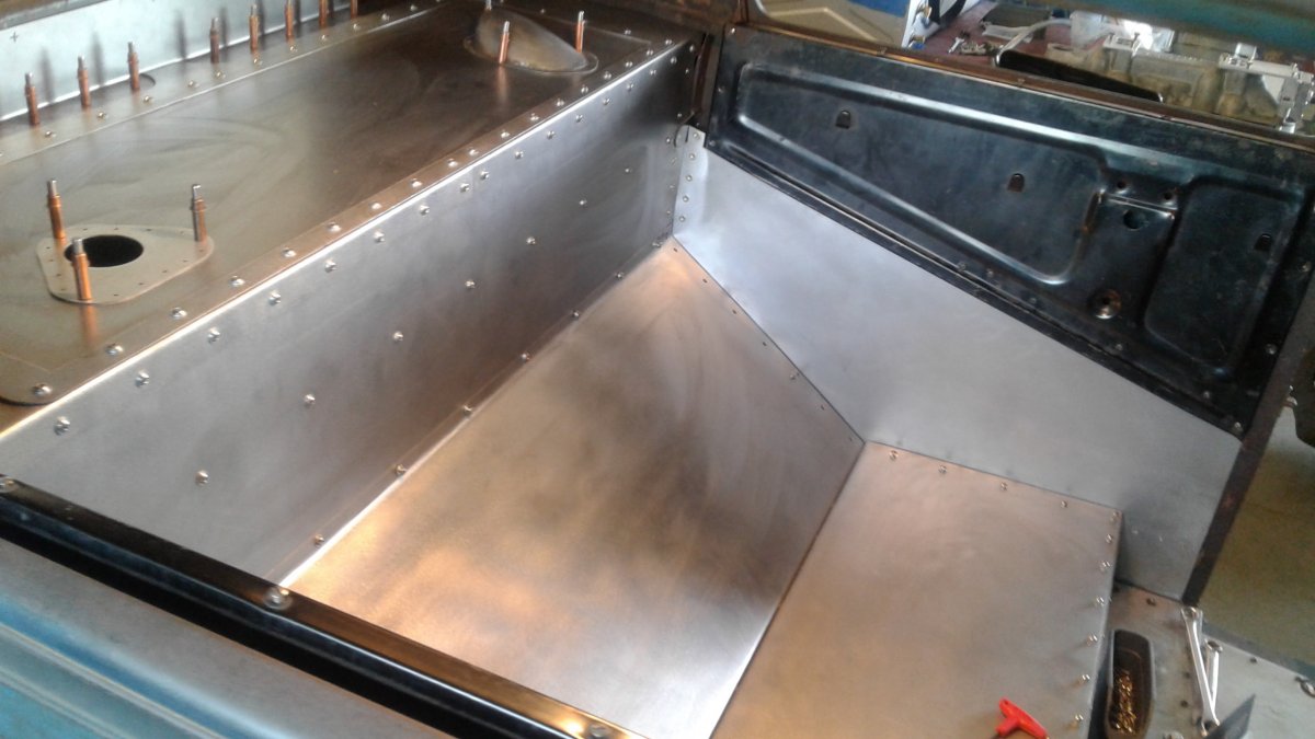

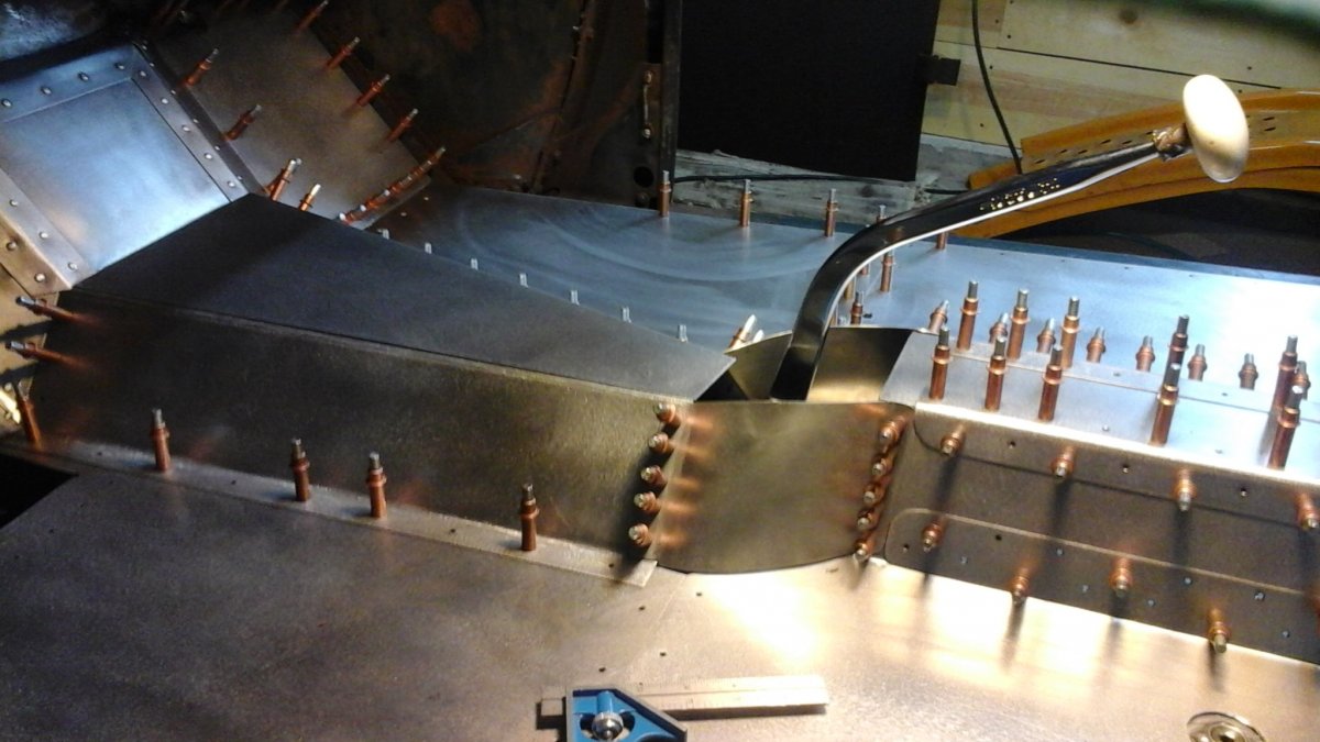

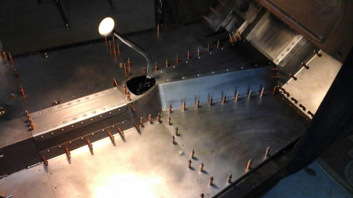

    Im back with more pictures. 20161208_141227.jpg 20161213_102458.jpg 20161212_115716.jpg Done for now

    Wow! Tremendous work, you have to have a lot of patience and drive to do such work. Very impressive.

    Going be a shame to cover up all the beautiful metal work with sound deadner and carpet. Gene

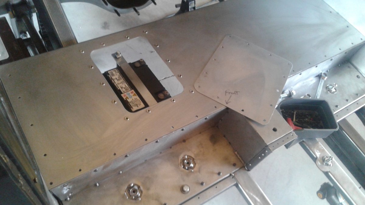

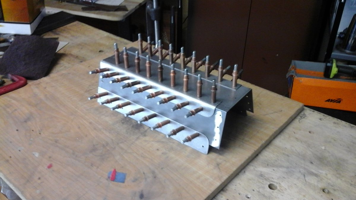

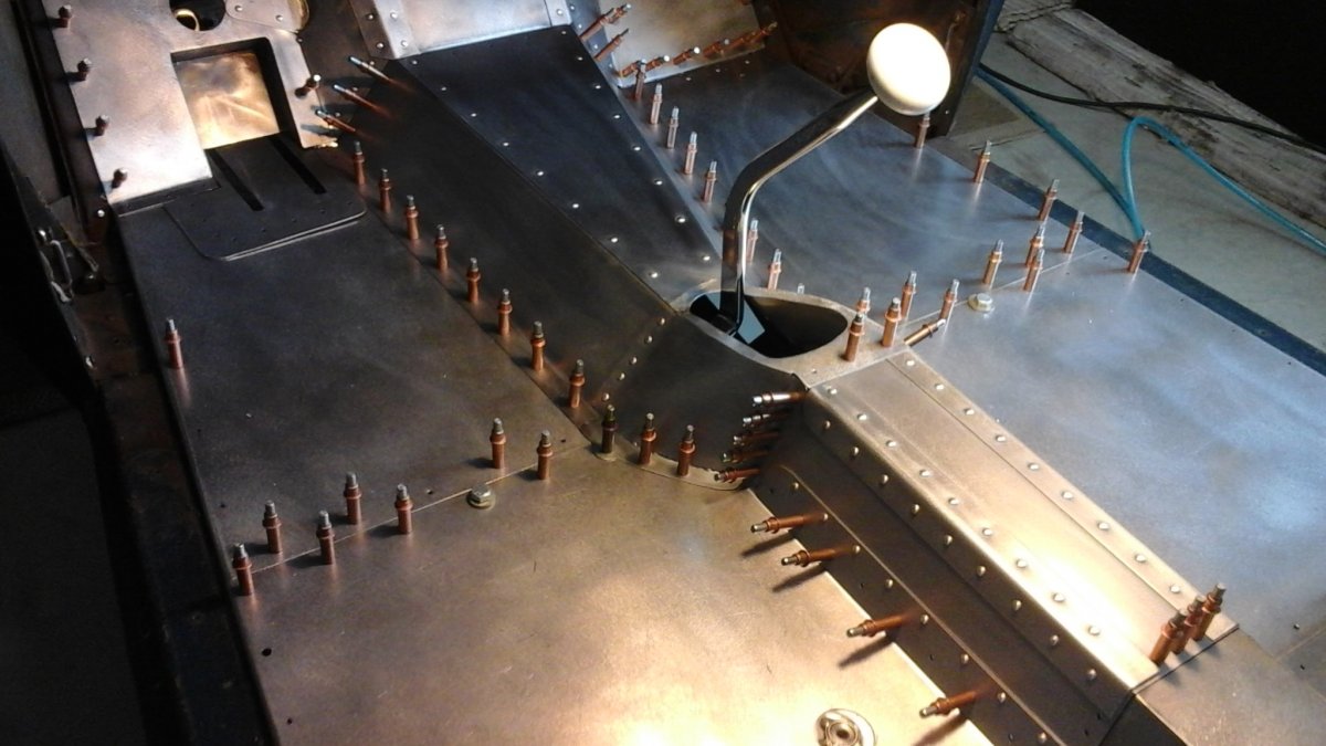

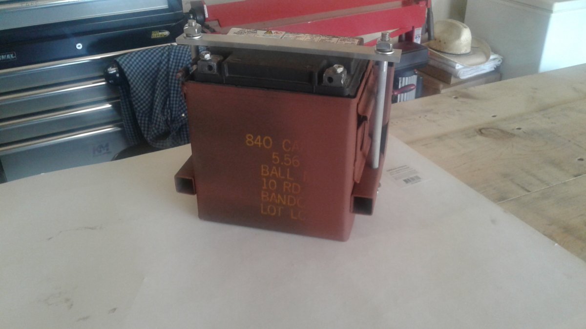

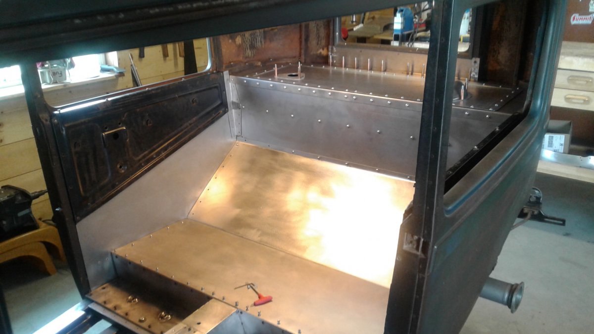

    Shortened up a ammo box for battery and mounted it on frame. Made trap door to get at battery 20170323_151605.jpg 20170324_124549.jpg 20170324_124537.jpg 20170911_143436.jpg 20170925_150657.jpg and finished up rest of floor.

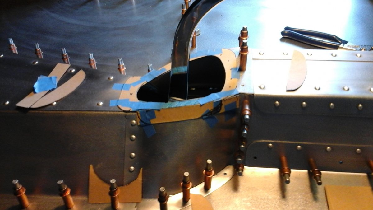

    Nice work. I have a question. Where will the gas pedal be?
    chop job likes this.

    You obviously know what you are doing. Beautiful fabrication on the floors.

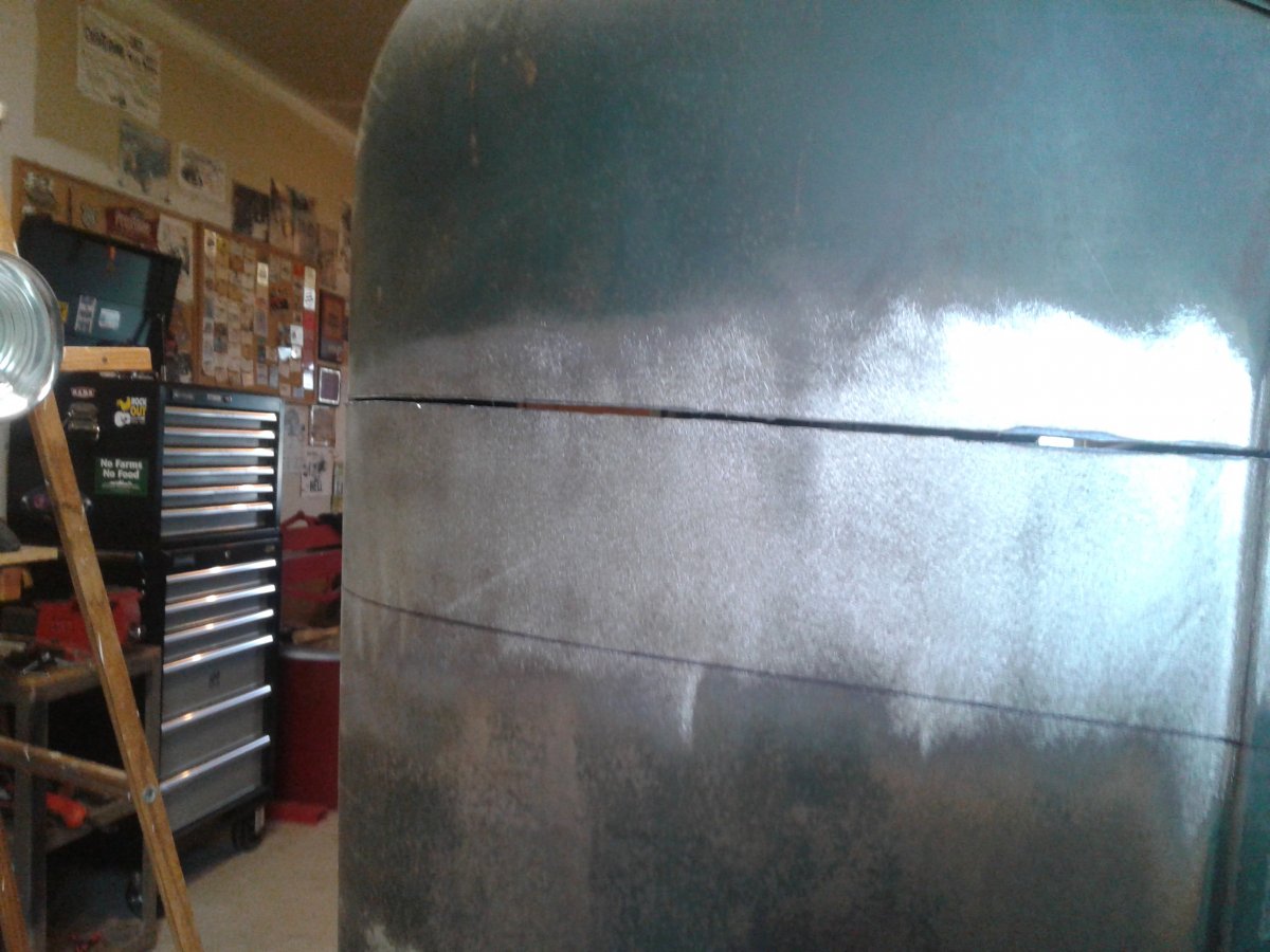

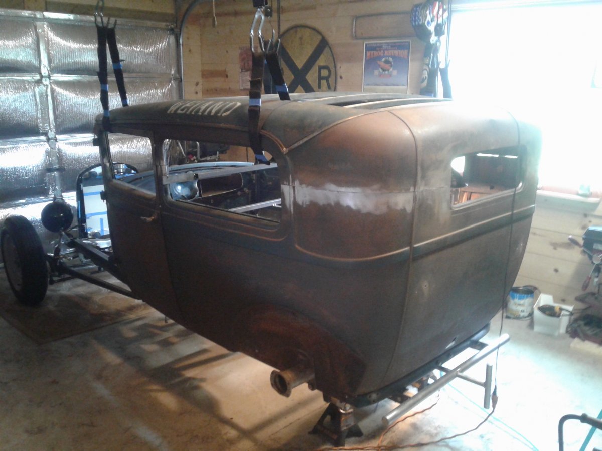

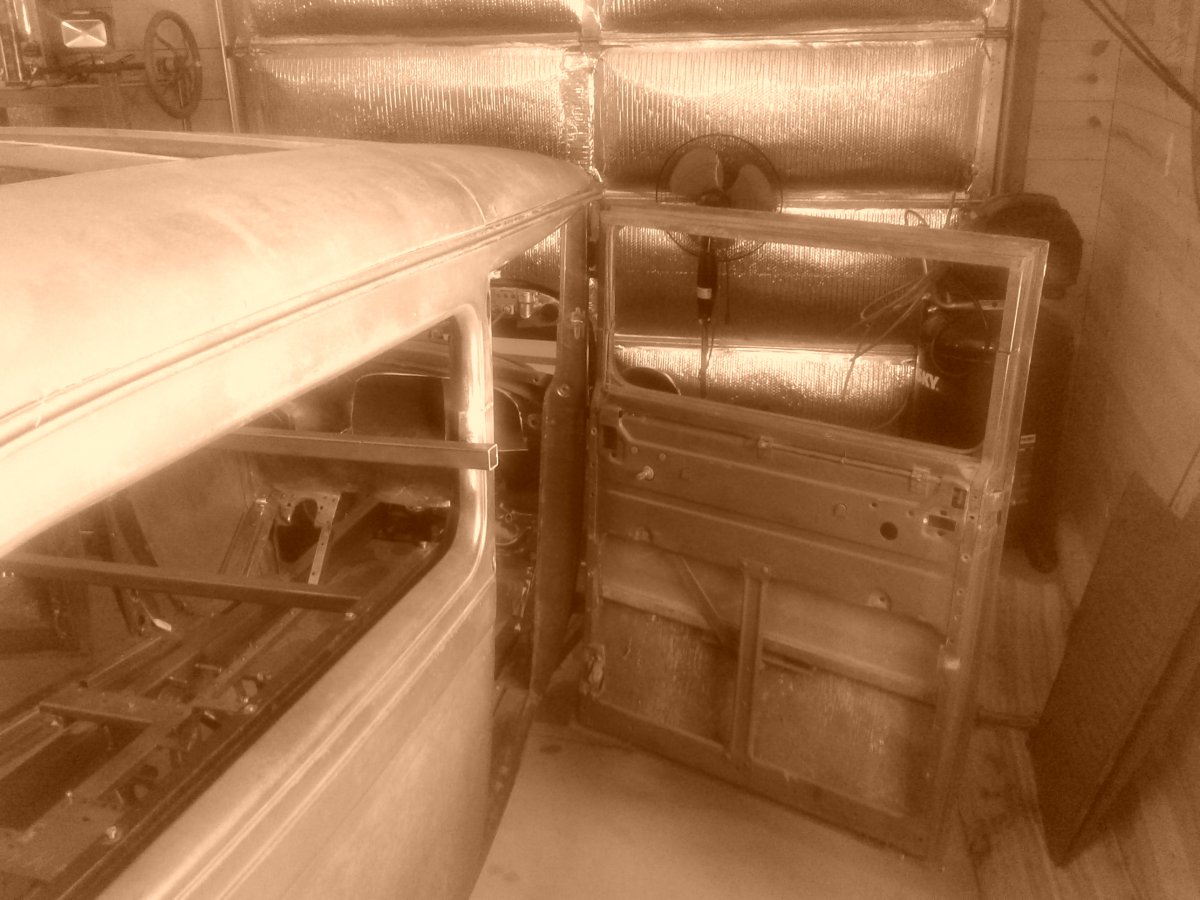

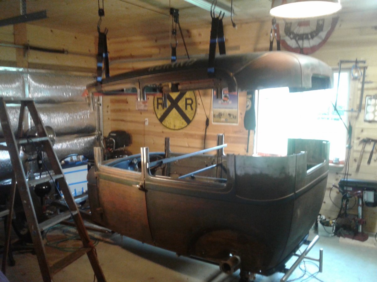

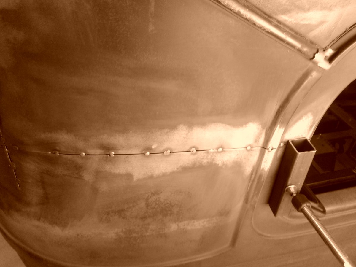

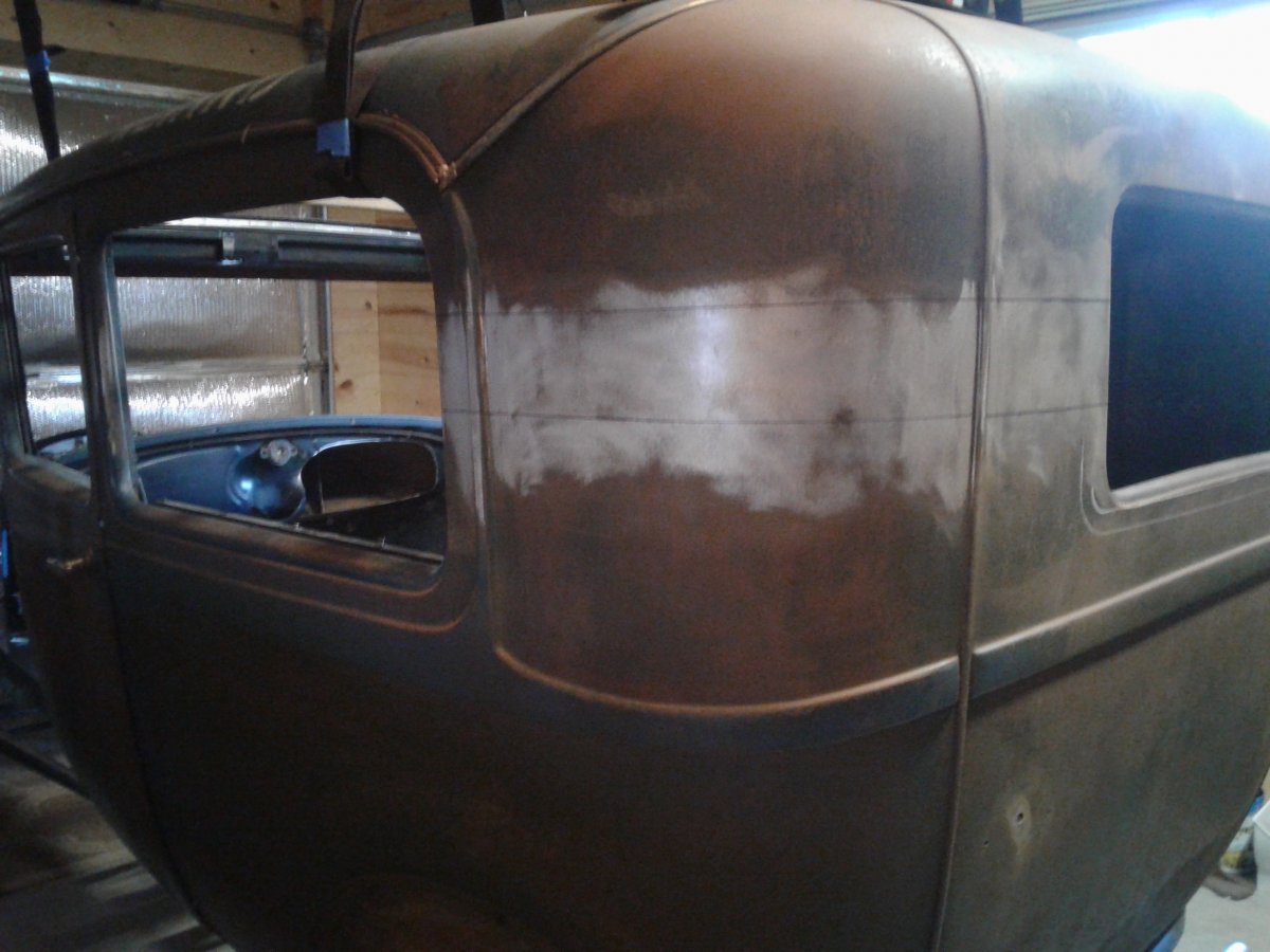

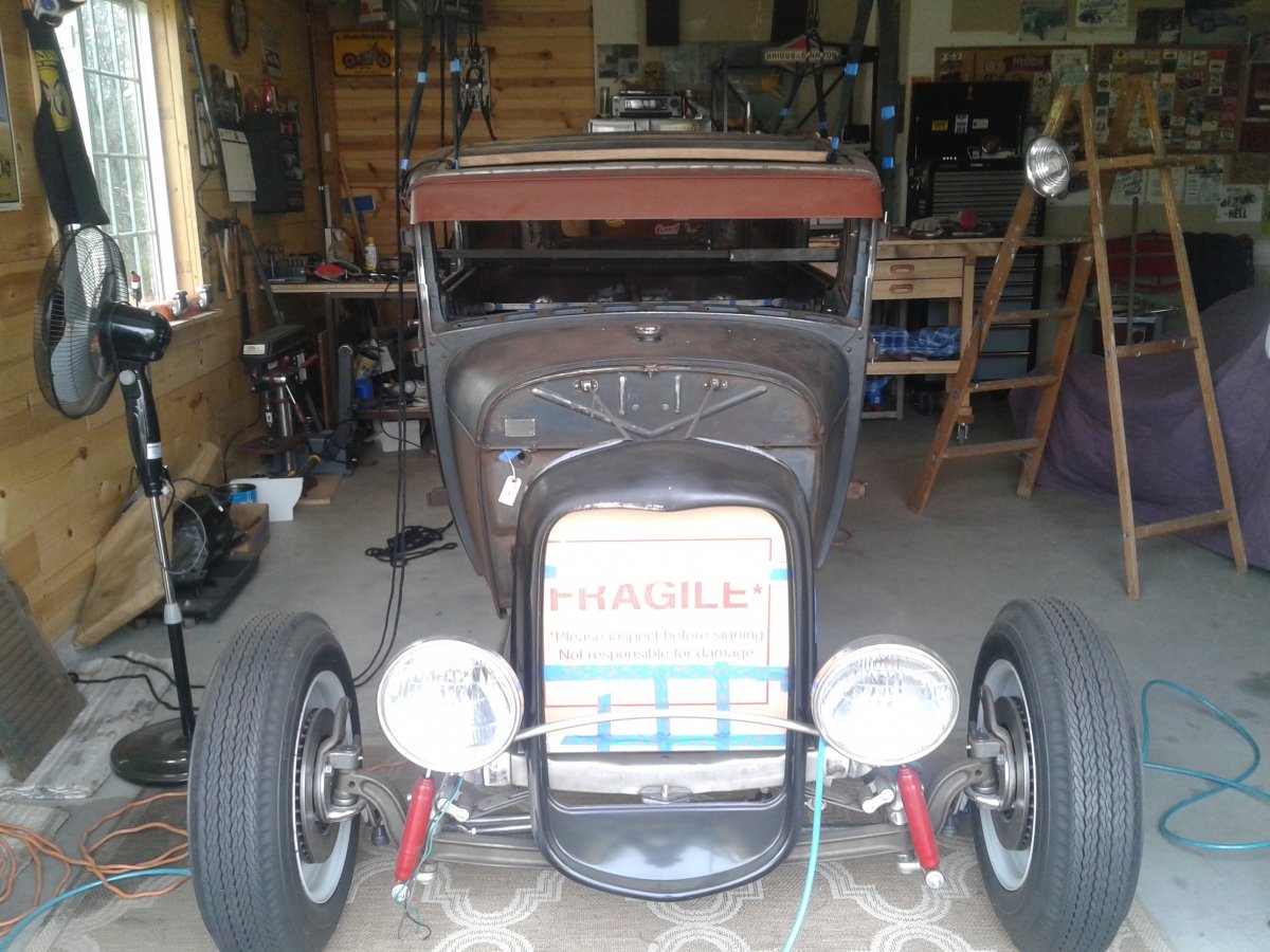

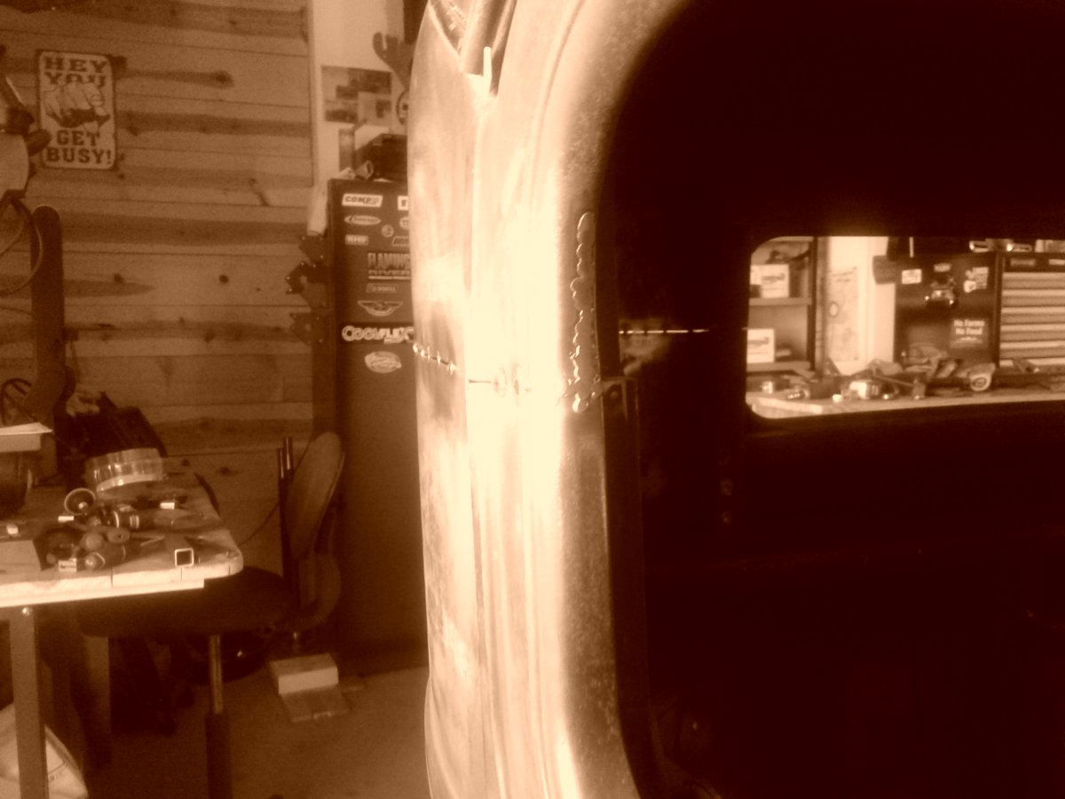

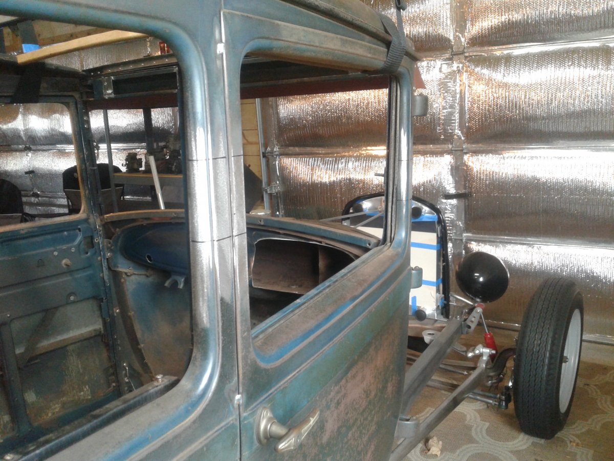

    Started to lay out for a 3 & 1/2 inch chop this will be my first chop. 20171108_155955.jpg 20171109_112652.jpg 20171109_112543.jpg 20171109_112617.jpg 20171111_113556.jpg
    kiwijeff and Stogy like this.

    Very nice work on the floor. I highly doubt you will have a problem with your chop after seeing the detail on your floor :).

    That surprises me. Everything else is well planned out including the notch for the brake pedal. A gas pedal is just as essential and should be in a position to easily use. At this time it looks as though it'll end up being in an awkward location. Other than that as I said Nice Work

    I totally agree with you space is the enemy in this case. Will have to go on top of trans cover.

    Tooth paste is out of the tube.

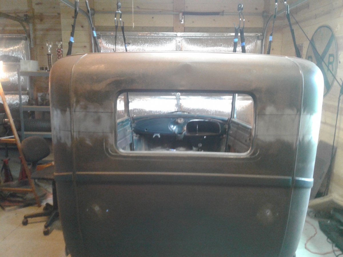

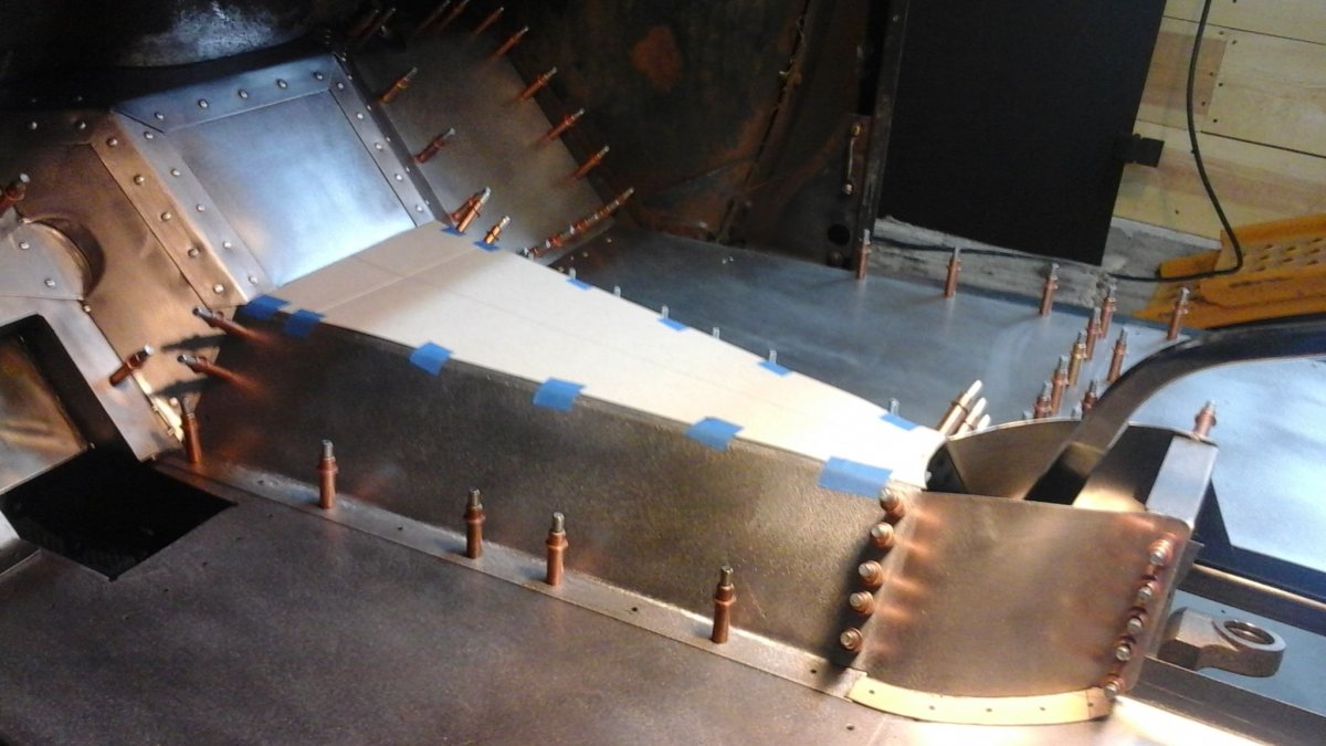

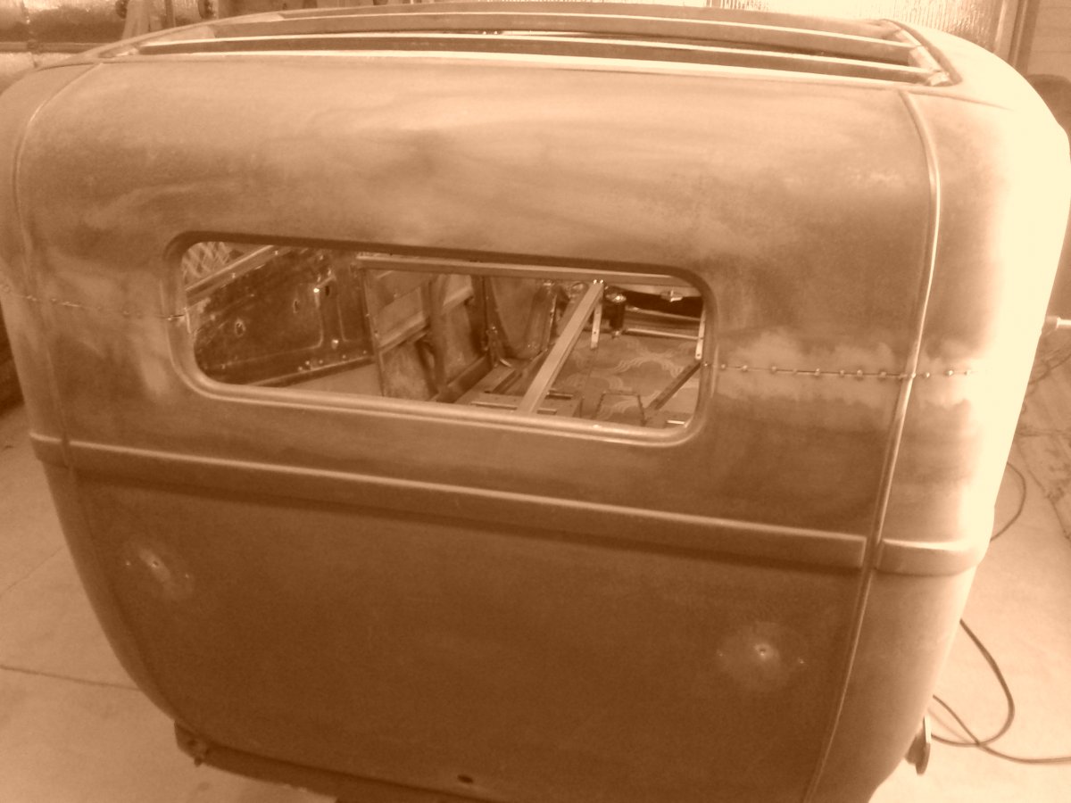

    Started the long progress of tacking and fitting. 20180105_123624.jpg 20180105_123614.jpg 20180108_130656.jpg 20180109_125636.jpg Sliced and diced.
