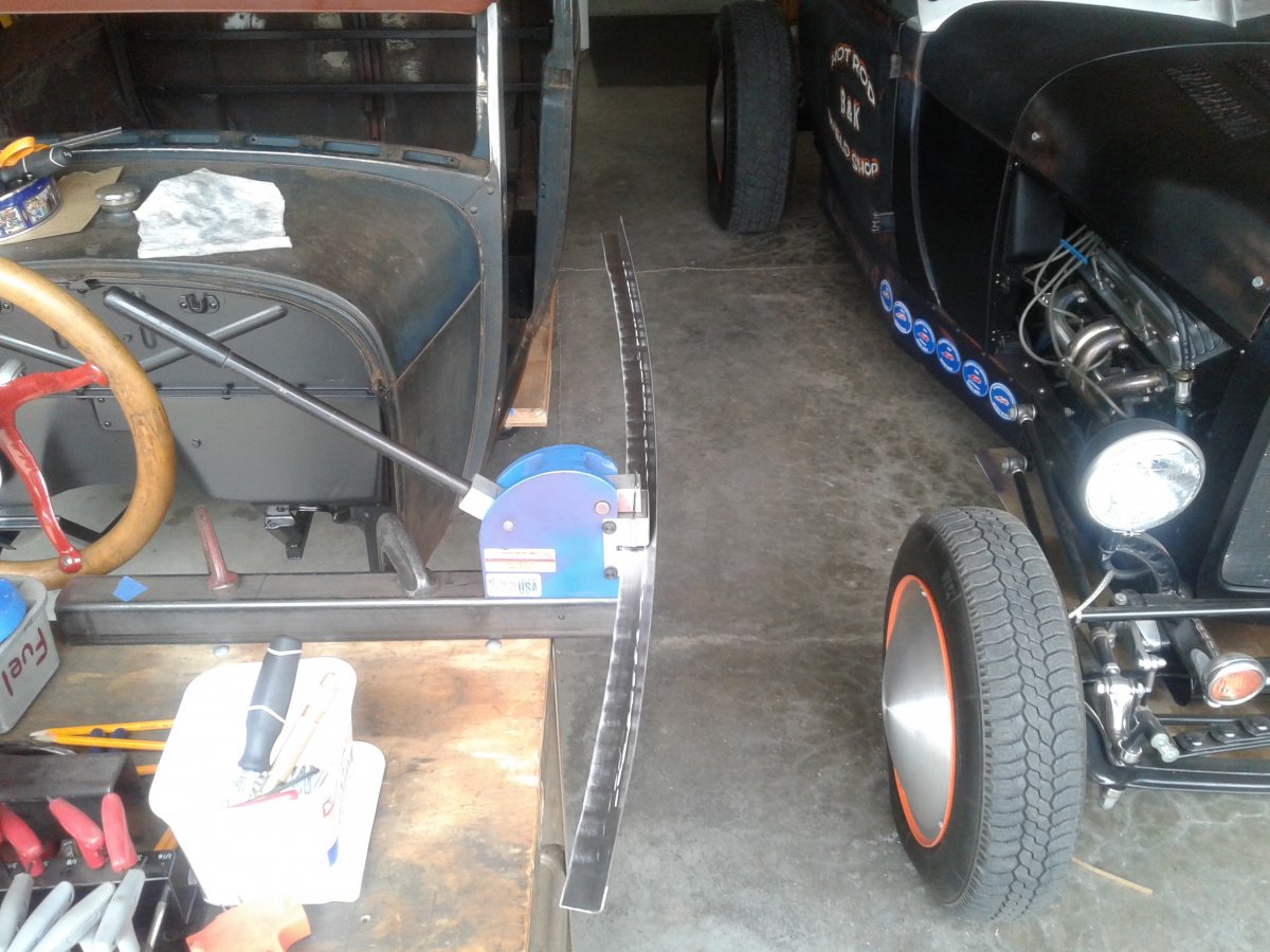

    At it again today made a bow to go between two original bows to join the front sheet to the back sheet YA GOT THAT? It will become clear later I hope. 20180807_085947.jpg 20180807_135754.jpg 20180807_135754.jpg
  7. Stogy
    Joined: Feb 10, 2007
    Posts: 27,523
    Stogy
    chop job likes this.
  8. CURSED GEARS
    Joined: Jul 21, 2016
    Posts: 149
    CURSED GEARS
    Wow. Very surgical. With the rivits, and your avatar, will there be more aviation style through out the build? Your painting with a brush put my spraying with a gun to shame. Keep it up. Oh, and I tried very hard to spot some dirt, or debris on your floor. I could not see any. Wow!

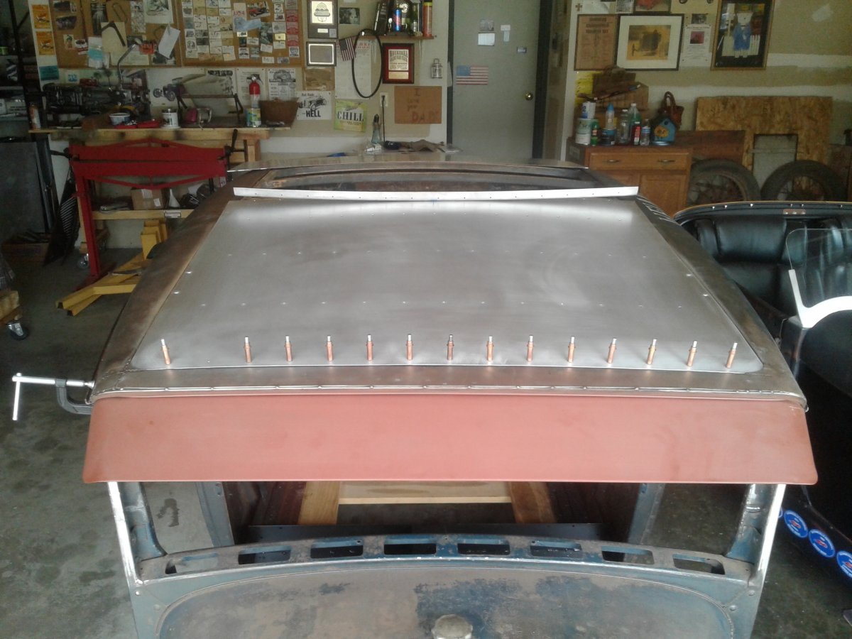

    20180808_130756.jpg Today I started on the rear portion of the top. I can lie and tell you it is easy but you know it isn't. 20180808_113624.jpg
  12. chop job
    Joined: Feb 16, 2013
    Posts: 596
    chop job
    from Wisconsin

  13. Stogy
    Posts: 27,523
    Stogy
    @chop job are you bucking those yourself or do you have a backup? This is what I call an appearance item one slip of the bar or a hit without a bar and the work is damaged. you are doing a fine job. If you doing this all on your own your quite the acrobat. Budda Boom Budda Bing...;)

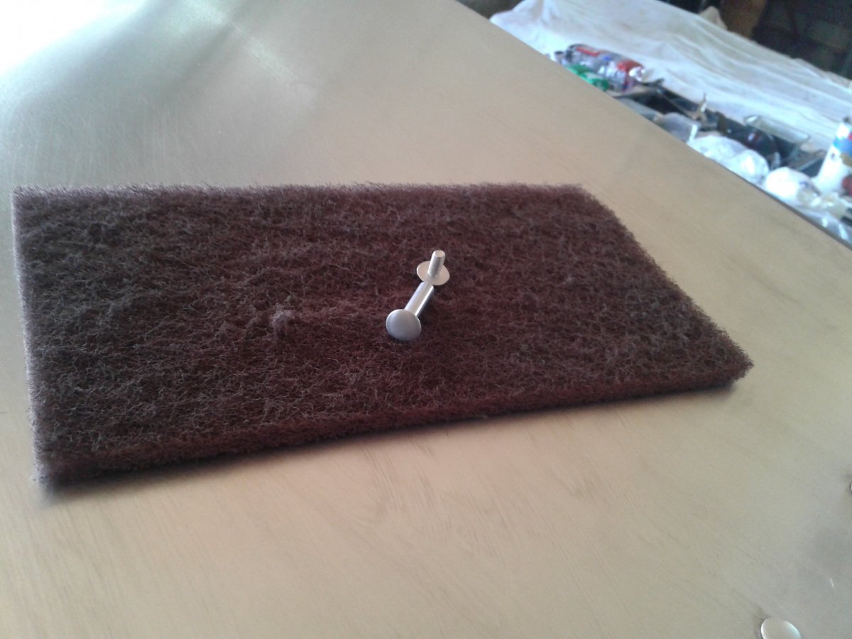

  15. Stogy
    Posts: 27,523
    Stogy
    I've heard of riv-nuts but those are not that...is that a 2 piece Fastener or is that 2 separate fasteners in two diameters. So I'm still curious is that a solid rivet and a collar presses on the other side? I know that is Scotchbrite pad the fasteners are on...
  16. chop job
    Posts: 596
    chop job
    from Wisconsin
    Two piece fastener one screws into the other.

  17. Stogy
    Posts: 27,523
    Stogy
    I can't see the threads so the short ones on the inside?
  18. chop job
    Posts: 596
    chop job
    from Wisconsin
    YES.

  19. Stogy
    Posts: 27,523
    Stogy
    Heard you loud and clear...:D. The top...in fact it's all tying together nicely. Pretty cool fastener. Looks the Rivet part without all the banging. All you have to get right is the pitch and holes and that takes some calculating for sure...enjoying your build @chop job

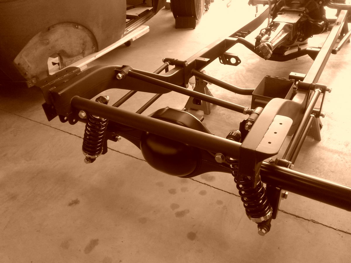

    Took a break from working on the top and started ***embly on the frame. 20180816_115332.jpg

  21. warhorseracing
    Joined: Dec 26, 2006
    Posts: 2,999
    warhorseracing
    from cameron wv
    When I first looked at that picture I thought, "what is he doing welding the back axle to the frame solid for:eek:?" Is he trying to kill his back and build a "hard tail rod:mad:?" Then after the third look I see it is just the rear cross bar;). We will call that an "optical illusion" for you younger folk who would even attempt to call me old!:D

  22. chop job
    Posts: 596
    chop job
    from Wisconsin
    You are right it does look that way never saw it till you mentioned it.

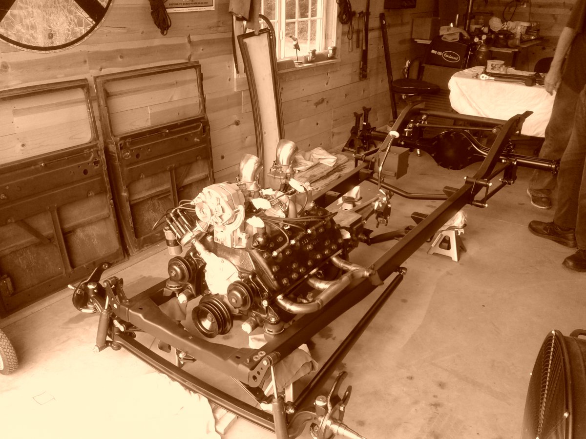

    Had some fun today my brother and I put in the motor. 20180910_125101.jpg 20180910_125038.jpg

  26. Stogy
    Posts: 27,523
    Stogy
    Looking clean and businesslike @chop job...:rolleyes:...just like your shop...;)...and family comradery...priceless.

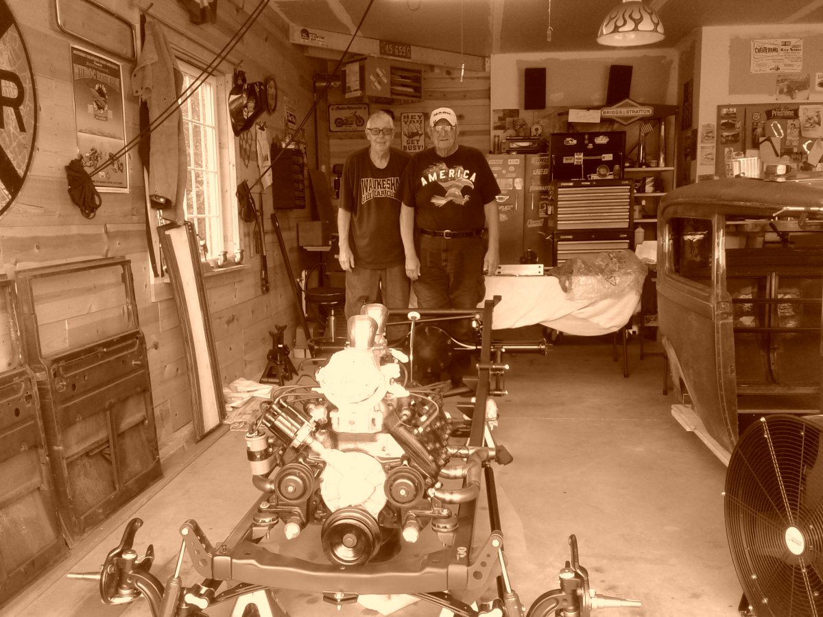

    Having medical issues so thing are slow around the shop THANKS for my brother and very good friend for coming over and doing some ***embly makes me happy. Thank GOD for good friends. 20180925_124054.jpg 20180925_123956.jpg 20180925_123939.jpg
  28. brEad
    Joined: Dec 23, 2016
    Posts: 2,039
    brEad
    Sorry to hear about the medical issues. I agree though - family and friends really coming through when you need them is a great blessing.
    chop job and Stogy like this.
  29. Stogy
    Posts: 27,523
    Stogy
    Wishing you a return to full steam ahead soon @chop job...getting #1 back in order is priority...and your owe a few people a nice ride in the Hotrod once she's done...;)

  30. alwaysamopar
    Joined: Oct 2, 2015
    Posts: 126
    alwaysamopar
    That's a great picture of you guys together there! My brother and I work on projects together and I saw us in your picture. Really cool
