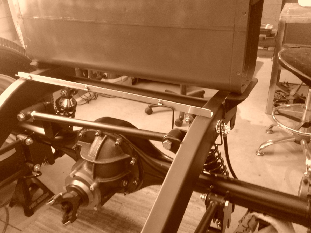

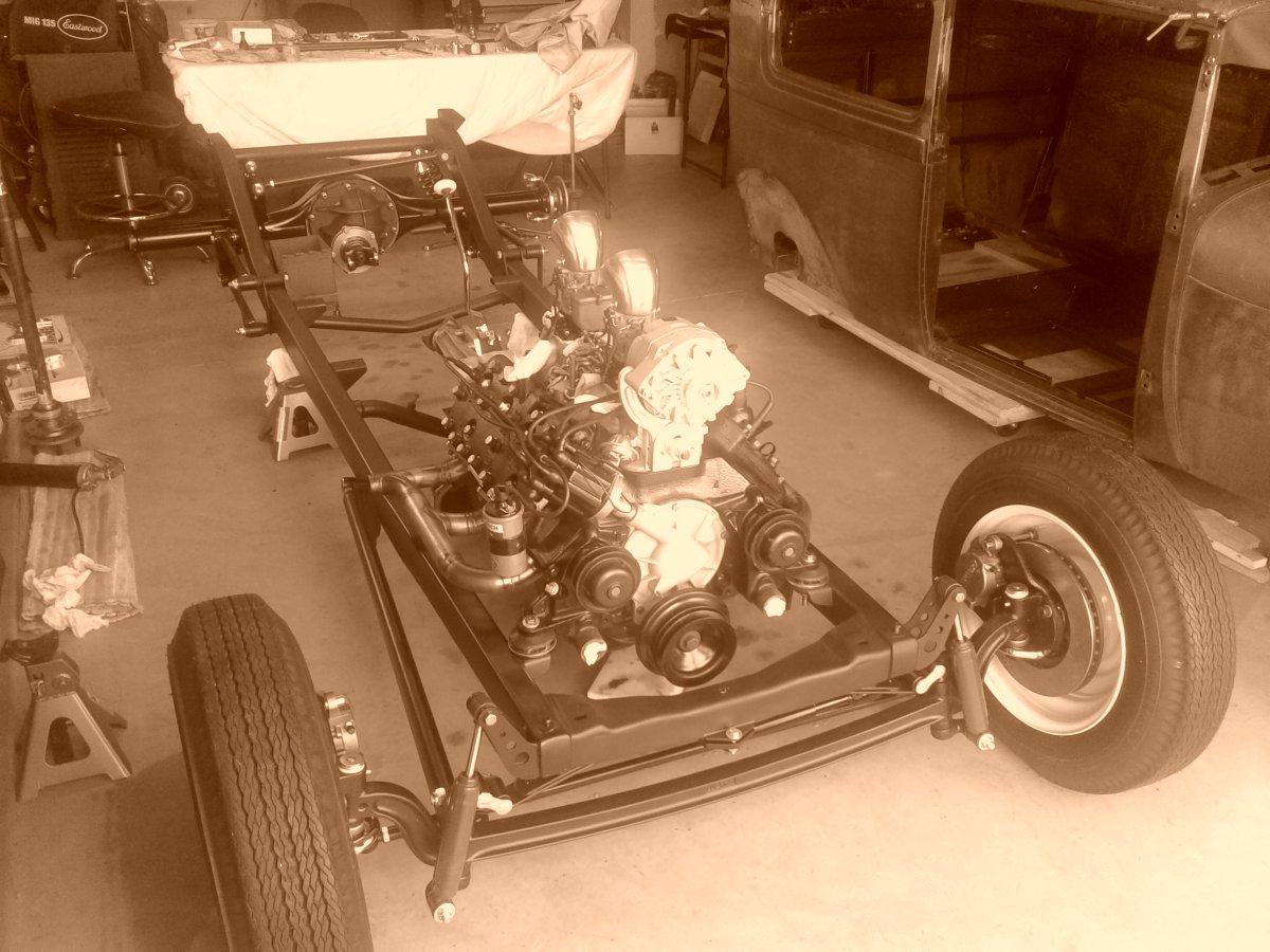

    Brakes are on tires mounted and I'm loving it. 20181031_125243.jpg 20181031_124843.jpg 20181031_124832.jpg

  7. brEad
    Joined: Dec 23, 2016
    Posts: 2,039
    brEad
    Love the car so far. Wheels look great!

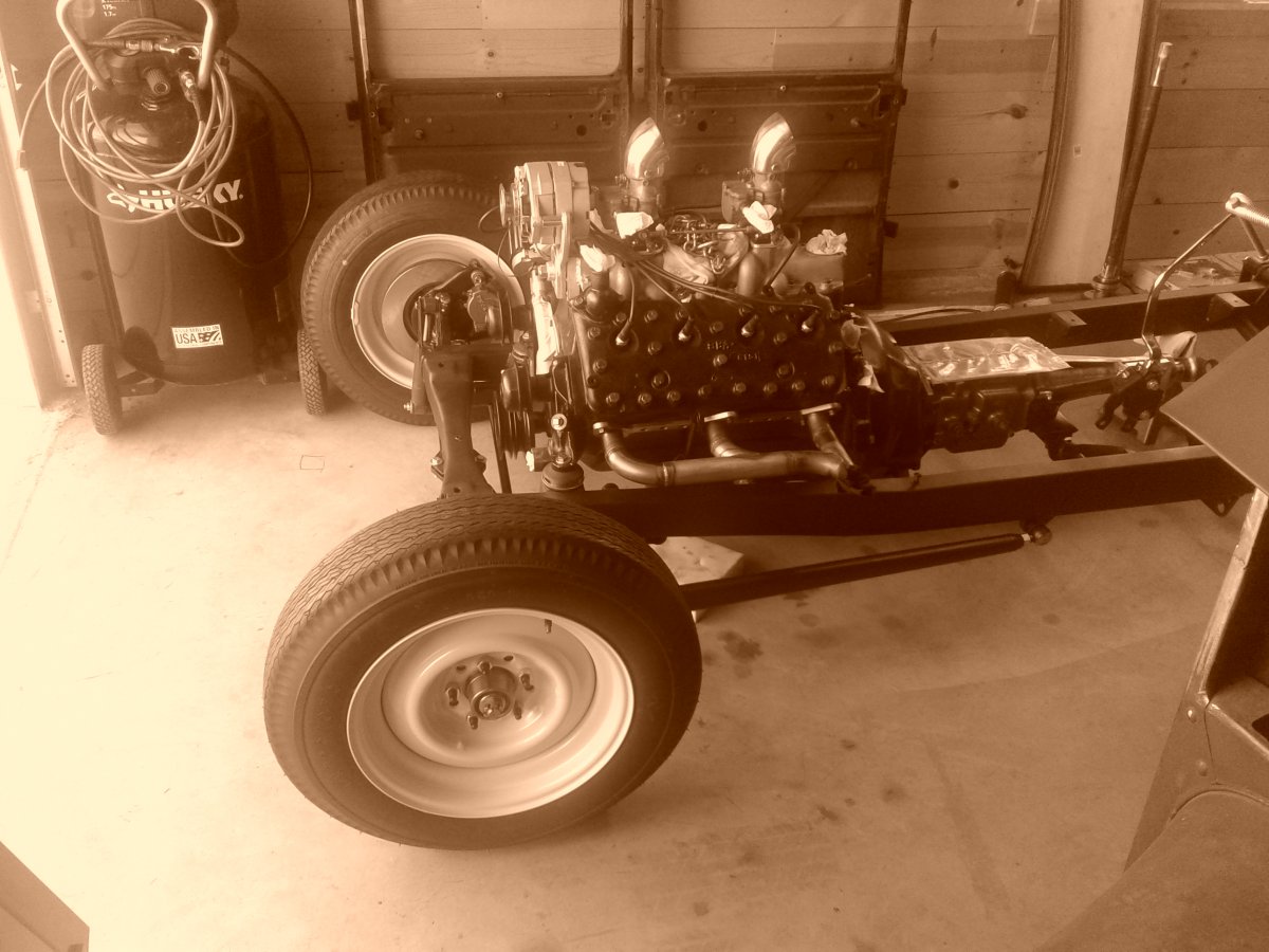

    20181109_110023.jpg 20181109_105943.jpg 20181109_074057.jpg A little snow here today but warm in the shop.

    Did some work on shifter to keep it from hitting my leg when shifting. Added the linkage. 20181114_143941.jpg 20181115_165816.jpg 20181203_154638.jpg

  18. Atwater Mike
    Joined: May 31, 2002
    Posts: 11,618
    Atwater Mike
    Wow...the Ol' shifter interference. I'm using the same transmission, Ford 3 speed.
    I never liked the 'side-shifter' putting the stick on 'my side'... so, this time (and this transmission) I took it on the 'low side', (easy way out) and omitted the inner shift forks, then simply bolted a Jeep 150 tower with 'big center stick' on top. Makes it like a 'short-throw' '39 Ford box. Best of BOTH worlds... Jeep wreckers have this setup, usually $75-$100, including the stick. (and knob, but we tend to choose hot rod types)
    A 'REAL floor shift'.
    tomschev2 and chop job like this.

    Back at work 9n brake and gas lines. 20190312_095425.jpg 20190312_095425.jpg 20190312_095418.jpg
