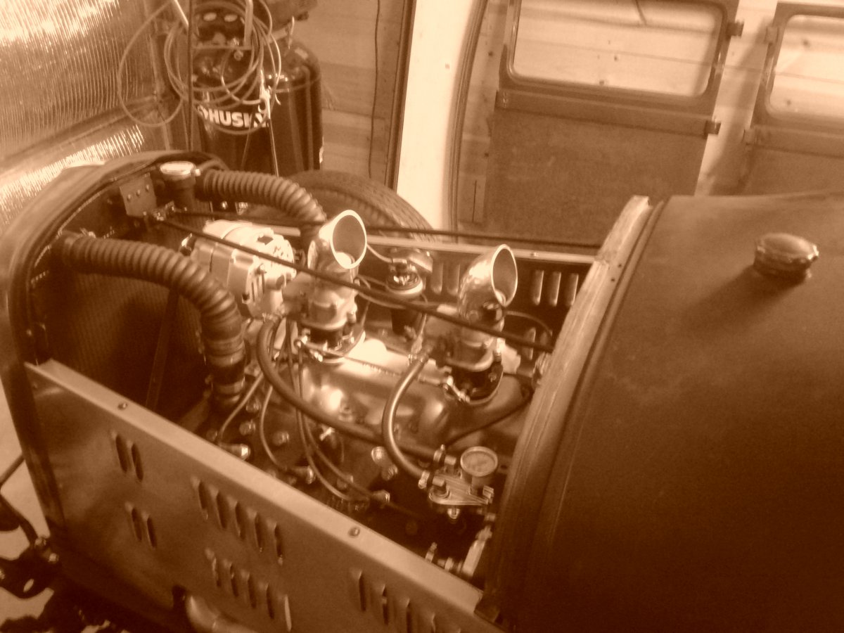

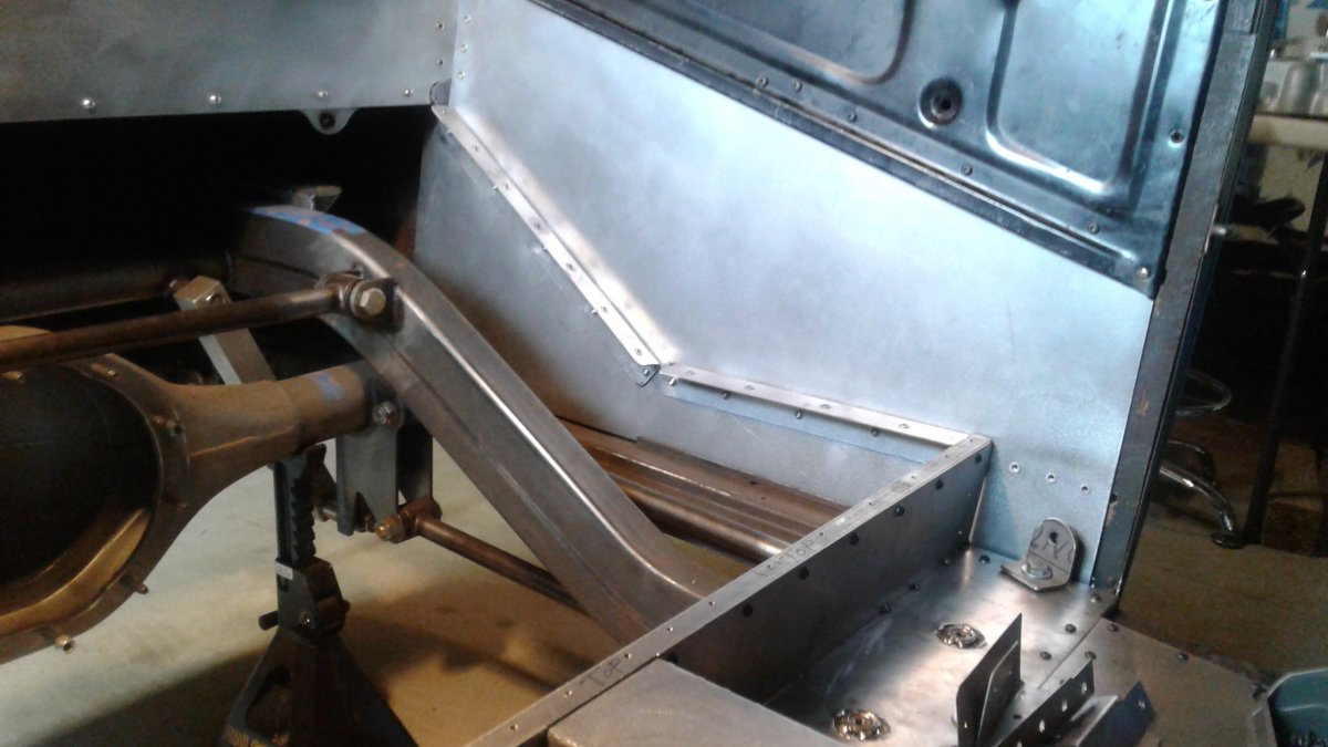

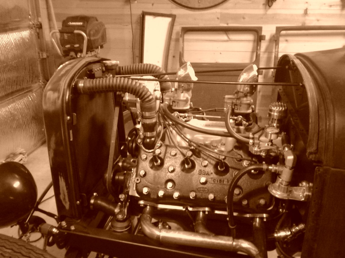

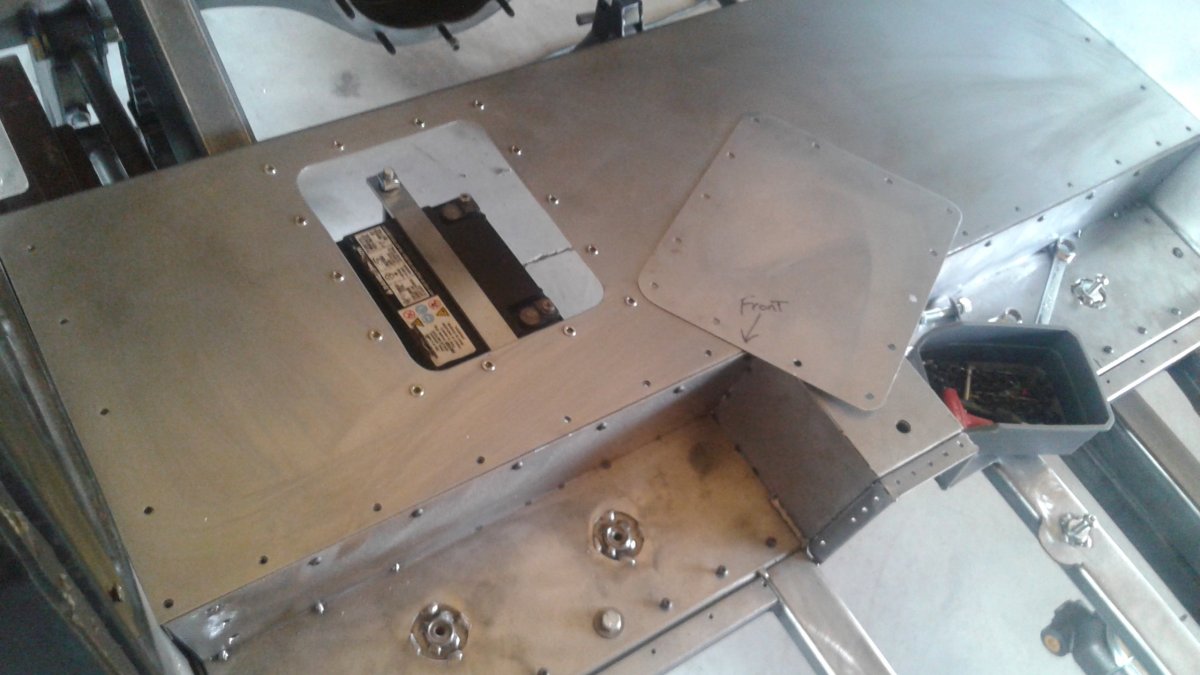

    Back at it working on the front of car from headlights to firewall . Mounting coil to have room for hood side panels and adding radiator hoses. 20191213_113052.jpg 20191216_122214.jpg 20191216_122245.jpg

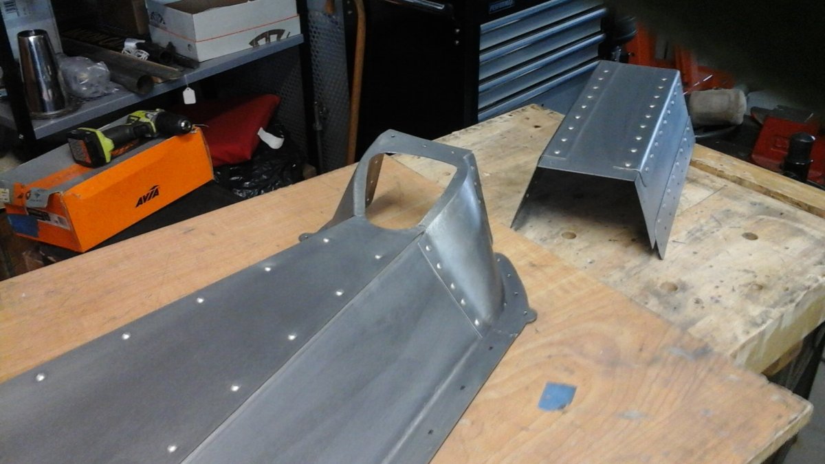

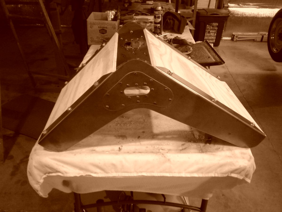

    Started to make hood side templates today so far so good. 20200106_153042.jpg 20200106_152832.jpg 20200106_153535.jpg
    Tim, Lil'Alb, Stogy and 2 others like this.

    Opened up area around header a little more then transferred to alum and presto. 20200109_154150.jpg 20200109_154214.jpg 20200109_154225.jpg
    osage orange, Stogy and brEad like this.

    What size/specifications on aluminum & how many where flanged? Please, thank u
    Stogy likes this.

    Alum is 5052 and the top will have 90 degree bend to set 9n top of a 1x1 tube. I hope this answers your questions.
    Stogy and AmishMike like this.

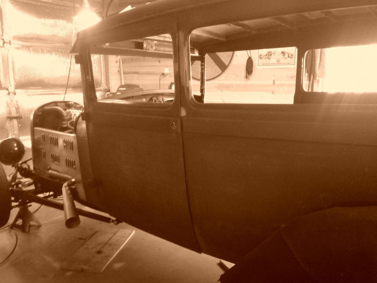

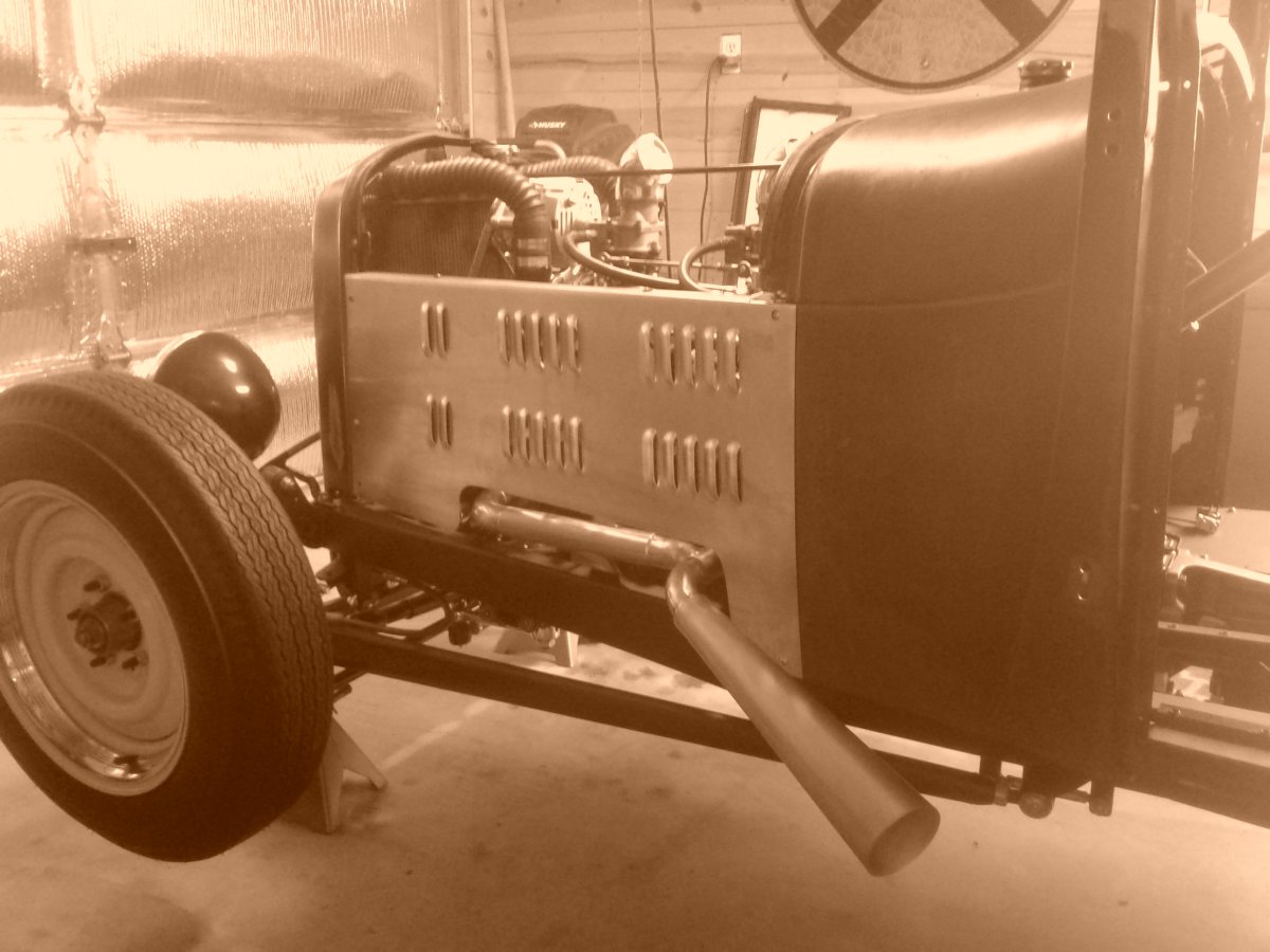

    Had some help from my brother and friends the other night to punch some lovers. 20200123_184232.jpg 20200125_113141.jpg 20200125_120136.jpg 20200125_120501.jpg 20200125_120630.jpg
    Tim, Lil'Alb, bymanr and 5 others like this.

    Louvers look real good! Reminds me of the Ray Brown deuce roadster hood.
    Stogy likes this.

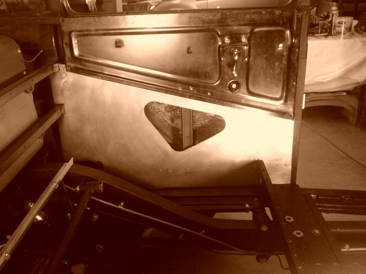

    Had to add a hole to install window. 20200208_115216.jpg 20200208_122430.jpg
    Stogy likes this.

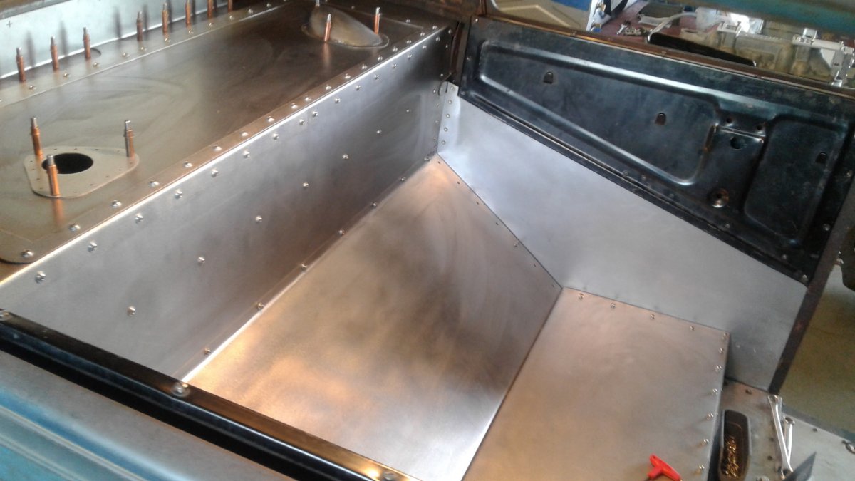

  24. chop job
    Joined: Feb 16, 2013
    Posts: 596
    chop job
    from Wisconsin

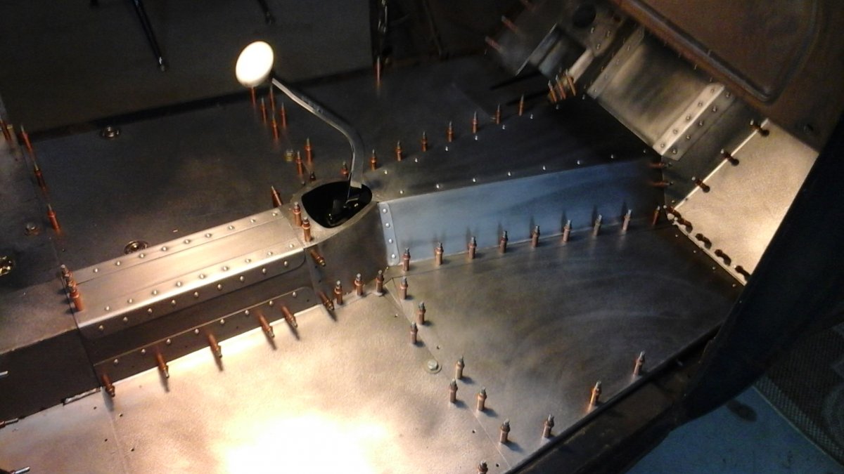

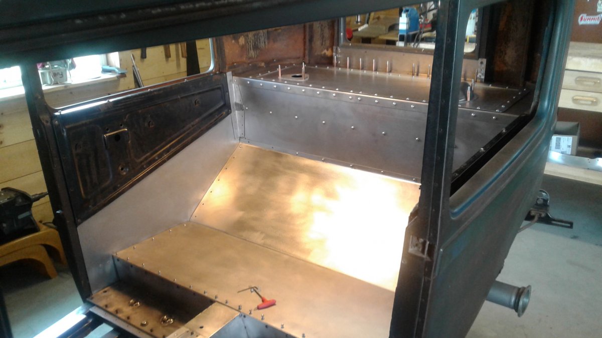

    Found out I had to move my seat back so out came the cut off wheel and two days of work to reconstruct the floor. 6 foot 5 needs more room than normal. 20200220_114135.jpg 20200220_113645.jpg 20200219_151438.jpg
    brEad and bymanr like this.

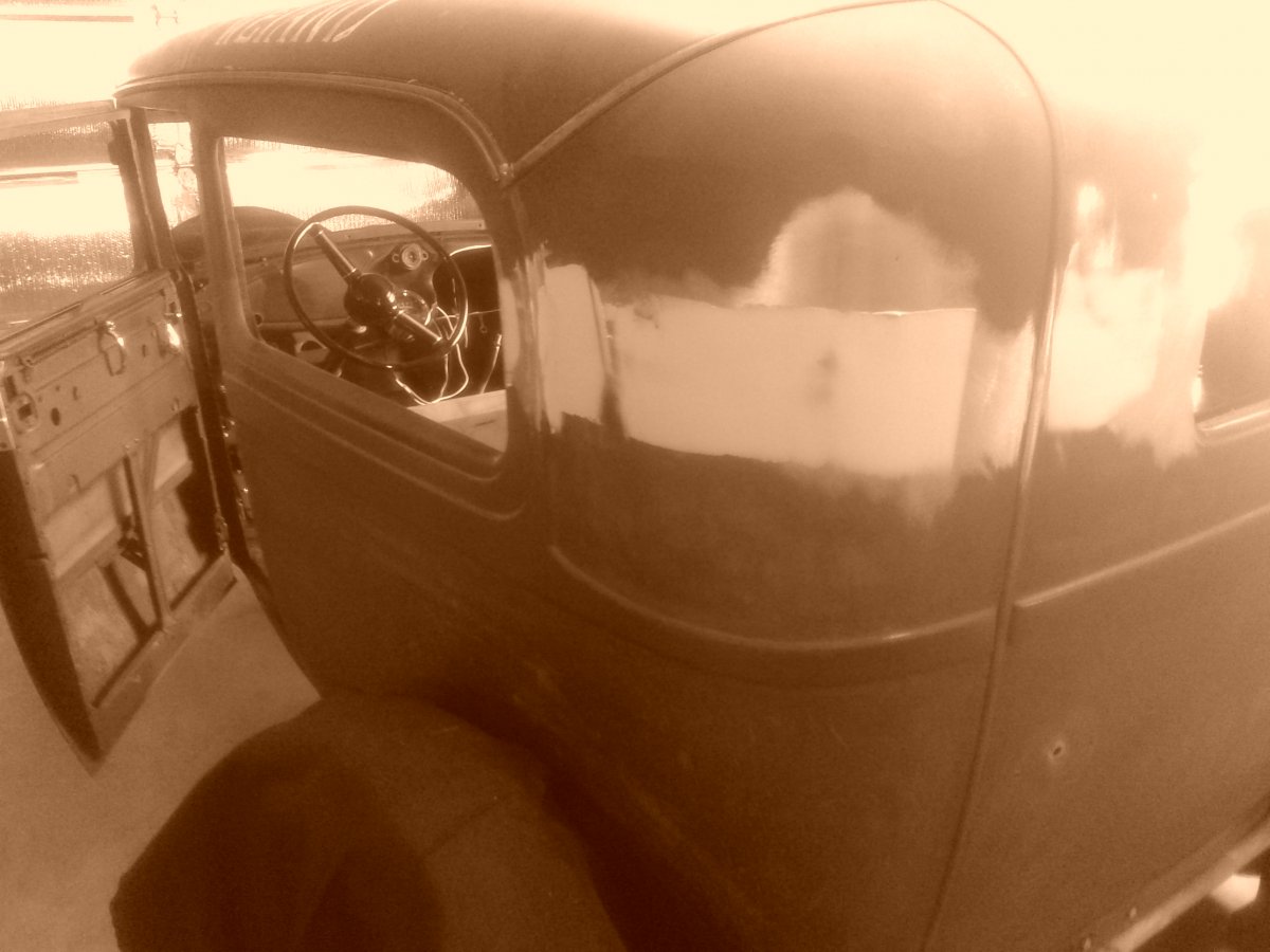

  28. chop job
    Posts: 596
    chop job
    from Wisconsin

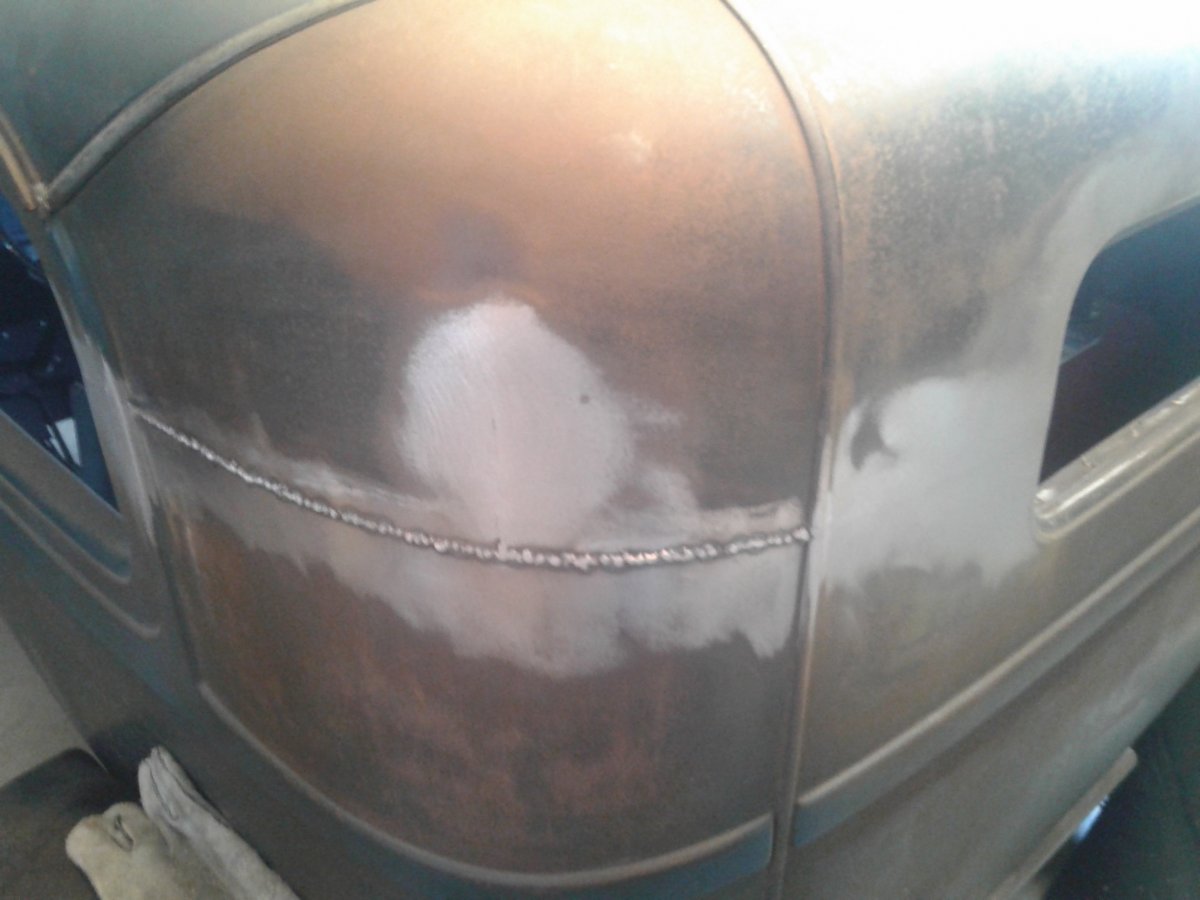

    Never did much body work before so this is a real learning experience. Everything is easy if you follow the instructions RIGHT? SO far so good. 20200228_105314.jpg 20200228_173718.jpg 20200304_102256.jpg
    Tim, Stogy, Lil'Alb and 2 others like this.

  30. vtwhead
    Joined: Oct 20, 2008
    Posts: 5,317
    vtwhead
    don't forget the mask when sanding:rolleyes:
    Stogy and chop job like this.
