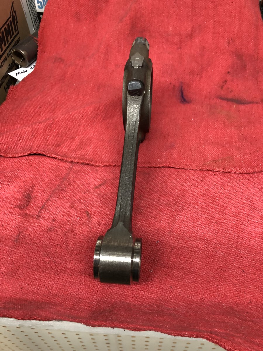

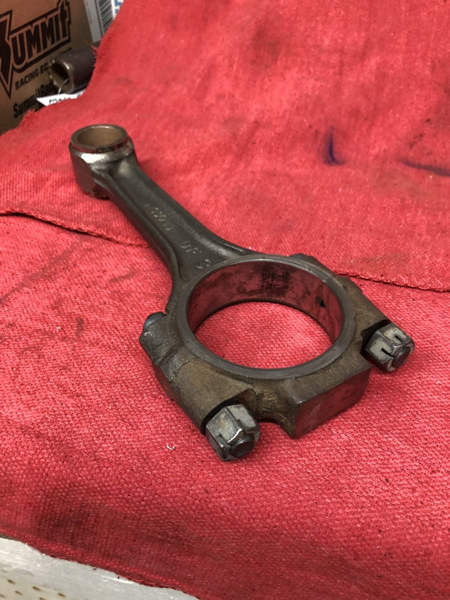

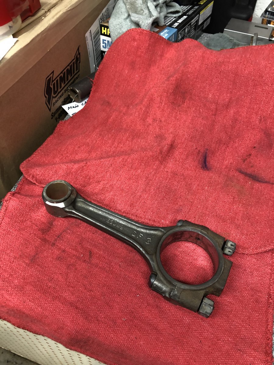

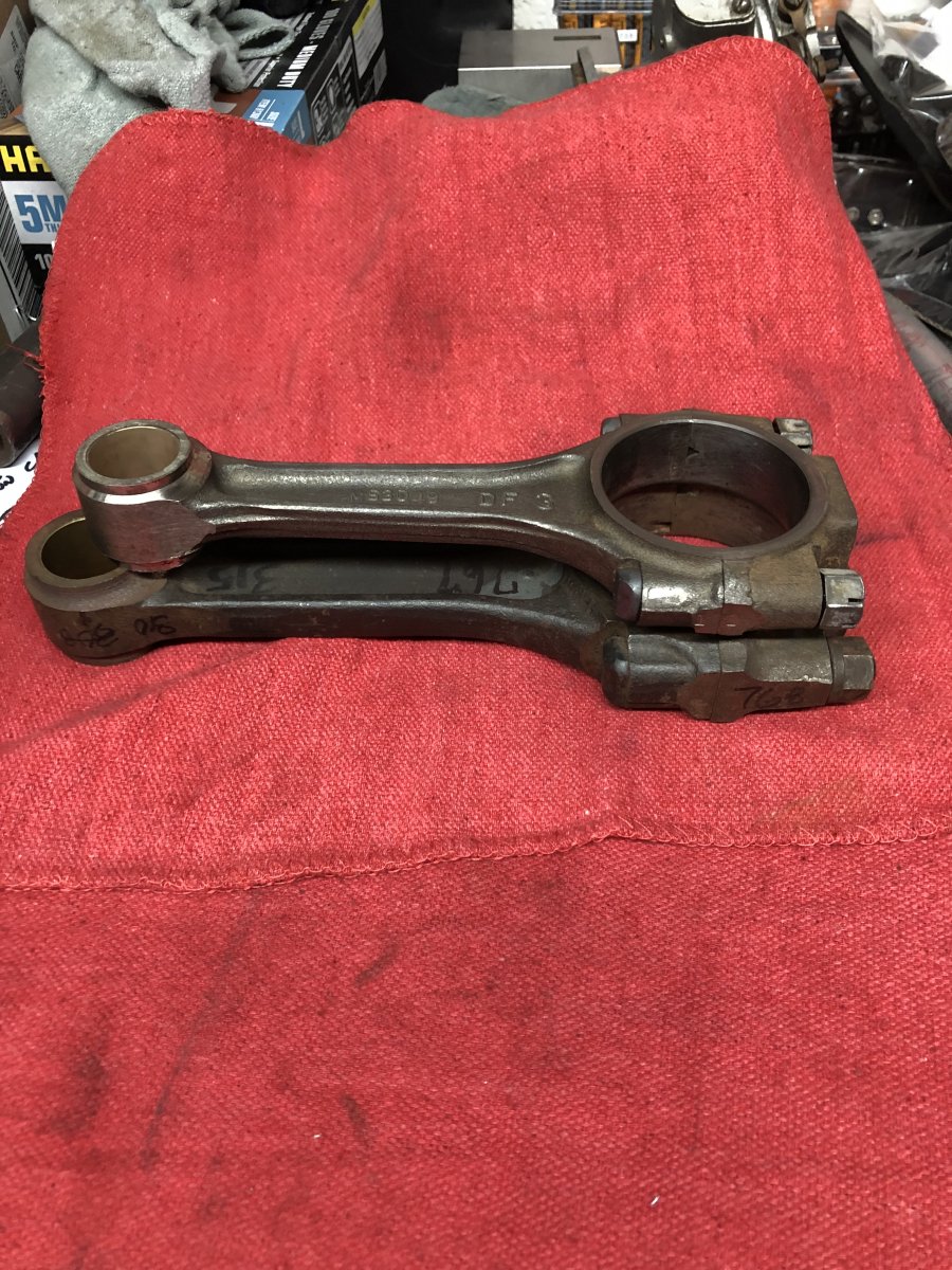

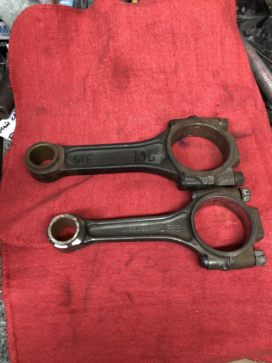

  2. Oh yeah,,,here are some pics of one of the rods laying next to it’s big cousin 426!
    They are even machined the same way around the pin boss,,,and the beam is forged the same shape.
    I guess if it isn’t broke,,,don’t fix it,,,Lol.
