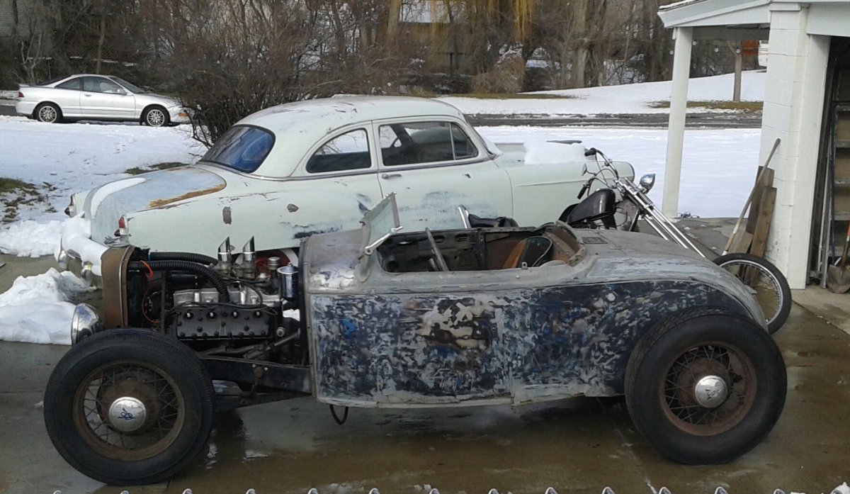

    20160109_141448.jpg 20151231_163347.jpg 20151231_163307.jpg Well I have been busy with my little family so not much time in the garage. But I did get the brakes completed new lines ran. As well as half my floor built and sunk in I will post more picks later. Still not sure about the wheel base yet. Here's a couple more shots!

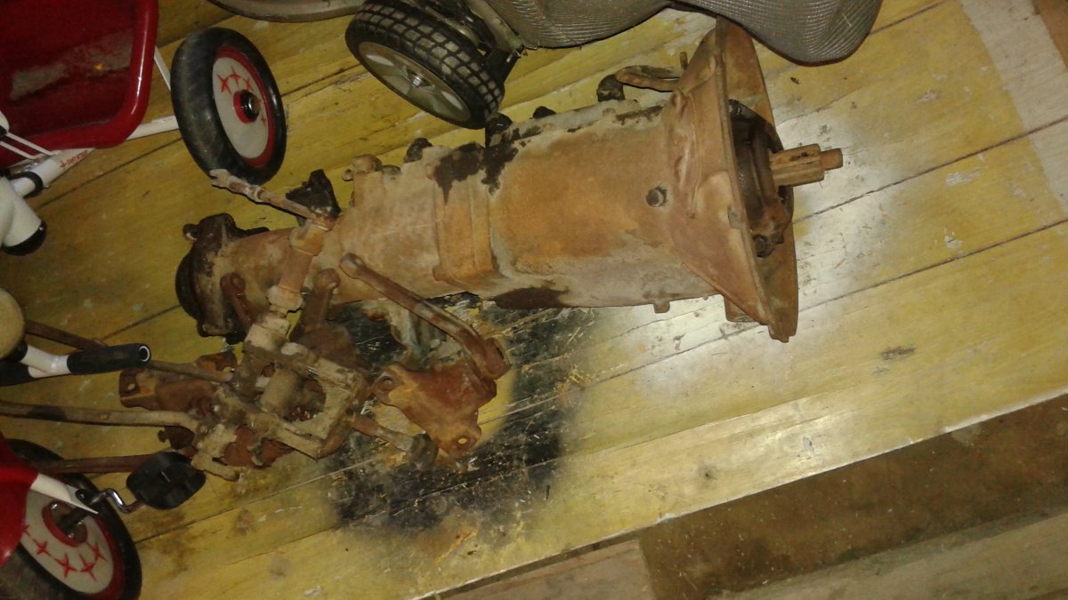

    20151114_170313.jpg 20160109_140951.jpg I also picked up this gem and parted it out stoked on the Lincoln OD and the rest of the goodies!

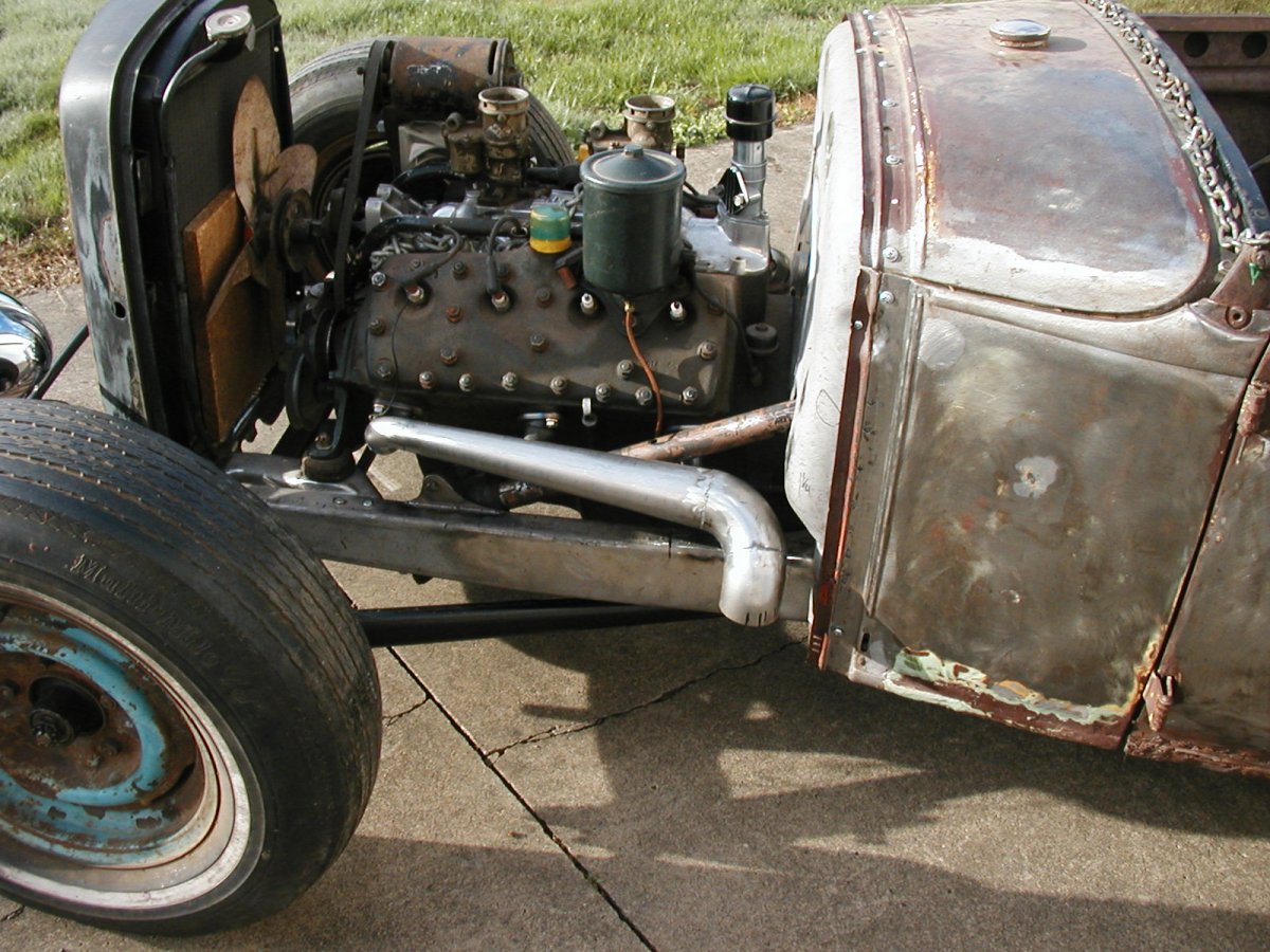

    Here is an idea on the hood. I really like this car.

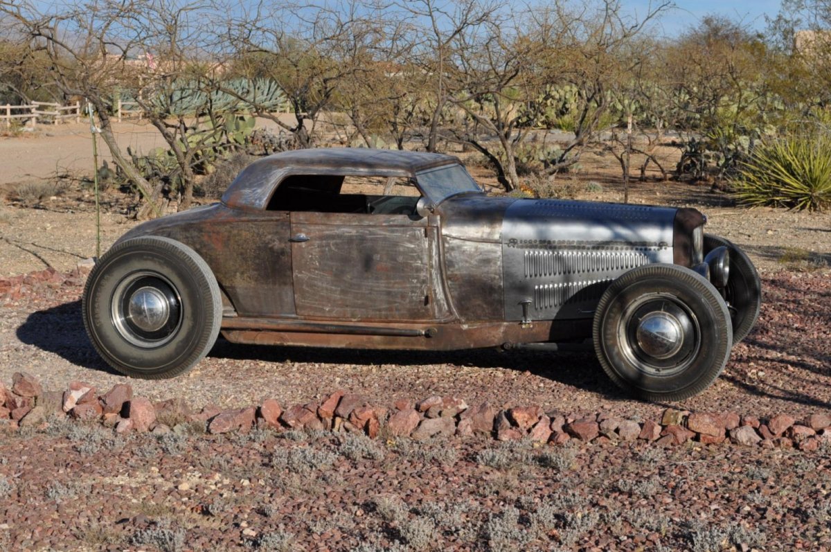

    Another picture from the front.

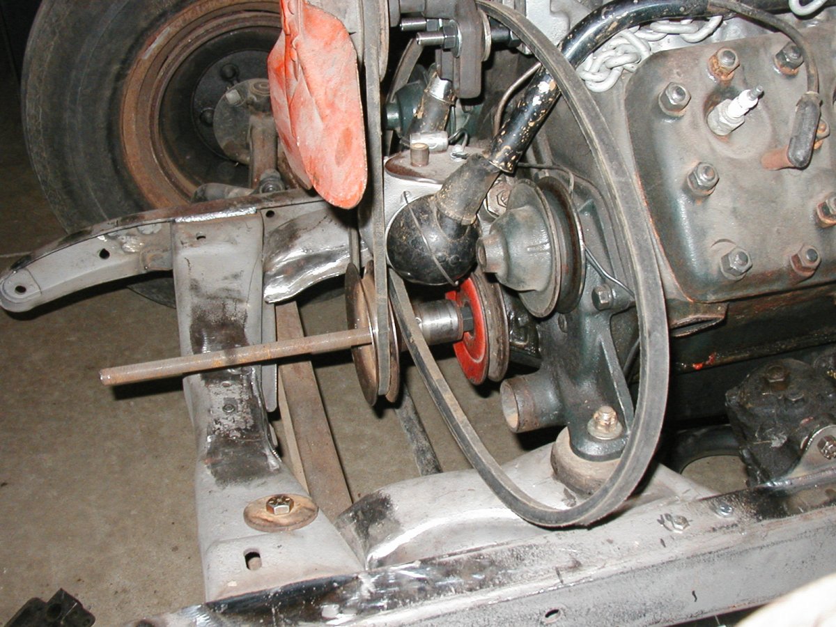

  25. Not sure if your aware of the New version of my Old Channeled roadster or not. It will run a manual Fan and no it wasn't easy, but you can do it. I'll actually try to help if needed. Anything to get rid of that Damn Thing! Here are a few photos. My #1 goal is to make things look like they are stock parts. It's a receint project so I still remember what I did,,kinda. My motor presented a issue of it's own. It ended up being a 38 motor with Odd crankshaft end. It runs a Helmet style dist. (another issue) both belts are wide belts (erra correct) and everything clears. Fan is 1" behind Rad. I actually used pulleys from Ford and built my own arbor to get spacing I needed. Here is a few photos so you can see what I'm talking about. I still need to actually mount the fan to manifold but it's all there.

  29. Took me a little while to find these. Just to see mock up for belt spacing prior to making new arbor for pulleys. You may not have this much to do. Fan is driven off Crankshaft direct.
    A crab style Dist. would have helped out a Ton.
