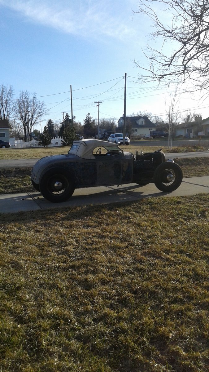

    Lol I hate selfies but felt it was the only way to get the full effect. Next time I will give a smile.
    That's what we call to lazy to tighten lol

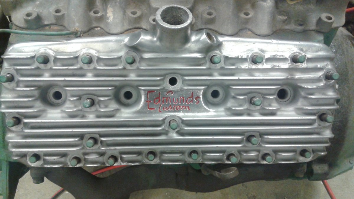

    20160217_001637.jpg Scored some sweet Edmunds heads for the roadster today! Couple pits to fix due to some erosion but they are in way better shape then my Evans I have been tigging up. Just set them on on of the Flattys in the garage I won't even have to change studs! Anyone know what it will bump my compression to? Not much info on them.

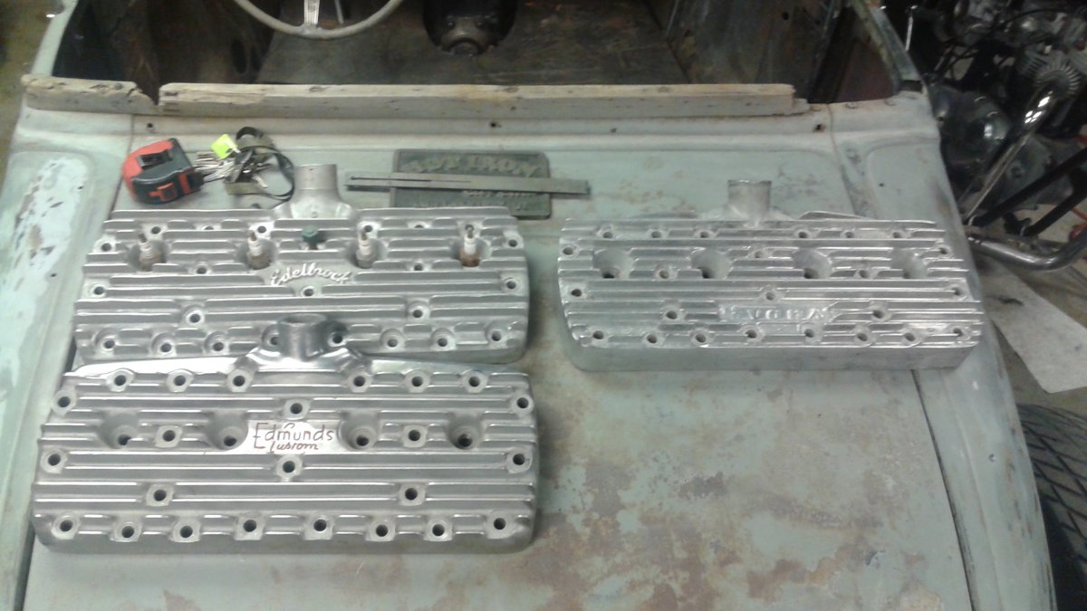

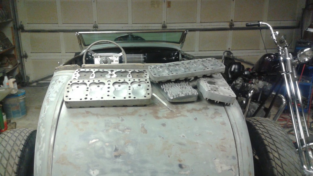

    20160217_001521.jpg 20160217_001912.jpg Due to the fact I am on a tight budget with everything I am gauging on which set will get fixed and stay and which ones to sale. I tend to buy the ones no one wants and spend some time fixing them then buying better ones. Pretty sure that's how most of us do it on here. I've watched my dad do it my whole life!

  6. Put a Spark Plug in a hole and turn the head upside down and C.C. that chamber. Now repeat on a Stock head off the motor. Then go to your local Machine Shop for the formula. That's the only way I know of for sure. You have to know the Chamber size. Lucky for me I have a West Coast Ledgand close by for all that stuff.

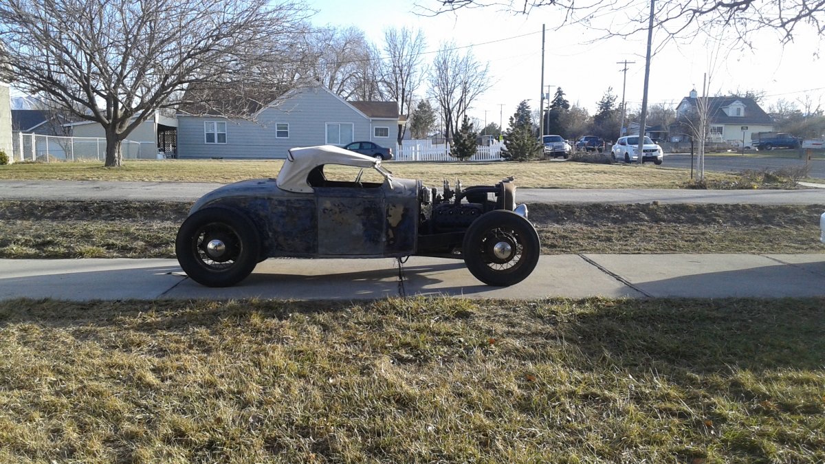

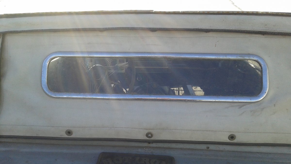

    20160219_164437.jpg 20160219_165200-1.jpg 20160219_164749.jpg 20160219_164724.jpg Set the top on to get an idea of getting into the old car. And to see if I needed to sew the last couple tears on the car so it's some what tight when I see it.

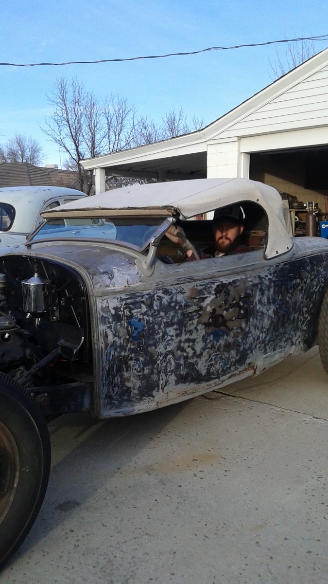

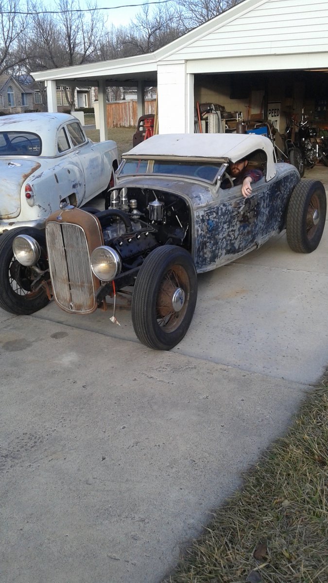

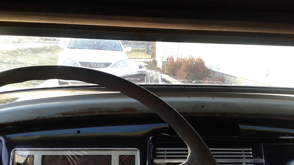

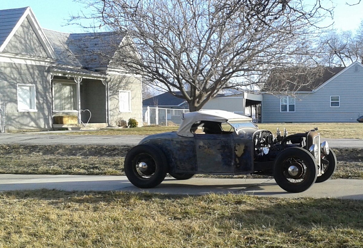

    20160219_170506.jpg 20160219_171501.jpg 20160219_171438.jpg 20160219_170601.jpg Had my wife take a couple photos to show a better idea of how low I sit. I am 5 11 by the way. I am really liking the head room!

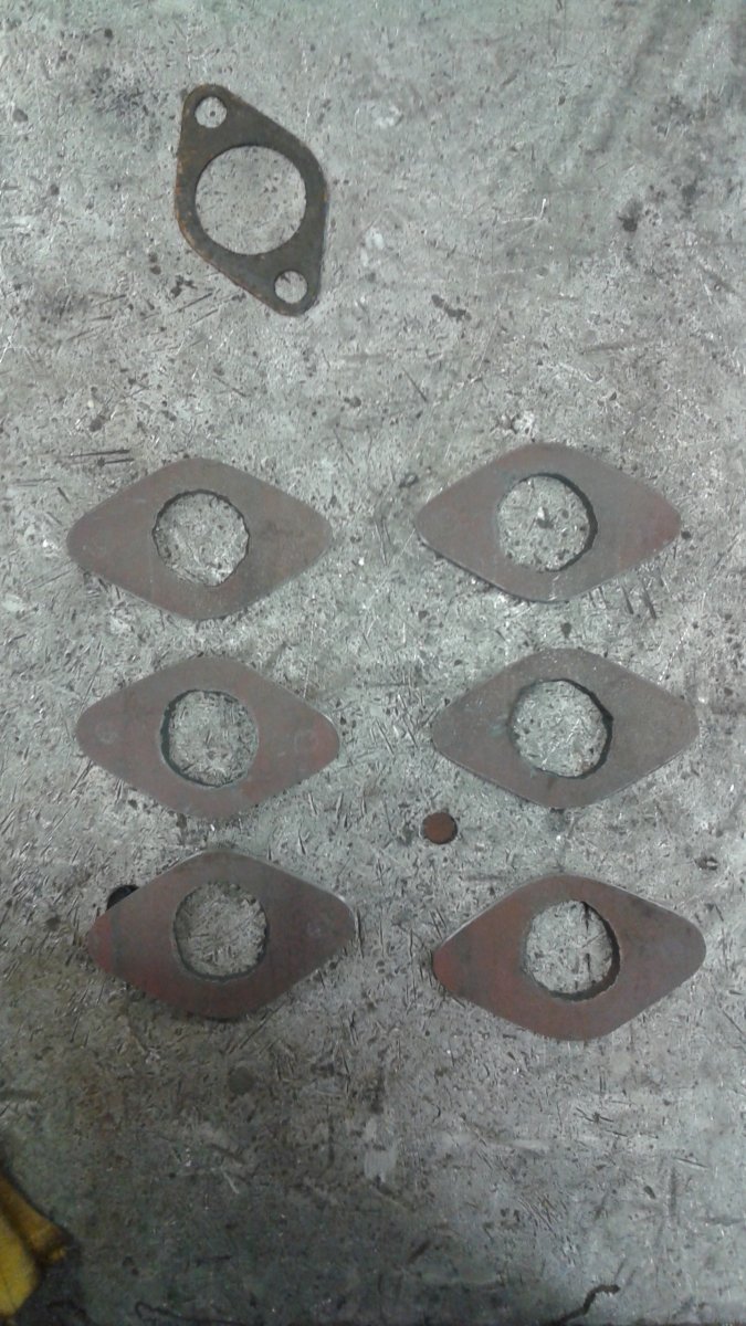

    20160217_201016.jpg So for my business degree I have to take an art cl***. They had a metal shaping cl*** that is 4 hrs a week. Since I already weld I burned through the course already and now just need to do a final project. So I decided to build some drive shaft headers it will be done all old school with a torch last week started my flanges. And I have a 36 zephyr drive line for the headers! Don't mind the ruff cut out holes they will get doled in

    I like it! Can you slightly alter the front of the top so the windshield sits more vertical? If the sun shins on it at that angle you are gonna be blind.

    You mean someone else will be blind lol. It's how that top was made so I am sticking with it lol. To old and fragile to modify

    I love the look. It is almost inspiring me. I think it was the Pearson coupe that they laid the windshield back until they couldn't see through it and then lifted it just enough to see through.

    Ok. I used to run around in my M37 with the window partially open at an angle. The sun shines on it and it can be super hard to see. I hope yours is different. Looks bad ***.

    Wow thanks guys. Now that the snow has broke I think I will be taking it for a cruise shortly! Dump rat I see what you mean. Hmm well that will **** I will let you know the day it happens since I am sure it will.
