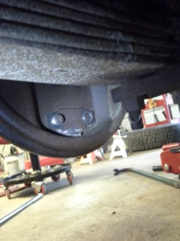

  29. 31Dodger
    Joined: Mar 24, 2011
    Posts: 5,189
    31Dodger
    Let's have a photo of your situation, please. Stand back about a foot from the side of the car and take a shot slightly forward from the rear of the drum.
