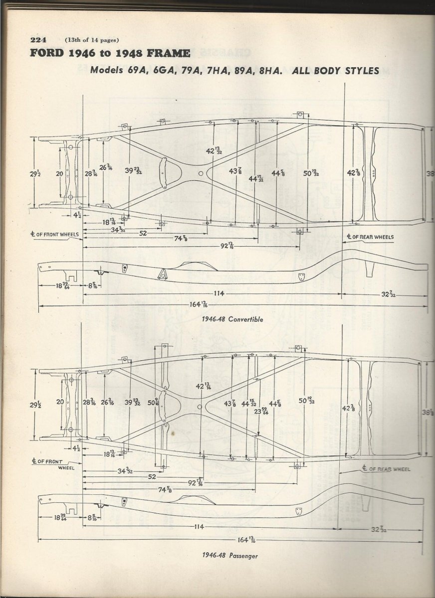

    Here's a diagram to show where your rear axle sits relative to frame. You need to work from there depending on wheelbase. What body do you have going on the frame? Personally I would wait until I had body and fenders on to ensure wheels are centred in front and rear fenders before I used the electric glue gun.:D

    thank you for the dimensions... that is exactly what I need... I was able to find such drawings for a variety of cars and trucks, but nothing for my frame... and it was doubtful what year frame I had to begin with... thanks again! As far as which body, i have a local "woodie" builder and this was one of his old throwaway frames. I design suspensions and ac***ulate all the frames I can. My typical platform is cl***ic ford trucks, but i have branched out with my new front suspension design to fit a wider variety of vehicles.
