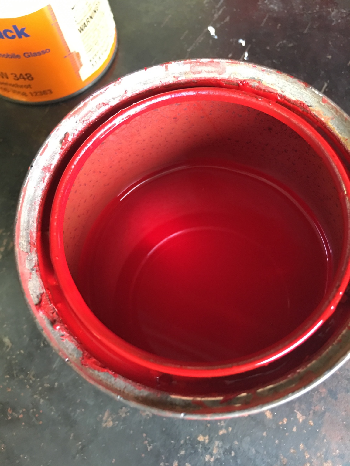

    I found about a can and a half of Glasurit paint that is about 38 years old. I opened up the can that is half full and it looks amazingly in good shape.
    I've been searching online and I can't seem to find any information on this paint. I'm trying to figure out if it's still good, if it's a single stage or not and how would I go about getting another can. Any help is highly appreciated. [​IMG][​IMG][​IMG]

    Lacquer is good as long as it is still liquid. It can be polished directly but several coats of clear give you some cushion against burn through.

    I seriously dought you'll be able to get another can, I'm sure Glasuret discontinued lacquer years ago. All lacquer was considered single stage, you could clear over it but didn't have to.

    It's still good as has been said. The sadness in all this is that you only have about 3 1/2 qts once reduced in 'ready to spray' mode (150% reduction). If you like the color and want it as a final finish you can base it with something close then finish with that. Then again that only leaves you 2 1/2 read to spray because you'll need to hold some back for touch up if ever needed. If you have good commercial supplier they can make that color for you but just imagining the price is frightening:eek:

    The color is iberischrot . The year 1971 VW paintcode is L31F. Probably $500 a gallon in today's base coat.
    You might be able to use it with a modern polyurethane clear coat. Spray it let it cure well, sand it with 600 grit and clearcoat it. MAYBE http://www.ratwell.com/technical/GlasuritPaint.html

    The word "nitro" on the label indicates to me that it is nitrocellulose lacquer which was dropped when acrylic lacquer was developed.
    Handle it just like acrylic. Probably a little more brittle than acrylic and may not retain "shine" quite as long as acrylic.
    It color sands and buffs easily. Thin with high quality slow lacquer thinner. Avoid spraying during humid conditions.
    Doesn't get any more traditional than that.

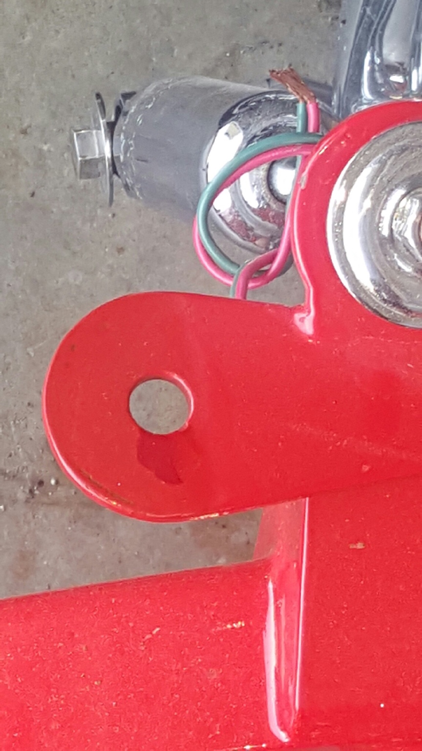

    Here the headlight mount area. The dark is from paint can, beside that is "ford red" engine enamel and outside of that is supposedly "ford red" auto paint

    I'm trying to figure out if this paint in this can is the same paint that's on my car. It's from the builder and it came with the car but a lot darker. I will have to bring in a front panel and the can to the local supplier. I almost have to miss work to go in there. They have bankers hours.

    Actually, I can't use it. I'd have to shoot my undercarriage also because it's darker.
