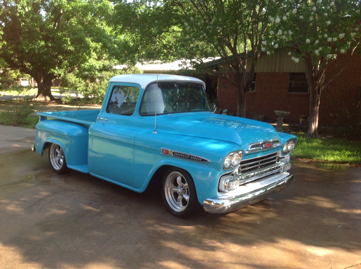

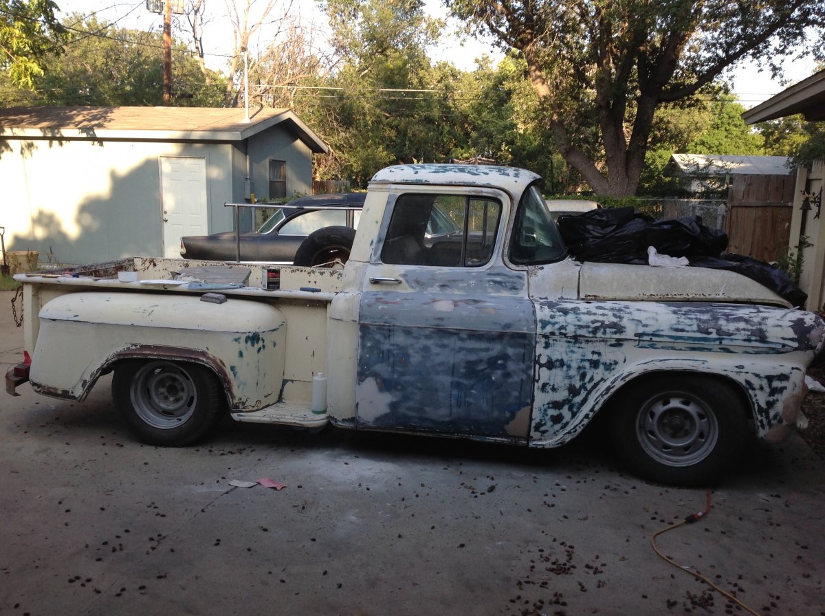

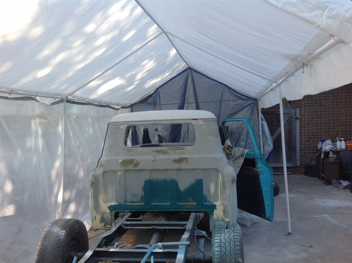

I have shot (in my driveway and in a homemade outdoor driveway paint booth (clear plastic and duct tape) single stage enamel and BC/clear coat, respectively. I have used a Harbor Freight gun a lot of times, and an Eastwood $90.00 (if I recall correctly) for the BC/CC. Paint was usually a NAPA kit of enamel. BC/CC was bought from a paint vendor at a swap meet. None of the paint ever disappointed me. F&J is correct in all respects as far as my experiences go. Good advice from the others as well. Pics are of the BC/CC/paint booth/90 dollar gun/cut and buff.
