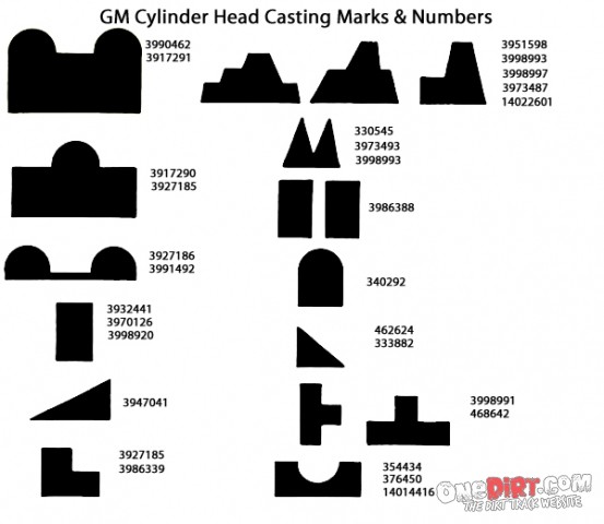

  3. double block 388 heads on a 010 block would make it a 72-76 350....
    <TABLE border=0 cellPadding=4 width="100%" bgColor=#000000><TBODY><TR><TD>[SIZE=-1]1968-71 [/SIZE]</TD><TD>[SIZE=-1]3986388 [/SIZE]</TD><TD>[SIZE=-1]307[/SIZE]</TD><TD>[SIZE=-1]1.72[/SIZE]</TD><TD>[SIZE=-1]1.5[/SIZE]</TD></TR><TR><TD>[SIZE=-1]1972-76 [/SIZE]</TD><TD>[SIZE=-1]3986388 [/SIZE]</TD><TD>[SIZE=-1]350[/SIZE]</TD><TD>[SIZE=-1]1.72[/SIZE]</TD><TD>[SIZE=-1]1.5[/SIZE]</TD></TR></TBODY></TABLE>

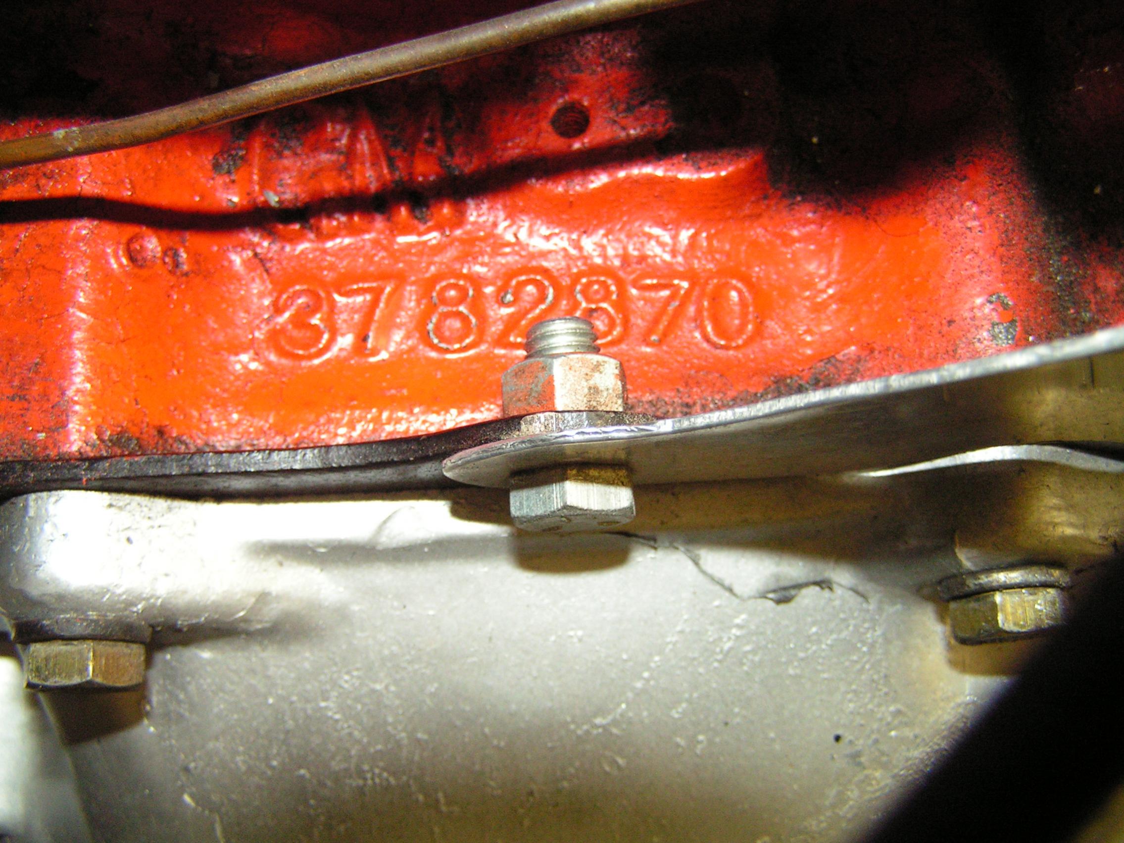

    The casting number 010, despite what you may have heard, or read, simply means the block was cast for, and finished at a 4" bore, NOTHING ELSE. Everything else you have heard or read is a myth. In other words, a 010 block can be anything that had a 4" bore. The number of bolts on the main bearing caps was chosen in the FINISHING process. A 4-bolt main block just has more holes drilled and tapped in it. No number cast into the block ever indicates how many main cap bolts the engine has.

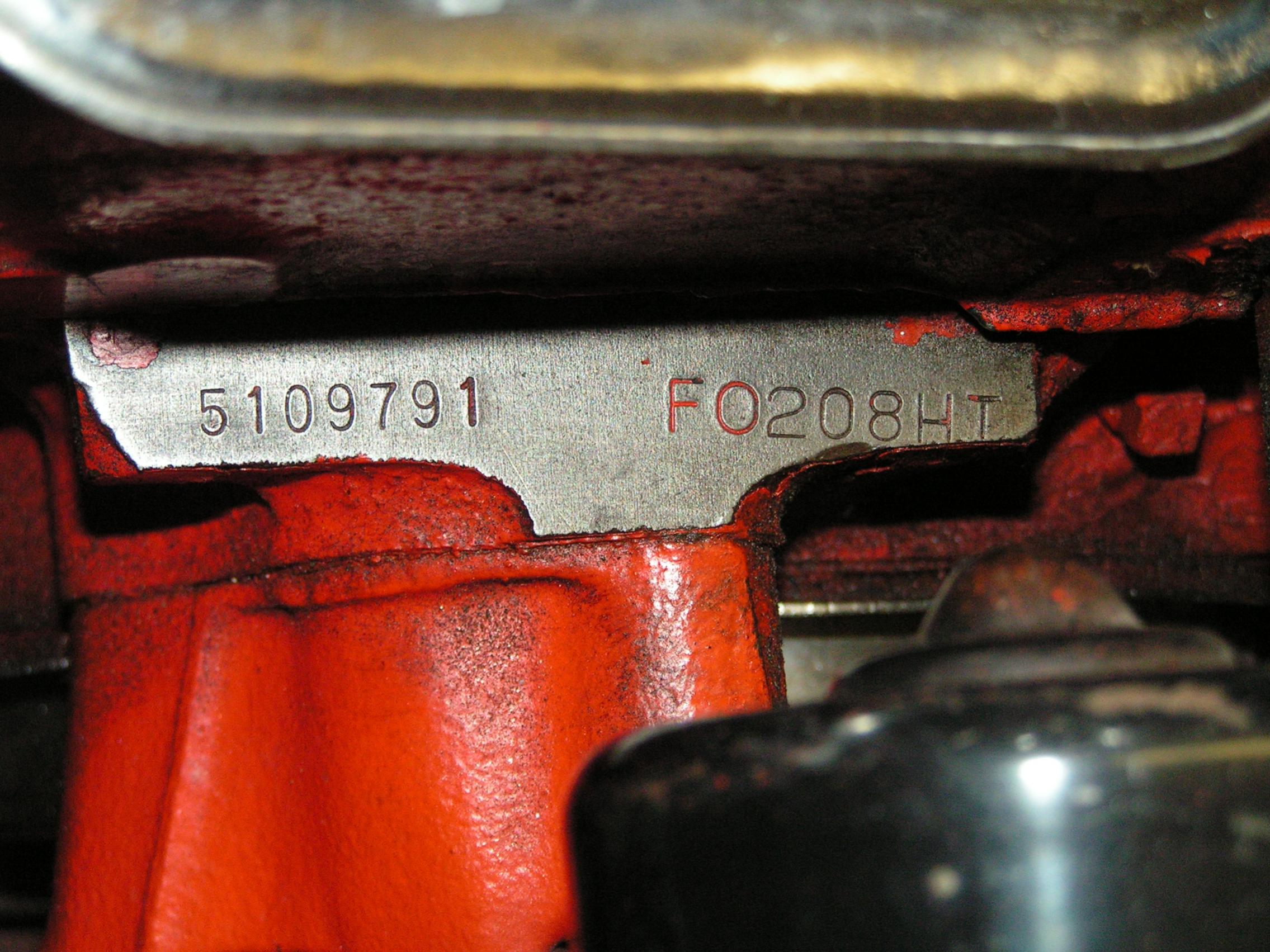

    the numbers and letters stamped into the front of the block tell were and what the block was for.corvettes had the last 5 or 6 numbers of the vin stamped their also .

    Some of the "it's a Vette motor" stories are true. You need to look at the stamped numbers on the pad. There is a date code cast in the block near the distributor.
    A real vette engine looks like this one found in a K-88 dragster.
