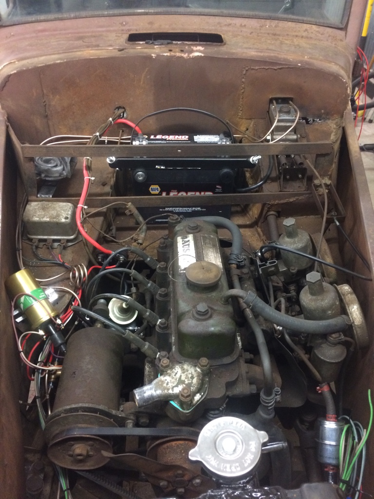

    As per usual I've been neglecting this build thread, and toiling in the shop...
    Today was the first real maiden voyage in over 40 years. A few miles up the road, took a tour around the back roads. Already turning heads!

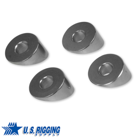

    Headlights are just mocked up for now, need finishing. Really wanted some small headlights and got lucky with this set off eBay.... 6" stainless buckets, supposed to be fog lights. But behind those glass lenses were regular 5 3/4" sealed beams, so converting to headlights will be a snap.
    Need to find some sort of wedge type washers to help with the Bantam's cross eyed look...
    Engine bay neatened up too...
  19. Can you cut a piece of tubing to make a spacer?

    Seems like the best option to me, have to scrounge around the shop. I did find an abundance of beveled/angled spacers in a place I wouldn't have thought of... Apparently they're pretty common for cable railing on decks.
