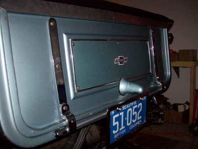

    ss34coupe
    Some pics of the modified tailgate and taillights now installed.

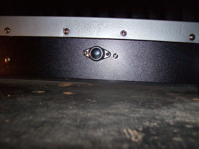

  5. ss34coupe
    Joined: May 13, 2007
    Posts: 4,270

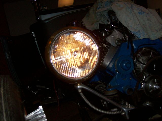

    ss34coupe
    Lights and switches all work. Starter ****on installed.

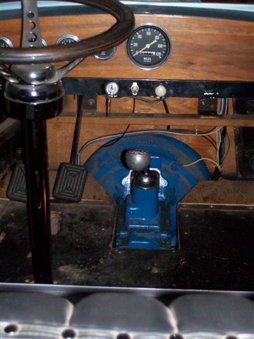

  6. ss34coupe
    Posts: 4,270
    ss34coupe
    View from inside the car. The 39 Ford trans is ready to start shifting gears. John will run the 6 volt system that the old rod was built with back in the day.

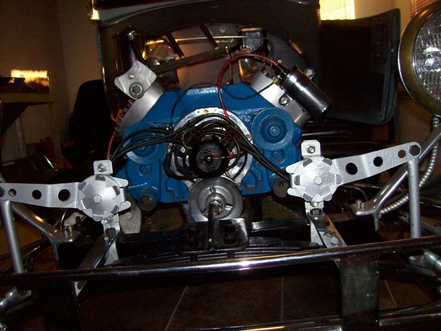

  20. ss34coupe
    Posts: 4,270
    ss34coupe
    Some more photos coming your way....here are the friction shocks mounted on the front end. John has been busy working away on the Chev-bucket.

  22. ss34coupe
    Posts: 4,270
    ss34coupe
    Distributor wired and coil installed. The second photo shows the oil valley, and you can see some of the port polishing that was done over 40 years ago when this flathead engine was built.

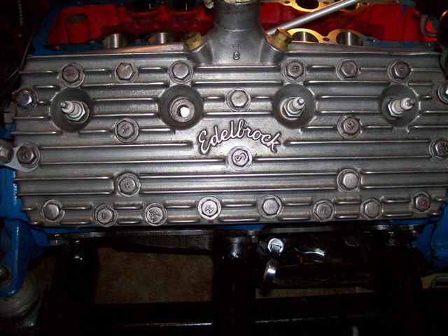

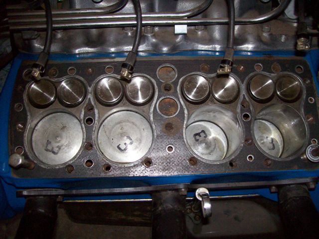

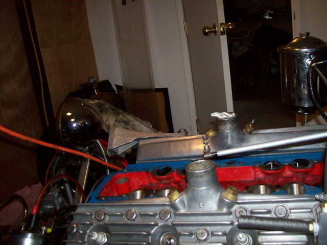

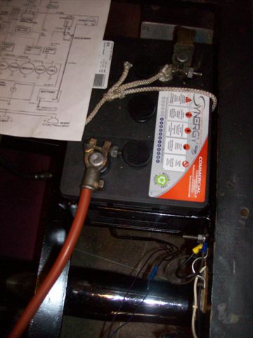

  23. ss34coupe
    Posts: 4,270
    ss34coupe
    John could use some help from you flathead experts out there. The engine in his rod, a 46 Ford motor, was completely rebuilt in the early 70's. It was installed in the old rod, but never fired. So John has been working hard this winter to finish off the little details of this build, and to get the car running.
    The problem is that the motor does not turn over when the plugs are installed. It does turn over without the plugs, but not well. There is a further problem of low compression on one of the cylinders, I believe it is number 6. There is oil pressure at cranking speed with the plugs out, and the motor is wired for a 6 volt system with a new, fully charged battery. The starter has been rebuilt, and John has tried a couple of starters to see if that was the problem. Any ideas that would help him out?

  25. When I was firing up my flathead on an engine stand, had lots of slow cranking issues,
    till I got some 1 gauge battery cables. Problem solved.
    Hope that helps

  27. ss34coupe
    Posts: 4,270
    ss34coupe
    Thanks for the tip. I'll check with John to see what he is using for battery cables.

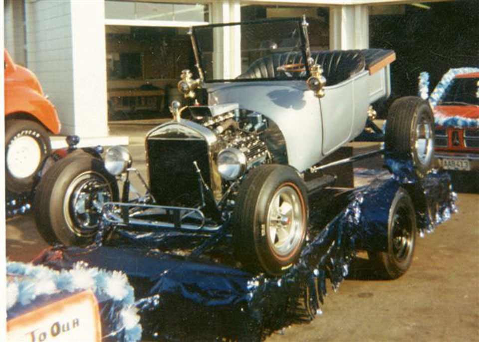

    man those pics with the redlines tires are SPOT ON... the owner taking that trophy looks like Steve McQueen!- regular bad ***!
    What a cool find... I'd put it right back to that late sixties red line version...
    so RAD.
