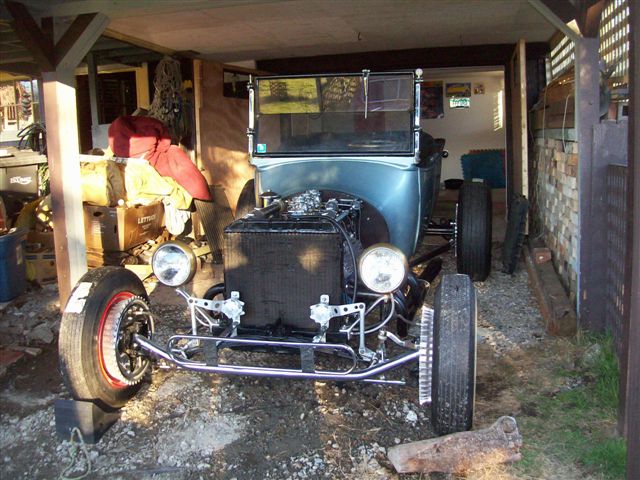

    It wont start and you wonder why it never was started??
    I think I would tear the engine down, checking everything until I found the problem. Forcing the engine to run with unknown problems is going to break something. 40 years is too long to sit without something seizing.
    The valve springs that have been compressed for 40 years will never return to full height. Tear down, inspect

    I think John has now solved the problem, but thanks for the advice. Here is another pic of John's 39 tudor alongside his buddy Murray's 38 Ford coupe.

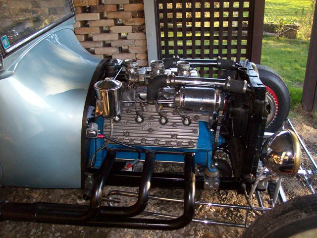

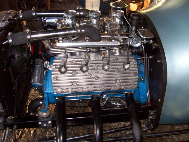

    Here is that beautiful flathead motor that is shown running in the video posted yesterday. John has done a great job of getting this motor to run so well after it sat dormant for decades. Next step is to finish off the rest of the details on this old rod to get it out on the street.

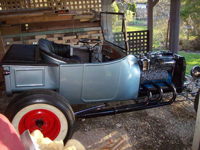

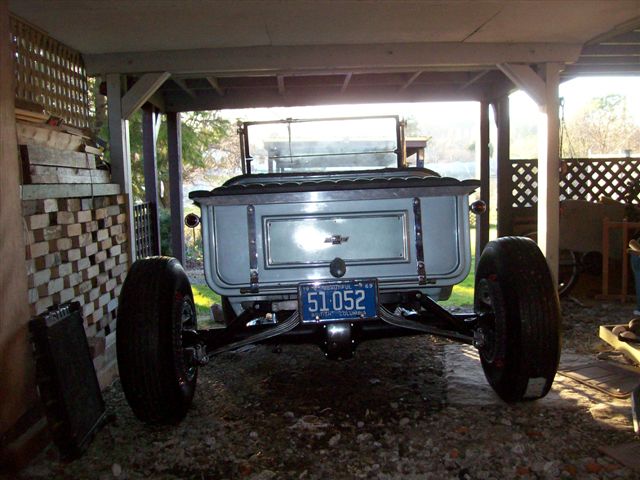

    Another pic, this one from the rear. Now that the flathead motor is running, it will not be long before the Chev bucket can head out on the road. The pic showing the side of the rod was taken just before John fired the motor for the first time - amazing that this flathead had been ***embled in the early 70's but never fired until now.

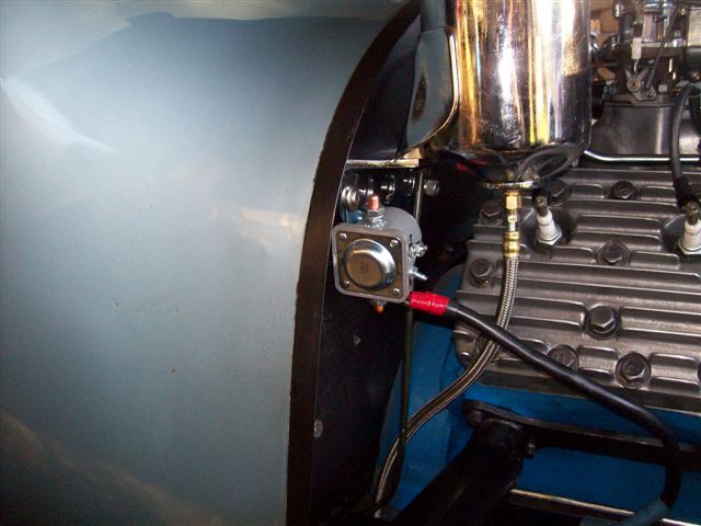

    As we said at the beginning of the thread, when John got this old rod it came with a lot of parts that had not been installed, including friction shocks for the front. The pic shows John did a nice job of fabricating brackets to mount these shocks - they now look like they belong there! He also installed a new fuel pump and a 12 volt solenoid - to make it easier to jump start the motor that retains a 6 volt system. It has all worked out and John has this old flathead running smoothly.

    So I asked John to send me a list of the things he had to do to get the engine running. All of this involved a lot of tinkering over a few months - if you look at the video of the start up of the engine, it looks like it was easy! Anything but, to get to that stage took a lot of effort on John's part.
    He pre-oiled the engine to make sure there was oil pressure at cranking speed. Wired the distributor and coil and adjusted the timing. Removed the heads and oiled the cylinder walls and lifters. The number 6 cylinder had low compression so John squirted penetrating oil down it and cranked the engine over to free up the rings. He then installed new gaskets and torqued the heads down to specs. Added gas and water. Installed a 12 volt start relay so he could jump it with a 12 volt battery using a remote starting switch. This way only the starter got the 12 volts, and the car still runs on 6 volts. The reason for this was the engine would not turn over fast enough on 6 volts to fire. That problem should disappear as the engine gets broken in.
    There is still a problem with a leaky radiator, and the transmission gets stuck in gear. Also a serious oil leak between the trans and torque tube - so there is still a lot of tinkering to do to get the car on the road. But I guess this is what you would expect when the old hot rod has been sitting around for over 40 years. As John says, "there is still lots to do!!".
