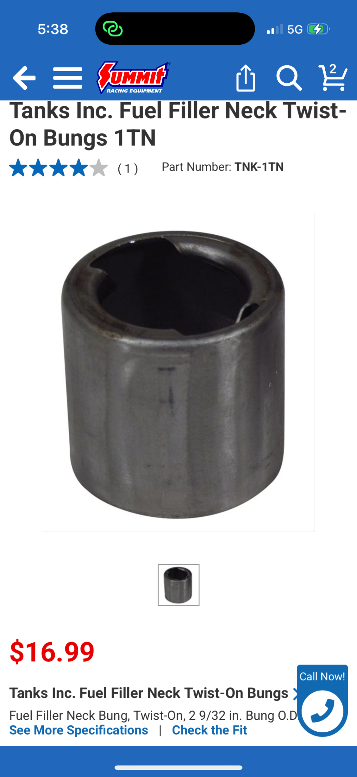

    What material is the filler neck made out of? If its weld'able, Tanks, and im sure some other companies make new end pieces to use a twist cap with of varying sizes. This is the one Im using one for my '37 Buick that the stock cap fits

  17. GordonC
    Joined: Mar 6, 2006
    Posts: 3,447
    GordonC
    At one point I was thinking of taking something like this and either mounting it on my A so I could put the newer stock style cap inside it or use it to replace the stock cap. Might just be easier to attach it to the new cap as mentioned here earlier.
